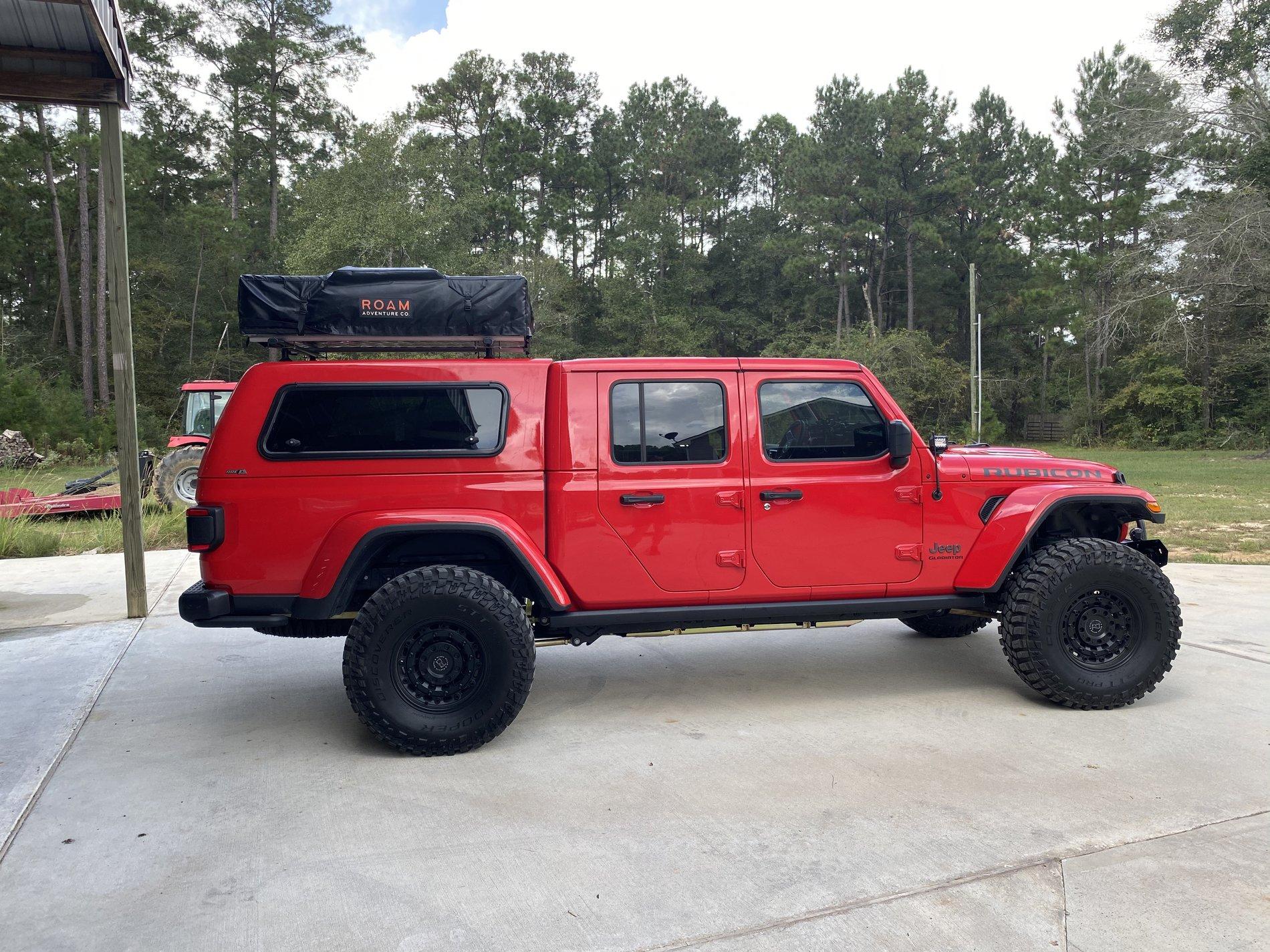

Here’s a JT we did with them or similar. Seem nice enough
brett
Jeep Wrangler JL Black Rhino Armory Wheels F96EC414-5B71-4F80-A008-BA95D49D911F
brett
Any issues since you‘ve had them with rust or chipping etc? Saw some folks leaving negative reviews on the ARmory but I sure do like the look.
I actually think those in the picture are the Arsenal.
