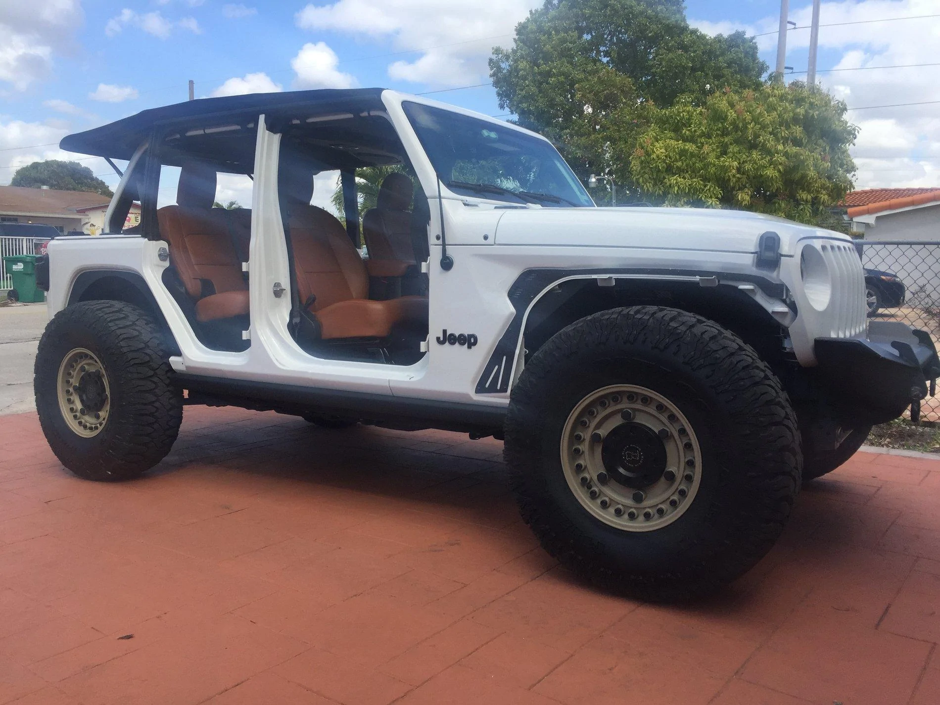

K.O.M
KING OFTHE MALL
Jun 3, 2019
128
176
MIAMI
K.O.M
38s
NO LIFT.
Jeep Wrangler JL biggest tires without lift FB8D1012-E9B9-47A2-AB53-28F8D2F8697A
