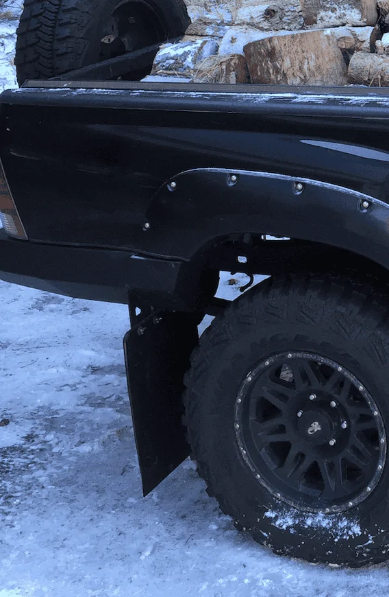

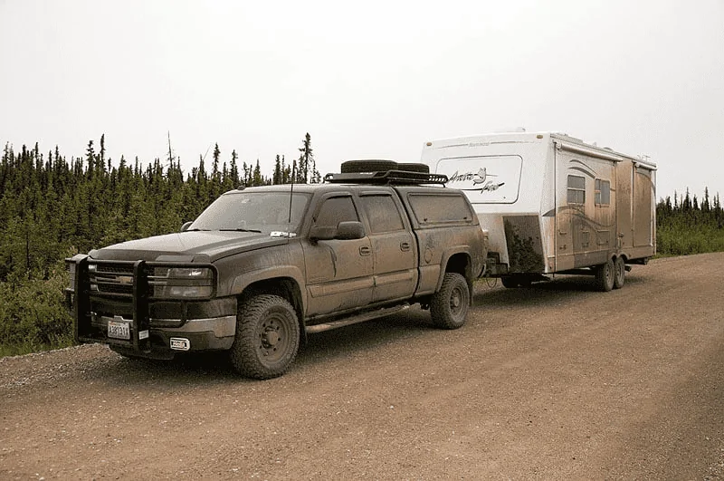

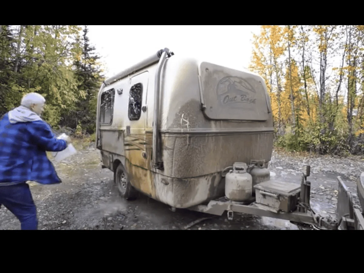

I am thinking of making some for my JLUR for when we go to Alaska. We tow a camper and I am looking to not destroy the camper from mud and rocks being kicked up on to the camper.

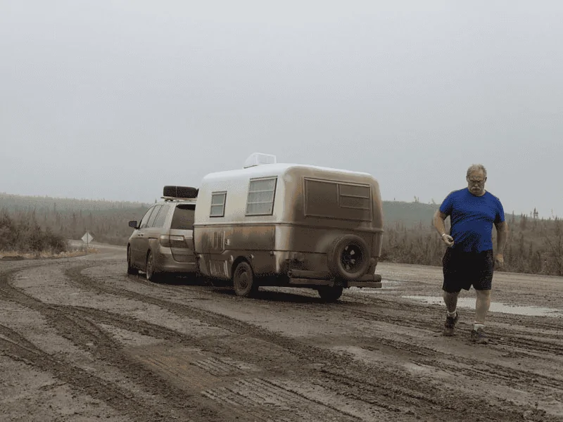

Pics of camper that are towed in Alaska. I suspect that I will do a couple thousand miles of dirt roads.
Jeep Wrangler JL Big mud flaps on a JLUR. 1703335989937
Jeep Wrangler JL Big mud flaps on a JLUR. 1703336015559
Jeep Wrangler JL Big mud flaps on a JLUR. 1703336053558
Note, the above vehicles all have their tires inside of the fenders. Mine are not like that. I have a -3.5 off set wheel and get a lot of tire poke.
Jeep Wrangler JL Big mud flaps on a JLUR. 1703336384989
I have metal inner fender liners. I am thinking about buying bulk mud flap type material and rivet nuting
Jeep Wrangler JL Big mud flaps on a JLUR. 1703338327028
the mud flaps to the Jeep inner fender liner creating a mud flap that I can easily put on and take off. I would only be using them at slower speeds on the long dirt road sections in Alaska and Canada. I am thinking that the mud flap would go from the top of the middle of the fender to a couple inches off the ground. So with 37s on it will be a long mud flap.
For a reference, there is 414 miles of dirt road to Dead Horse Alaska. For a total of 828 miles plus to include any off shoots and so on.
Then, (94 miles) up to Tuktoyaktuk (Tuk for short), connecting the rest of Canada to the Arctic Ocean. So another 200 or so miles up and back to Tuk in Canada. Making for 2000+ miles of dirt road travel.
Any advice or insight to my plan? I can also if needed drill into the stock plastic fenders as I have two sets of stock Rubicon fenders at home that I can put on when I get home.

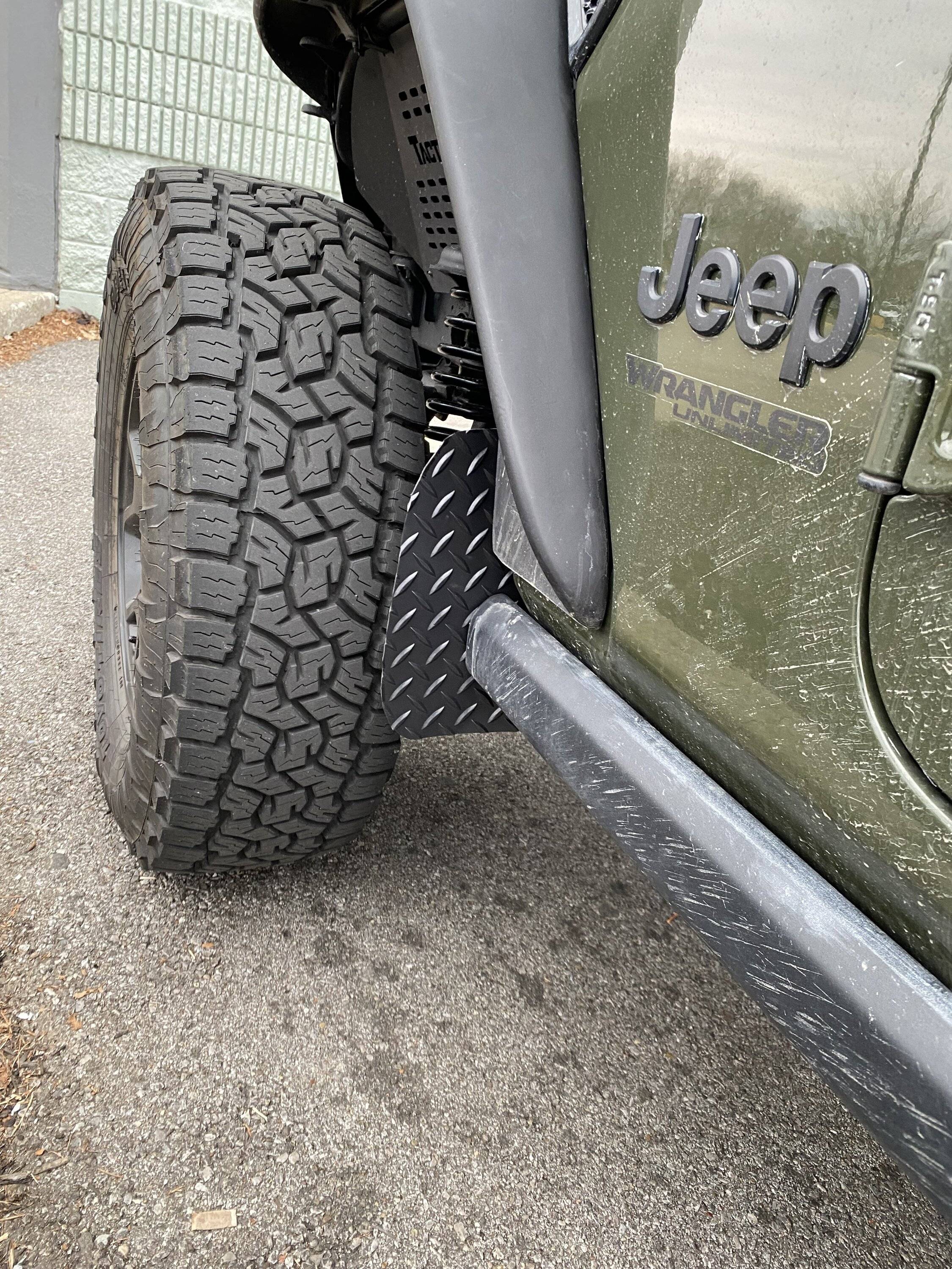

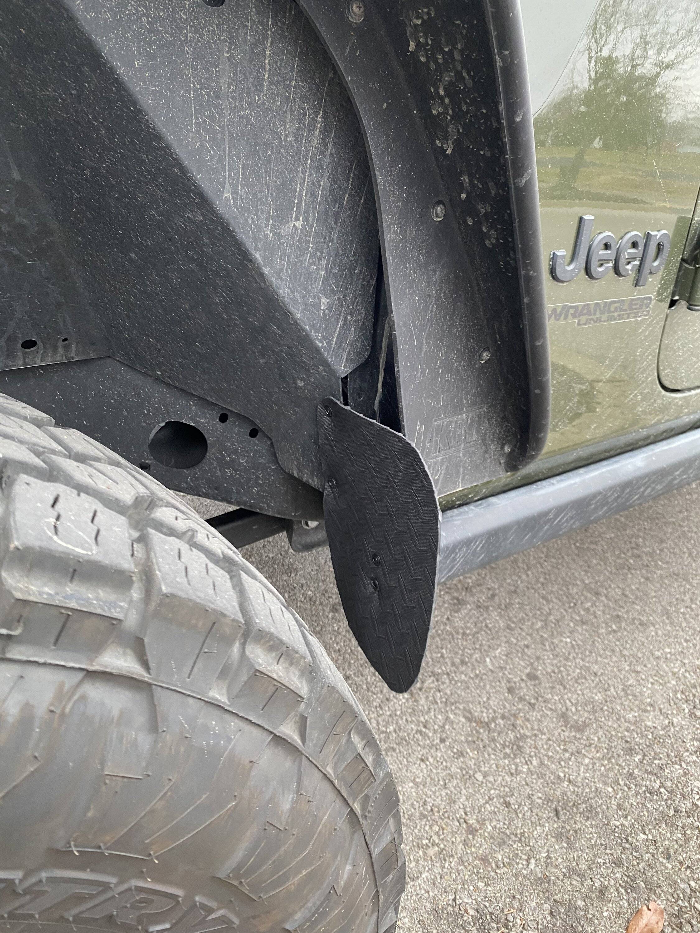

This is what I did. I can quickly remove when I’m not going off-road/gravel road. Obviously you would need them bigger but if you bought thicker( 1/4” maybe) they would be rigid enough to hold their shape. These are 1/8 thick. Off Amazon. Not as pretty and polished as most would like I guess but my Jeep is more of a tool then anything else.

We have the stock wheels and 35's still without after market flaps and are surprised at how much abuse our trailer has taken from rocks and mud/dirt off road.

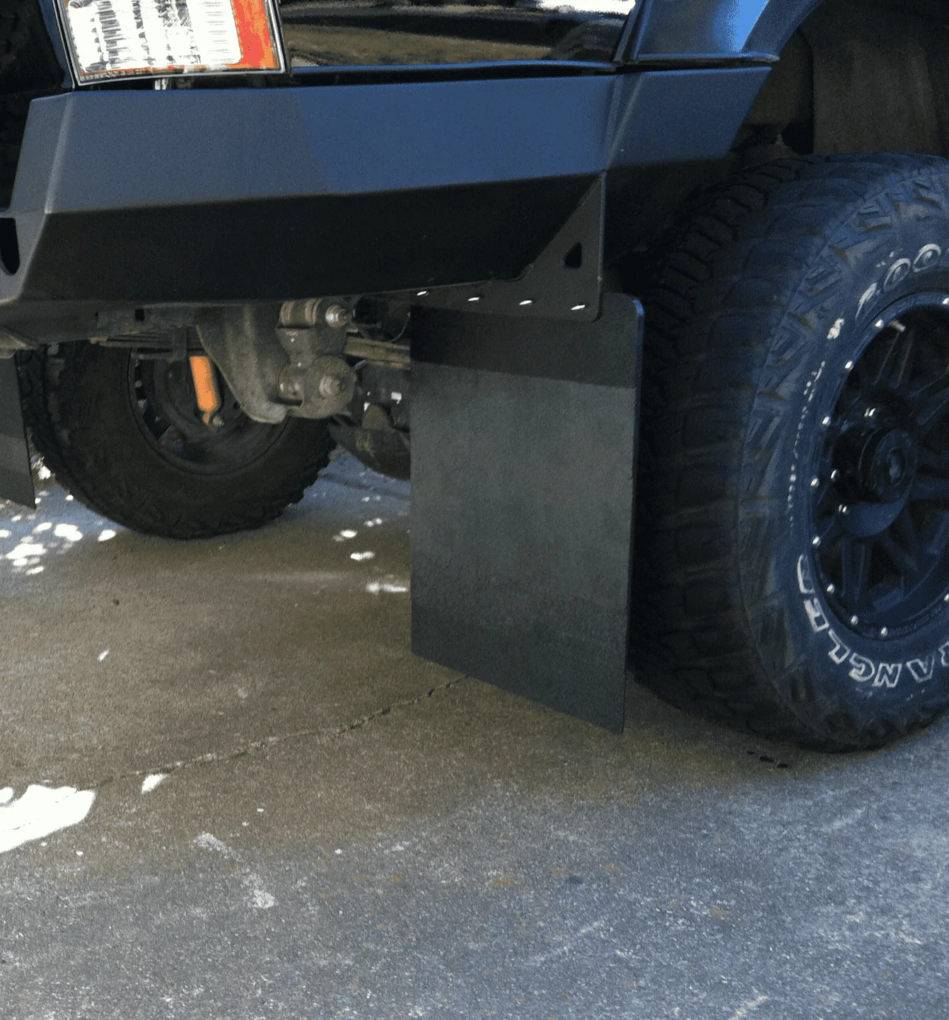

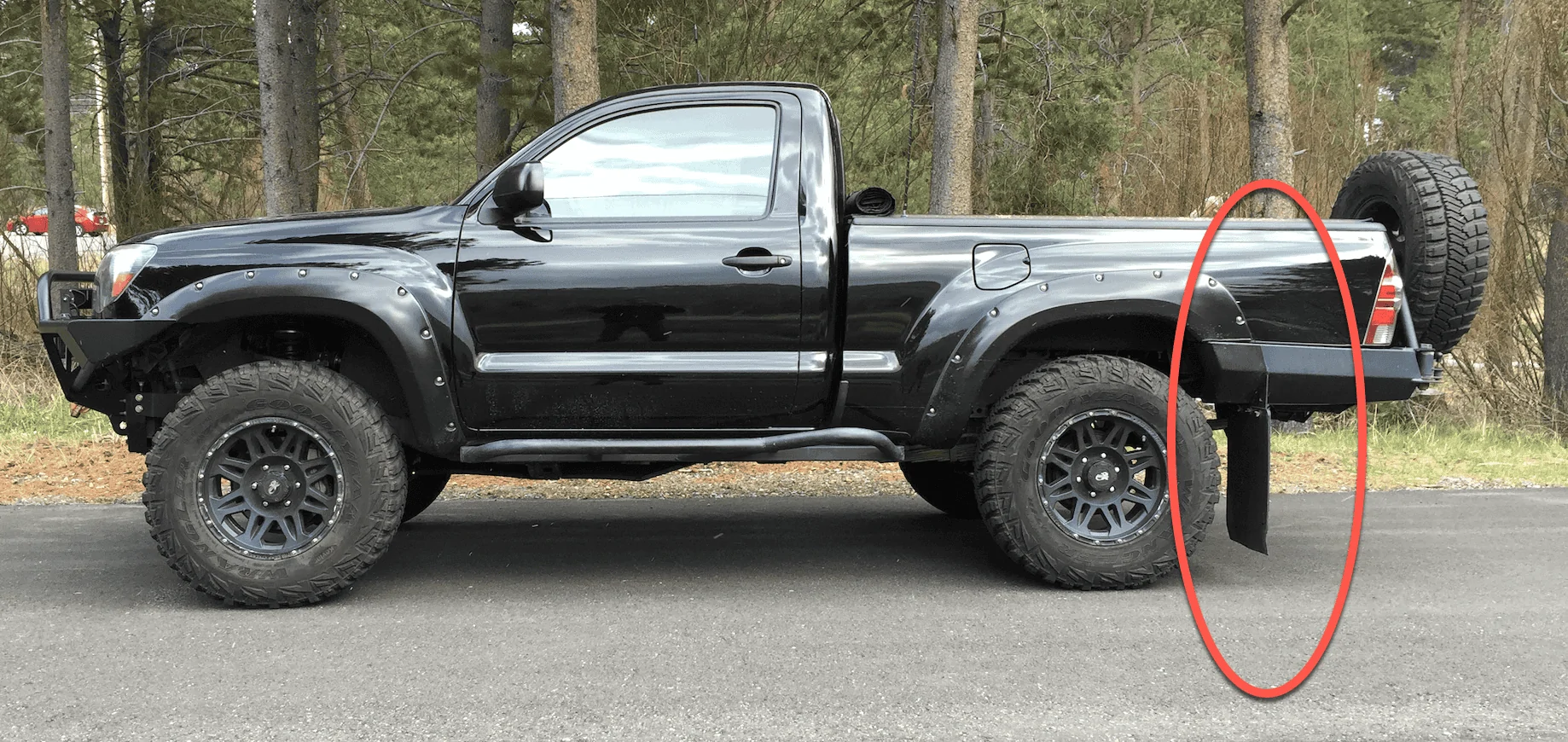

EDIT - On my Tacoma, I built some oversized flaps by laminating up some layers of ABS plastic from TAP Plastics. They were three layers thick at the top for stiffness, Two layers thick in the middle, and a single layer thick at the bottom for flexibility.

Ah, here's the photo of when I first made them. The original version was probably five plies of 1/16" Then a few years later when I made a new version, I simplified to three plies of 3/32"
Jeep Wrangler JL Big mud flaps on a JLUR. 1703346780965
But you can see - they're stiff enough to be held in place with only about a 3/4" overlap of the mounting surface. Ordinary "mud flap" material can be flexible enough that it blows up out of the way, rendering it mostly useless, at higher speeds.
