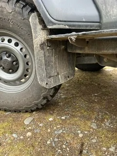

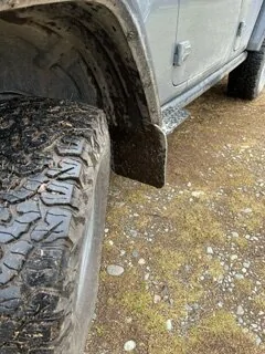

Here is what I'm running on the front. I'll have a similar setup on the rear when I'm done with the bumper fabrication.
These are standard semi-truck mud flaps, cut down to size - 3/8" thick. They are drilled through and bolted to a mini step I have bolted to the stock rock rails. The steps were actually built for the mud flaps - low and wide enough to keep them from blowing in the breeze too much - I wish I had used riv-nuts. Next time.
The steps turned out great as "steps" - I can stand on them to wash the windshield, tie my boats onto the roof racks, etc. Plus a handy spot to sit and tie my shoe.
The top of the mud flaps are slid up between the inner fender and the new step - this keeps mud and debris from running down the back, gives them plenty of support, yet they still fully flex with no damage if I were to hit a rock, log, critter, etc. I've never been a fan of the rigid aftermarket flaps for that reason - if you whack 'em, you wreck 'em.
They've been on for a couple months and working great. Looks like I'll be able to cut back on my Jeep washing from seasonally to annually.
