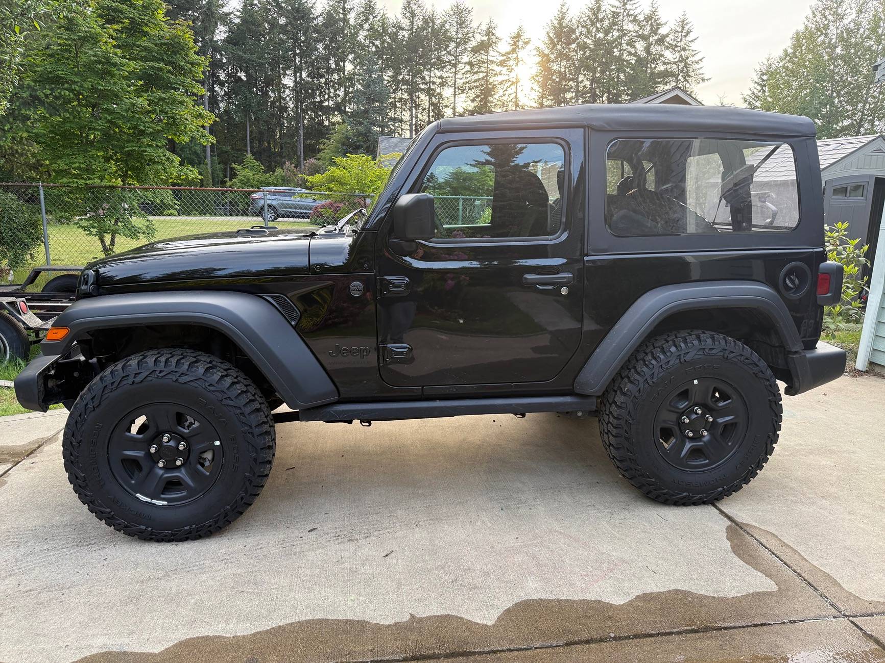

My E rated MT BB ATs are 64lbs 34.6” tall. They’re light and super quiet I run them at 29psi! They’re on my stock sport steel wheels. And it’s a manual and I haven’t had any issues with traction in rain. 2 days after I got them we had an atmospheric river and I was worried about traction but they gripped like the stock nexen HT tires
