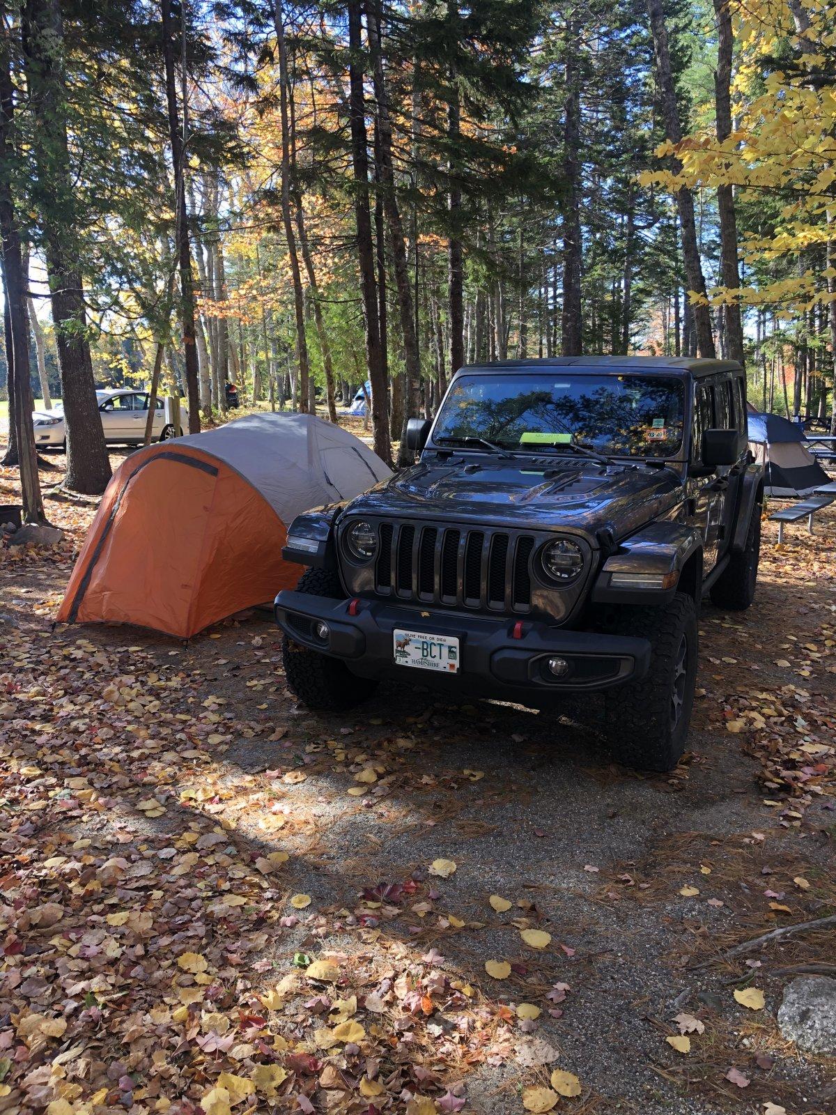

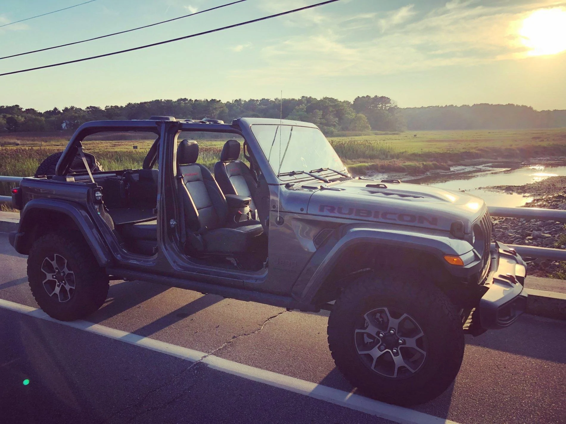

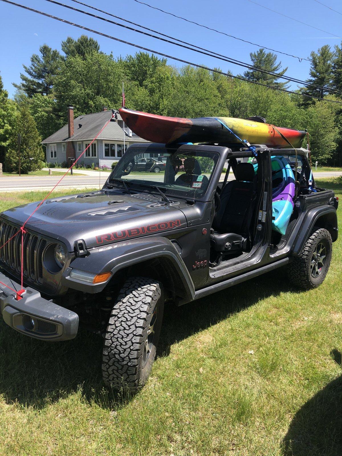

Hey All,
First post here. I am the proud owner of a 2018JLUR that I bought new in July 2018. Since then I have left the vehicle almost completely stock from factory.
Budget and overall life has allowed me to begin planning some modifications but this is my first Jeep, and I want to do things right.
I’m thinking about a “Stage One” style upgrade in my mind. That would be a mopar lift with the fox shocks, aftermarket rims (I’m addicted to the method 105 beads but nervous on maintenance) and hopefully running some cooper 37s.
Main question is I am reading a ton but still don’t quite understand different tire load ratings / widths and options. I want to make sure everything I purchase will be compatible. Is there anyone with a similar build that could share their thoughts and the specific tire / rim measurements they went with? Also lift kit recommendations.....I’m thinking mopar because I will honestly not wheel it very hard 99% of the time but am open to other recommendations from people.
Thanks for reading and all of your help in advance.

Realized probably want some additional context. I’ve put about 50k miles on the Jeep in stock form. Mostly commuting, but some light trail use / camping too. Wanting to change that and get some real trail use. Before COVID I worked from home 50% of the time but my commute is about 45 miles each way. I expect to return to commuting roughly 200 miles a week next year.
Looking for a DD set up that gives me all the stuff needed to take on more terrain in 2021. Thanks!

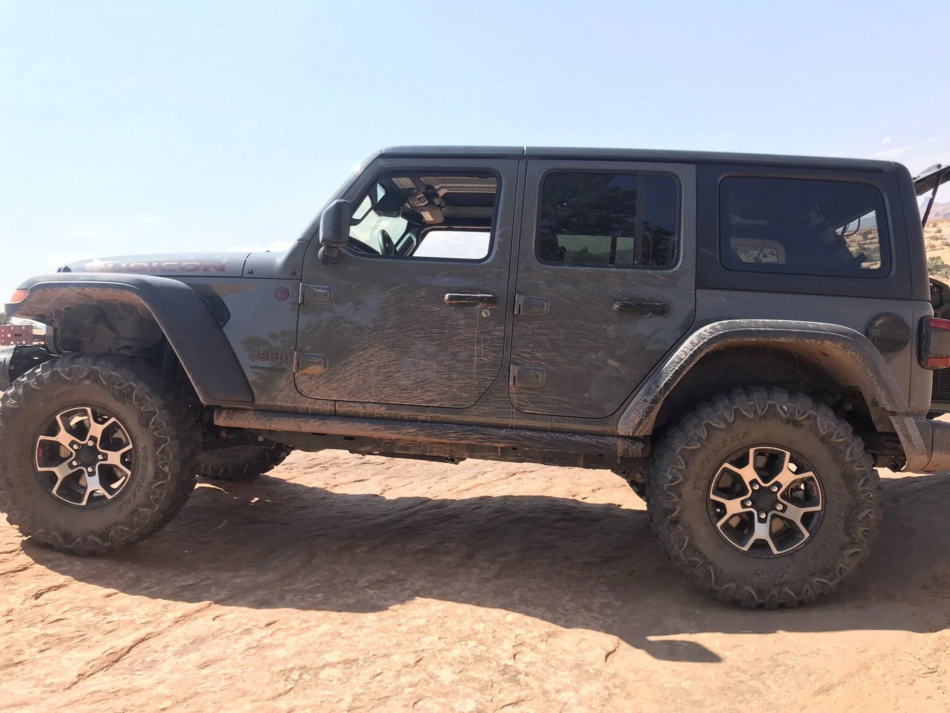

2.5” budget spacer lift and 37x12.50 on stock rims, had some rubbing on the sway bar and inner fender liner so have since added a set of 1.5” wheel spacers. You don’t need to re-gear if you have an automatic in my opinion. Our 4.7-1 first gear is more than sufficient with 4.10 axle gears. It will still chirp the tires under hard acceleration and had no problem with the cruise control set at 85 mph through the hills coming home from Moab. The Mopar lift comes with longer lower control arms in order to fix caster, they don’t need to be adjustable. The axle may be slightly off center without an adjustable track bar, but it isn’t noticeable to the naked eye even if you’re looking for it. Relocating the steering stabilizer and adding an engine skid are far more important in my opinion. We smashed the stabilizer and put a dent right next to the drain plug in the oil pan on Holcomb creek even on 37’s and 2.5” of lift.
