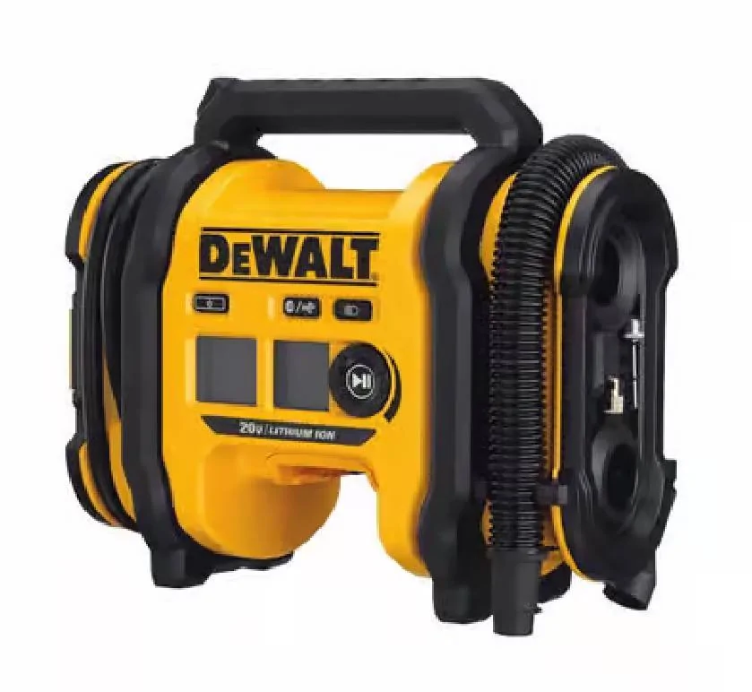

Thanks. What kind of basic air compressor is recommended here for this function?
I used a DEWALT electric air pump on mine yesterday, worked great, so basically a bicycle hand pump would probably work.
