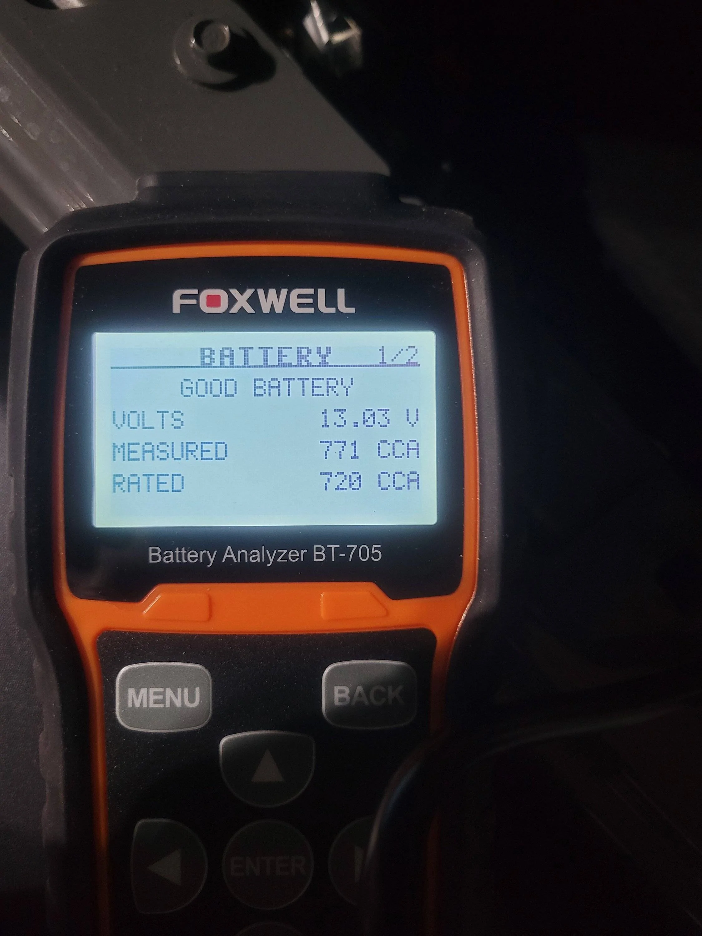

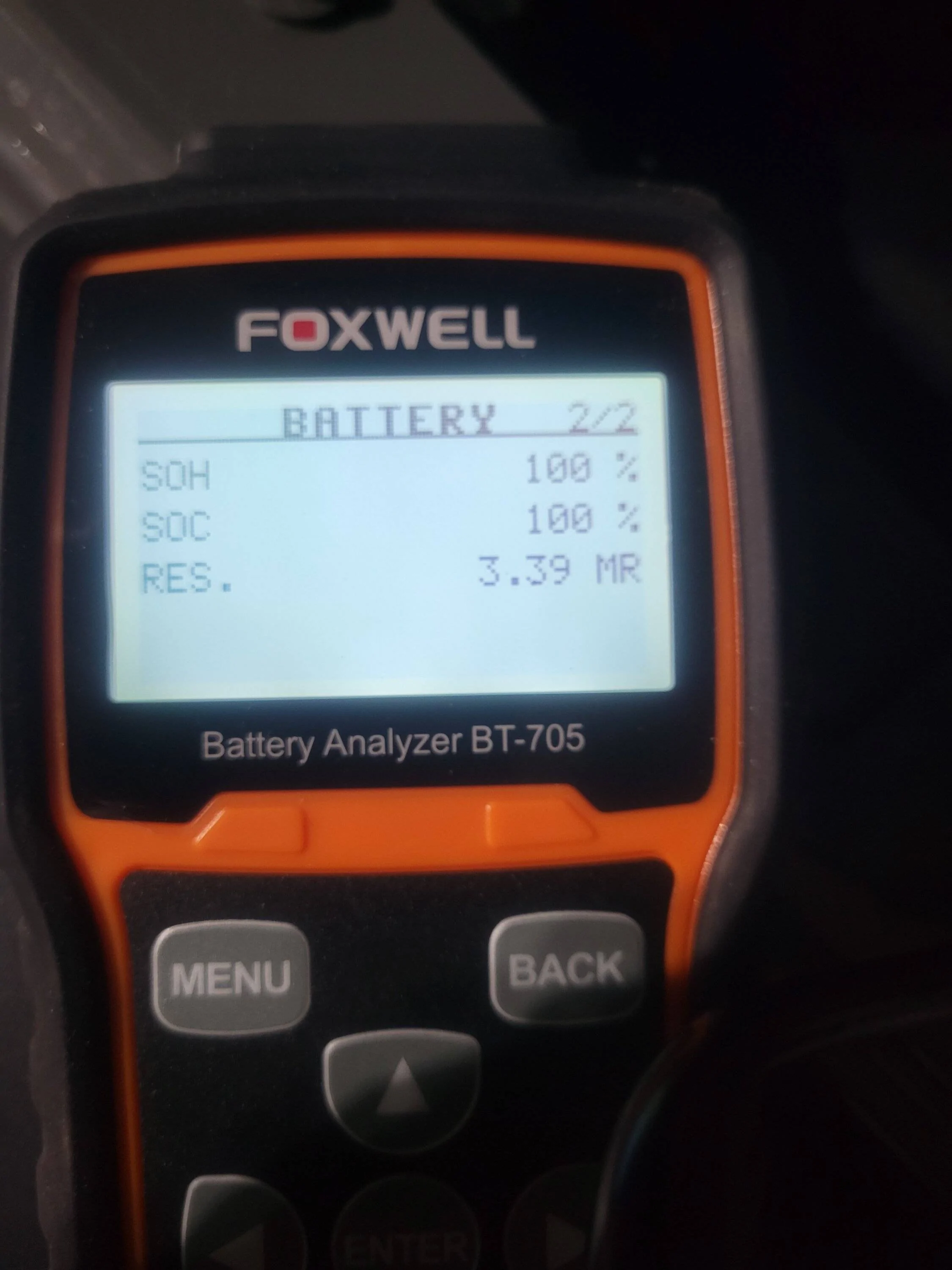

I decided to charge up battery tonight, so that I could retest it with my Foxwell battery tester. The battery tested out as:
Jeep Wrangler JL Battery issues and How to test 48V eTorque Battery? 20230328_183712
Jeep Wrangler JL Battery issues and How to test 48V eTorque Battery? 20230328_183727
So my 2 year old Duralast Platinum battery is not the problem, but if I hadn't kept up my weekly charging efforts, it most certainly would be dead now.

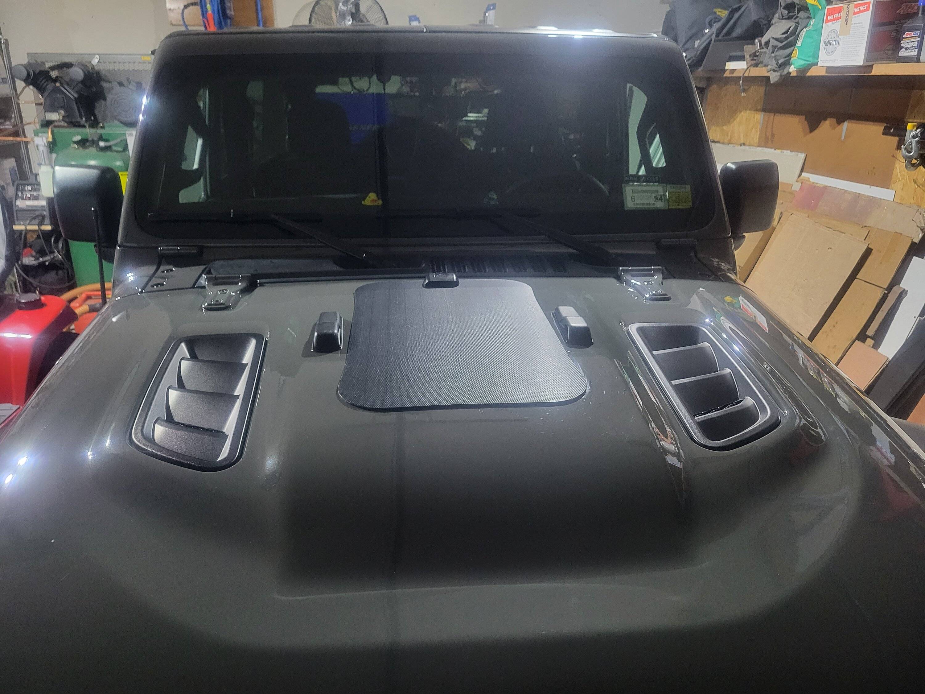

I installed an aftermarket solar panel to my Jeep and it has helped (See attached picture). Normally I would start out the week with full charge of 12.8V + and usually by the following Saturday the Jeeps battery voltage would be down to 12.2 to 12.3V. Now with the solar panel system installed the battery voltage measured 12.5V this last Saturday.
I need to spend some more time to see if I can track down where this parasitic draw is coming from. I've already ruled out the accessories that I've added as the cause by measuring for current flow when the Jeep was off. Besides, I was having this battery draining issue before any of these accessories were added.
