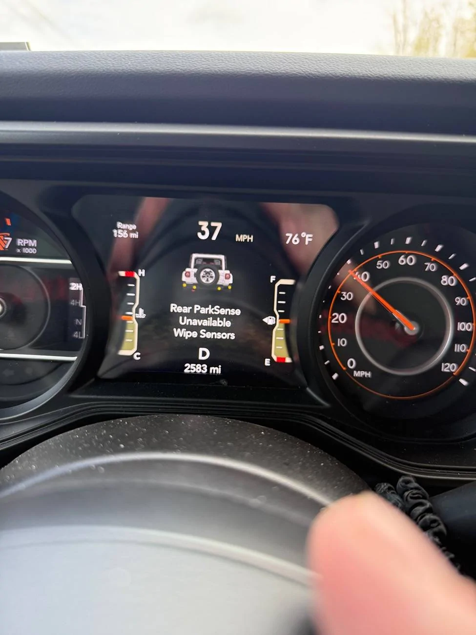

Bad park sensor

I have had the same thing recently 2024 Rubicon.
Seems to be when the sensors are wet in the morning from dew
Anyone else notice the same thing?

Yes, happens all the time. I don't trust them at all

Not sure if it's a coincidence or not, but I moved the position of the spare so the TPMS isn't bottom center anymore and it stopped happening for me. I read that the sensors may interfere.

Not sure if it's a coincidence or not, but I moved my the position of the spare so the TPMS isn't bottom center anymore and it stopped happening for me. I read that the sensors may interfere.
I just rotated the spare tire to put the stem up. Either I'm getting old, or those 35" tires are getting heavier. lol

I also noticed it more when having a trailer hitch installed.
Guess I should be lazy and remove the receiver when not using it.

Disabled.
Why would you need that older less reliable parking sensor when you have a rear facing camera anyway?
