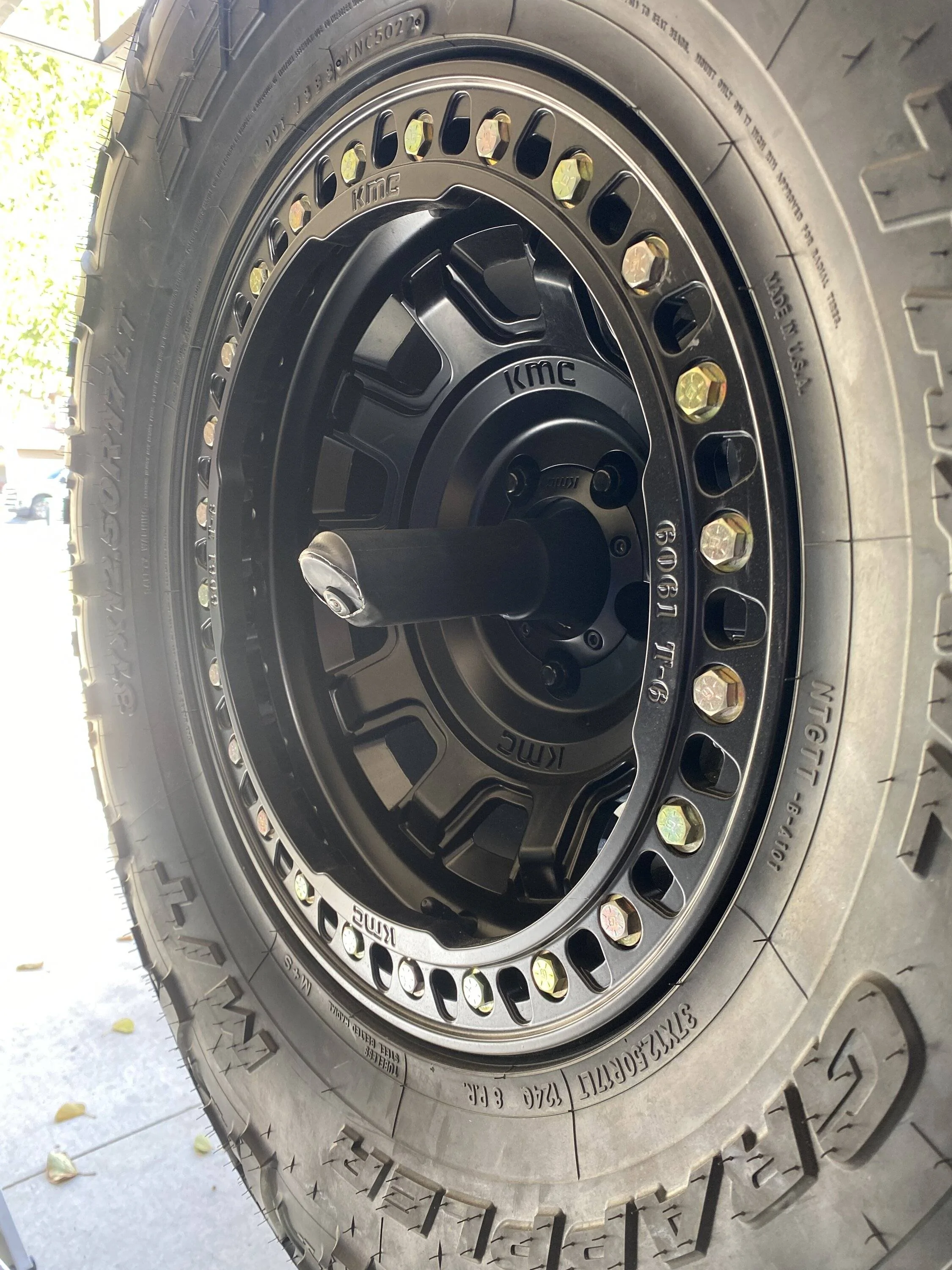

I removed the camera from the original housing, there is enough length in the cable when you reroute it more directly, you can 3D print an end cap to hold the camera, the main part of the extension is a piece of 1 1/4” diameter aluminum tubing sliced length wise so it slides onto the original body that the spare tire slides onto, secured with screws,and then I used heavy duty shrink wrap over the whole thing, and cut around the camera lens. Works awesome, even when sliding the spare tire on and off!
