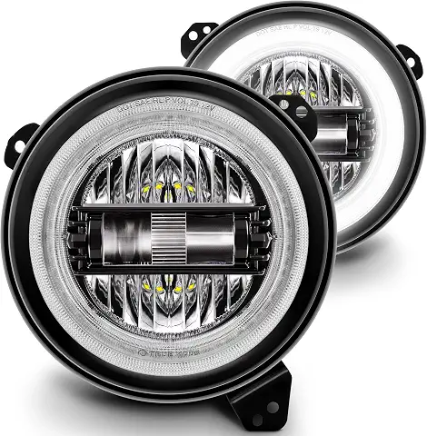

The only way to go for JL Wranglers. TrueMods full LED, plug & play, $230 on Amazon. The halo can easily be wired as a DRL. Excellent cutoff on the lo-beams. The first time you drive at night, you'll be shocked. I rate them equal or better than the $1500 factory Mopars. DO NOT WASTE YOUR TIME USING LED BULBS IN STOCK HEADLIGHT HOUSINGS! The pattern will be disappointing...

The only way to go for JL Wranglers. TrueMods full LED, plug & play, $230 on Amazon. The halo can easily be wired as a DRL. Excellent cutoff on the lo-beams. The first time you drive at night, you'll be shocked. I rate them equal or better than the $1500 factory Mopars...
Yeah, those look nice.

Their Achilles's Heel is their non-adjustability.
The aim of the stock headlight housings can be moved up and down quickly and easily with a 6mm hex key (Allen wrench.) Doing the same for the TrueMods requires removing the grill, et cetera. That's a real commitment for the owner who cares enough to fix things when oncoming drivers recurringly flash him for his lights being aimed incorrectly. It's a double commitment for the owner who'd need to repeatedly fix his aim because of carrying heavy occasional loads.
I had considered the TrueMod lights myself, but for the avoidable absence of a simple adjustment mechanism.
