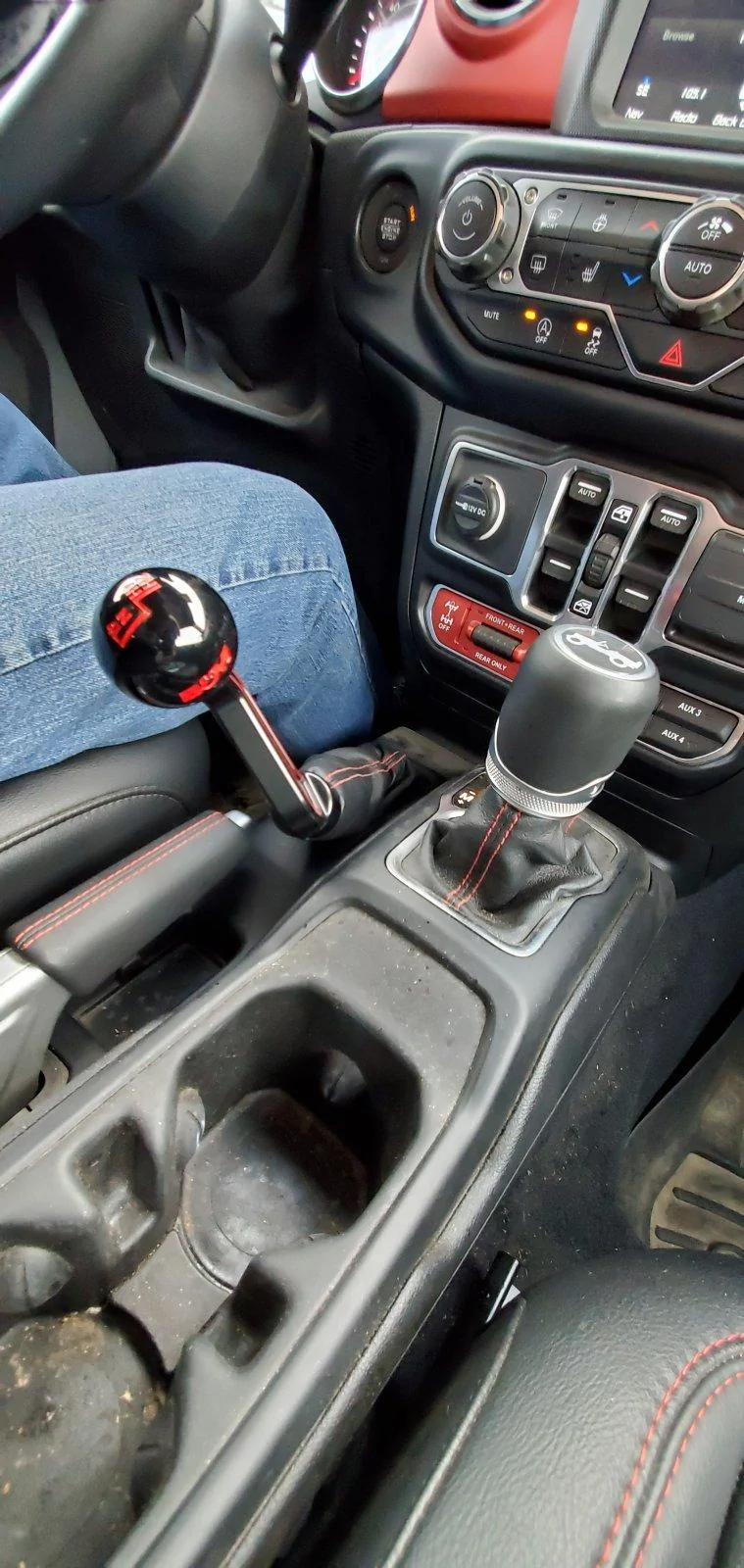

Its designed to offset towards the driver. The 2 set screws shown line up with existing holes in the factory stalk below the knob. It could, theoretically be clocked wherever you wanted, but the set screws wouldn't have quite the holding power and the knob would probably interfere with other parts of the console, especially when in 4lo.
Here's a pic taken while I was in my regular driving position with foot padding the throttle. For further reference, I'm 5'11" and of proportionate build. Don't hesitate to ask, if more pics are wanted.

VERY helpful, thanks! So It appears that I could drill and tap new holes to move this pretty much however I want as long as they line up with the factory holes. That is easier than fabbing up a whole new shift rod. I am 6'5" and my leg sits on the sifter all of the time in 2wd, I THINK if i could off set it an inch or two I would be all set....

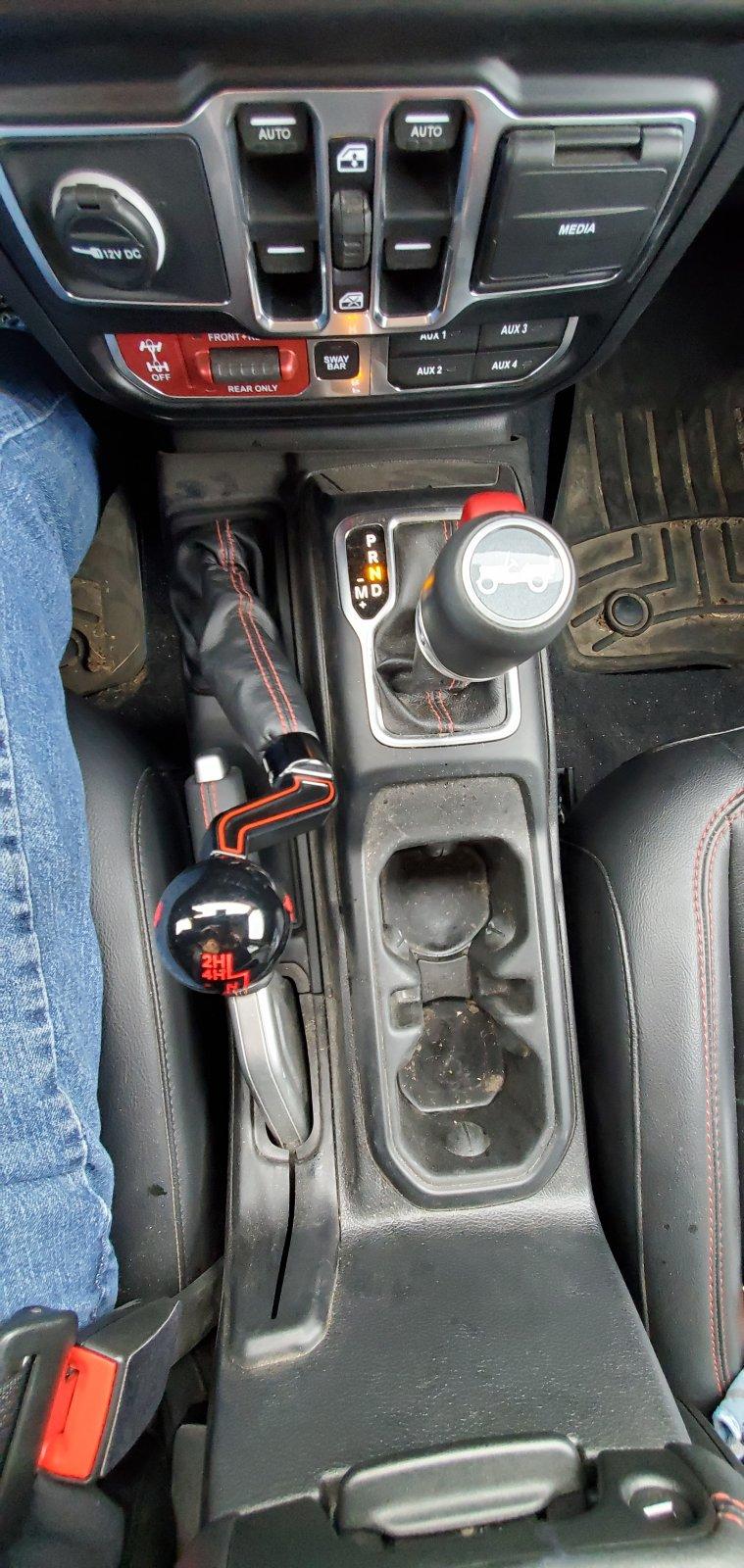

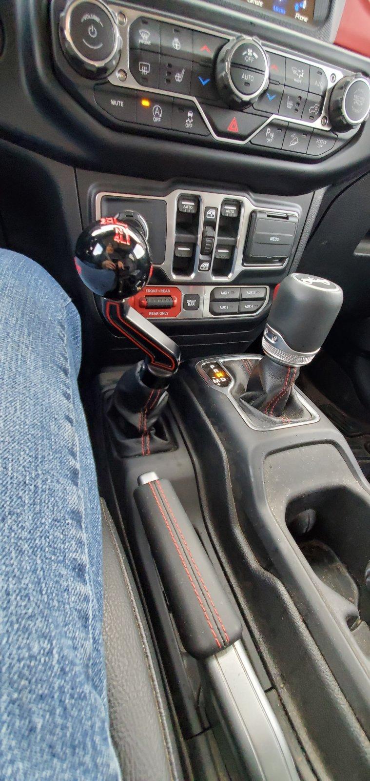

I'll make a mental note to take some more pics for you, when I head out for lunch. My regular driving position with the lever in 4hi and 4lo, so you have an idea of what kind of real estate is available.

2hi
Jeep Wrangler JL B and M Extedned Transfer Case Shifter 20201105_092810
4hi
Jeep Wrangler JL B and M Extedned Transfer Case Shifter 20201105_092900
A couple views of 4lo
Jeep Wrangler JL B and M Extedned Transfer Case Shifter 20201105_092940
Jeep Wrangler JL B and M Extedned Transfer Case Shifter 20201105_093012
Jeep Wrangler JL B and M Extedned Transfer Case Shifter 20201105_093032
