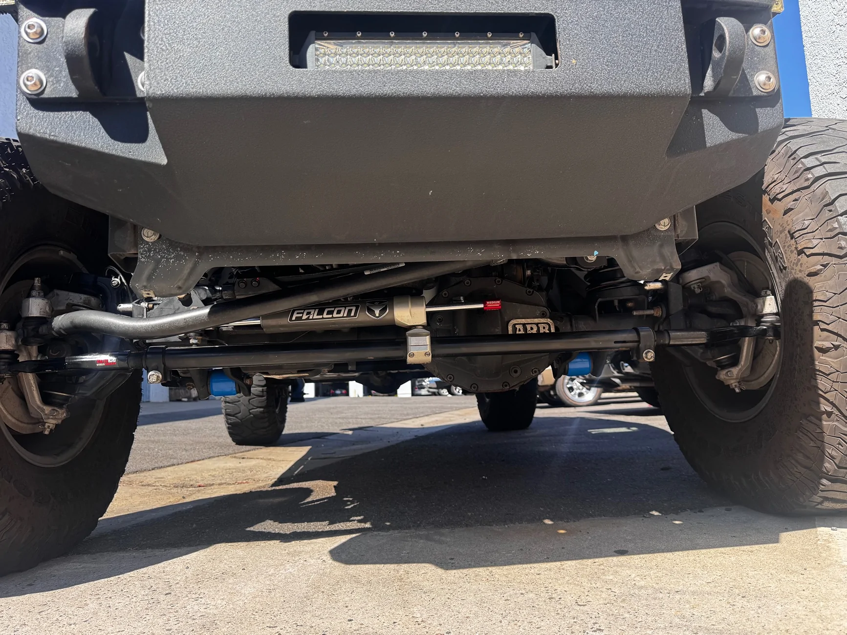

I happened to take a picture a few days ago and noticed the “new” axles have a track bar relocation bracket, where the track bar is raised 3”. It also has a stabilizer relocation bracket as well. I have a 2” lift that was kept during the install. The drag link is mounted in stock, under knuckle location currently…which is causing a “non-parallel” situation.

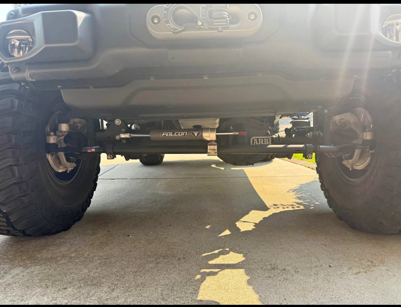

I also noticed on the ad for the axles I bought, that the previous owner had the drag link flipped…I.e. drag link mounted on top of the knuckle.

Jeep Wrangler JL Axles swap - torque steer during accel/deceleration IMG_4350
current setup causing problems
previous owner set up:
I would put the track bar back in factory position, then drive it to see if it helped.. what they’re calling torque steer might be bump steer, if that’s the case then it should take care of it….

I should be able to have them move it down and still keep the bracket there for the stabilizer correct? The only thing in the bottom should be a spacer where the track bar was?
No you can just get a stabilizer track bar bolt and ditch the bracket

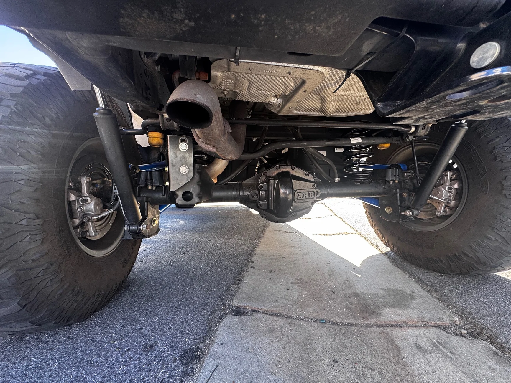

I suppose I should probably remove the rear track bar relocation bracket as well while I’m at it? 😅
The guy I bought the axles from had a far more significant lift than I do….so the axles were equipped for that.
The rear bracket will be ok especially if you have the factory rear track bar..

Sure man, no worries….. the bracket is probably the culprit for the torque steer as well…..the track bar is high enough that it’s probably pushing the axle off center to passenger side….. I’d leave caster where it is, that’s plenty for a 2” lift, IMO…..

Just an update: track bar was relocated to stock position and and everything is solid now. No bump steer whatsoever. Track bar and drag link are parallel.
