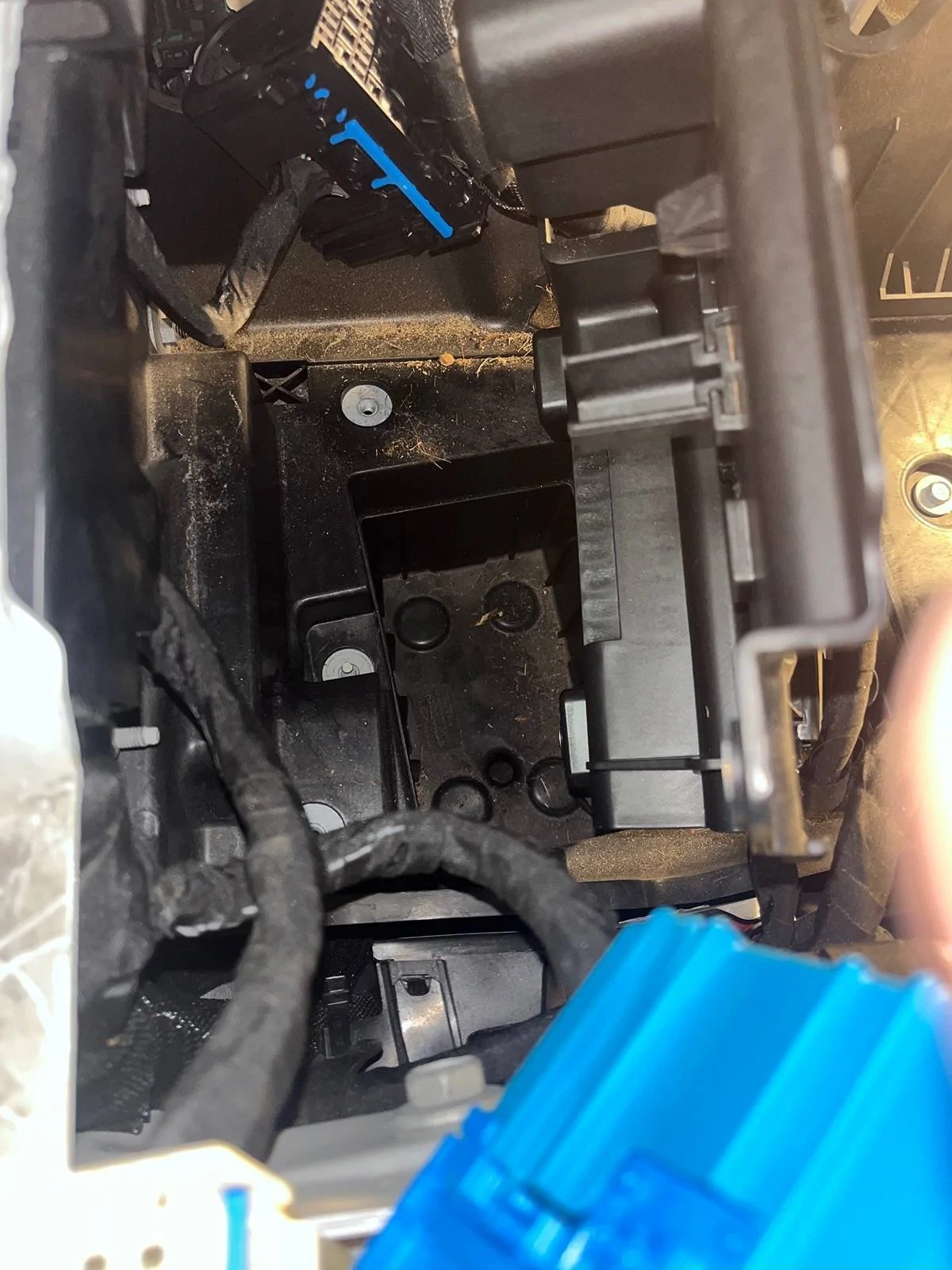

I just went to replace my auxiliary battery (underneath my main battery) but there is no battery there.. am I going nuts?

I am reading some other threads and they are saying the eTorque engine doesn’t have an auxiliary battery? I have the eTorque.

You have a 48v battery pack mid truck underneath. What DTC is it?

to identify etorque look for 3 separate coolant tanks on the right of the engine bay and no alternator, as the 12v battery is charged by the 48v system. in your case all electricity the etorque MGU generated went to the dying 12v battery so your 48v battery pack is also empty so start/stop don't work. the 48v battery is lithium no need to worry about that.
but the jeep starts on a conventional starter running on 12v for cold weather performance, hence the weak start and eventually unable to start.
