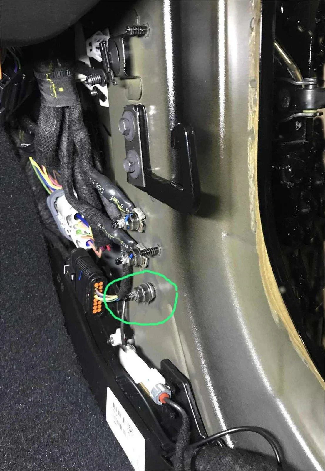

In regard to using the Aux switches.. If you hook something up to a aux switch and it seems to not be getting power, your ground is undoubtedly the issue. You must have a very good ground.
There is no ground wire in with the bundle of aux wires..
For a passenger foot well ground here is good:
Jeep Wrangler JL AUX Switch Questions footground
