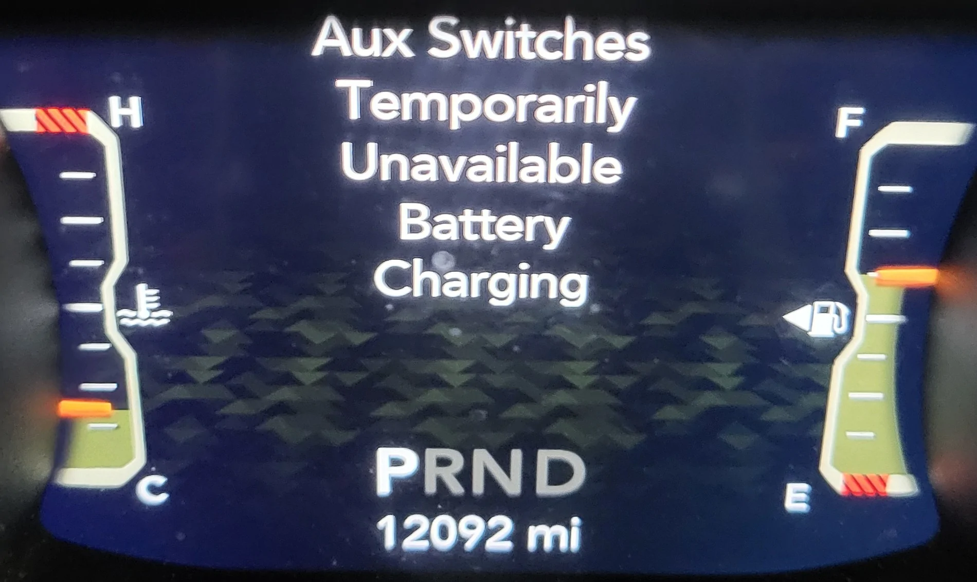

I never noticed this before but I wonder if this is what's causing the Aux Switches to shut off. They were off at this point but came on later.
I wonder if this can be corrected with the "AUX battery delete/bypass"?
