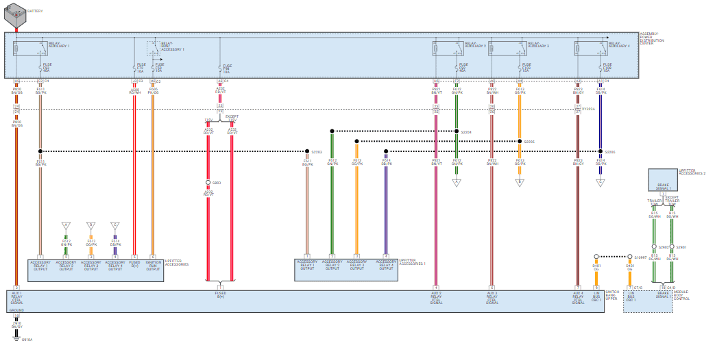

2020 JLUR with factory installed aux switches. The entire aux switch module backlight flickers along with and switch latched on. Eventually any switch that indicates on will turn off. I'm not sure if the accessory line is actually losing power when it flickers or the light goes out because i don't have anything hooked up yet. I've reseated all fuses and relays that i can see associated with the aux switches but they all seem to be for each individual switch and this problem seems to effect the entire cluster.
My next thought is to check the connection behind the switches but before i start pulling apart the dash, anything else i should look at? Is there power distribution to the entire cluster somewhere and not just the individual fuses?

I think the switch portion itself is under $100. I'm guessing it's a bad switch. There's a 10 amp fused B+, ground, CAN to the BCM, and the relay outputs.

Thanks for this. I see the 10a fuse but cant make out the fuse number. Not sure if i checked this one. F99 maybe?

F98

Fuse was good, guess ill go after the switch bank.
FYI, there are two versions of the switch, one with Rubi trim and one without, make sure you order the right one if you have to replace it.
