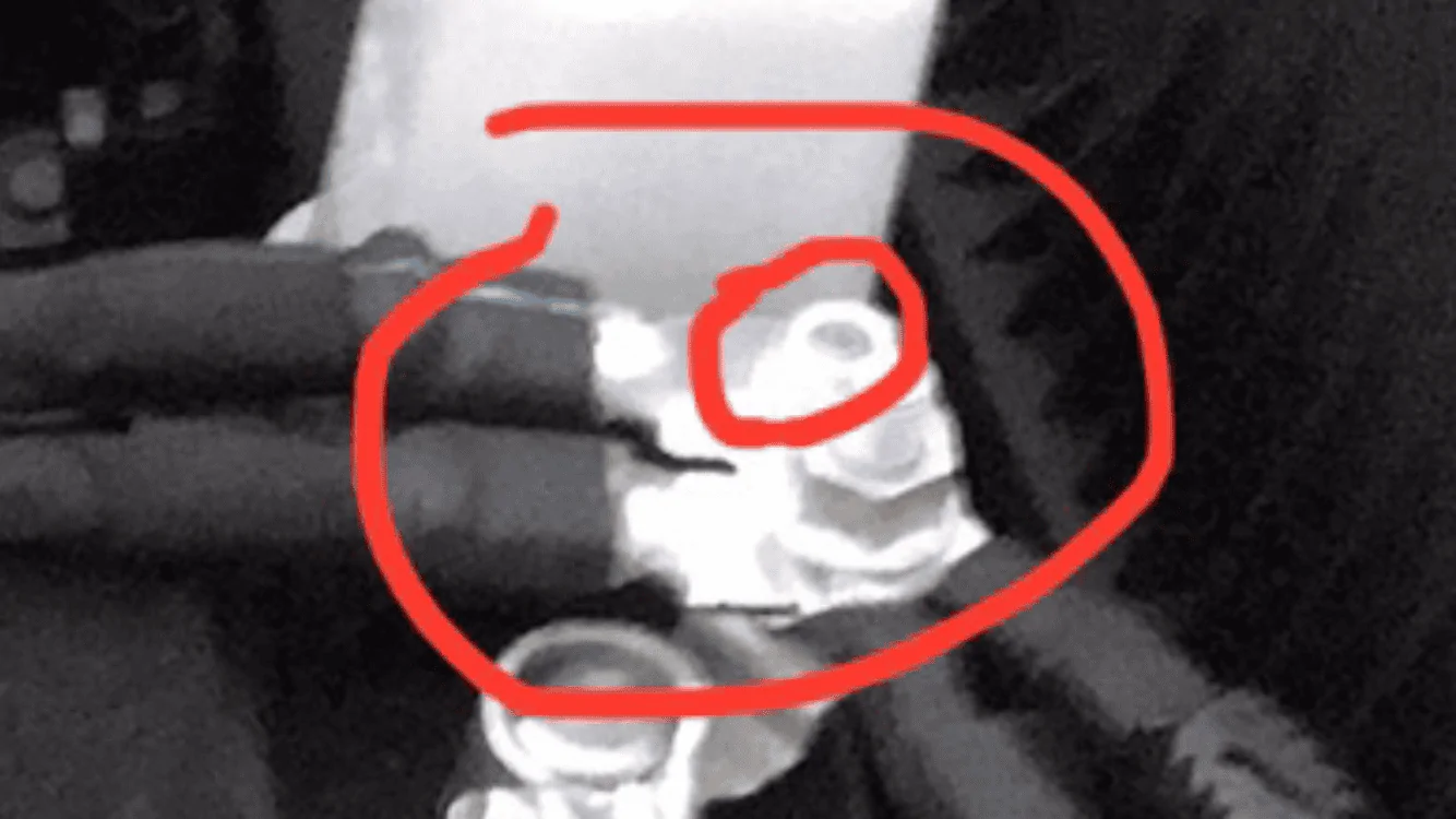

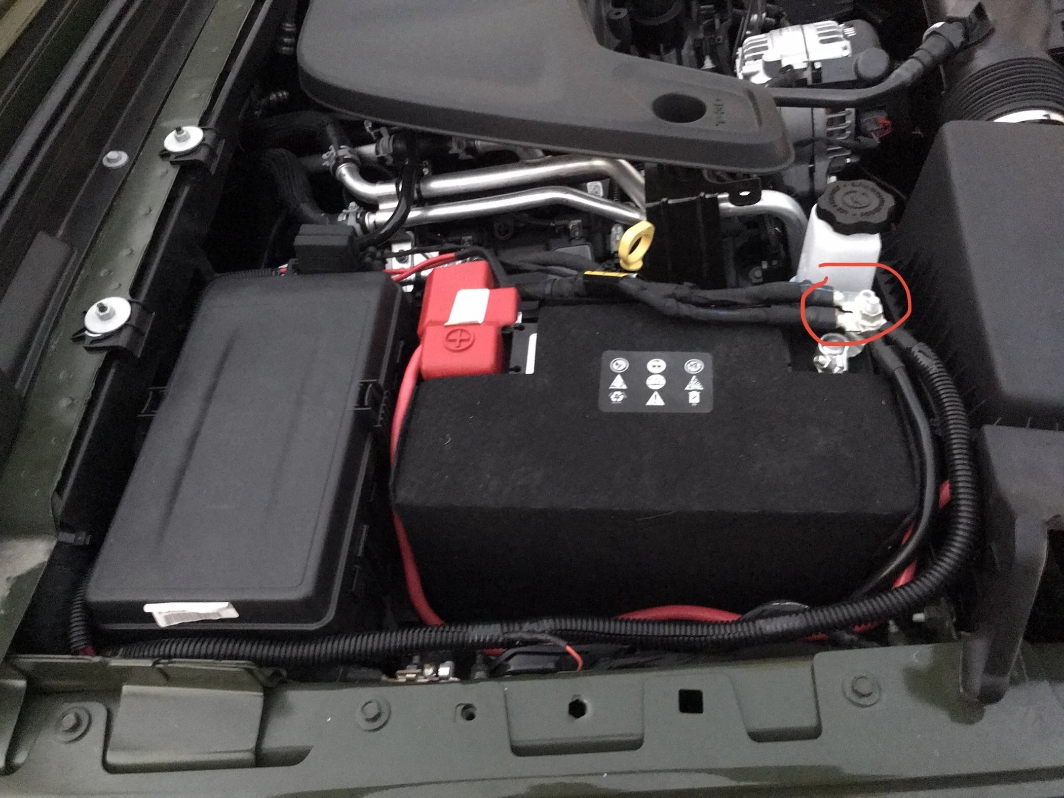

Which negative post is the one to the aux battery?

I haven't gotten my hands on my Ecodiesel yet, but on the Pentastar the ESS battery negative is the separate studded cable on the negative terminal (the top one in the red circle in the picture; I didn't do a very good job of outlining which one I was pointing at in this picture):
