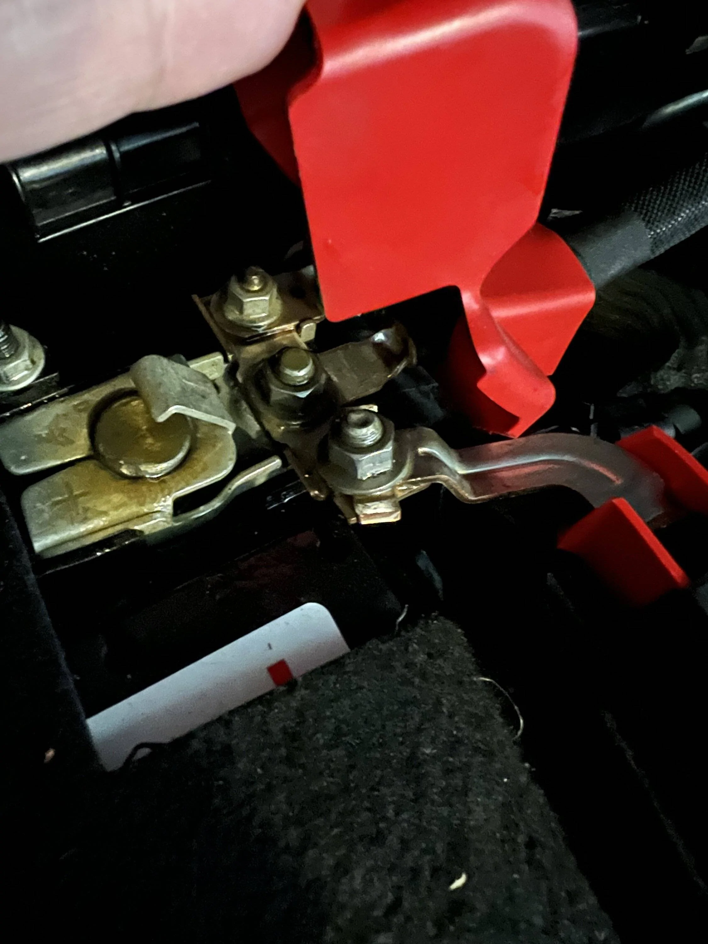

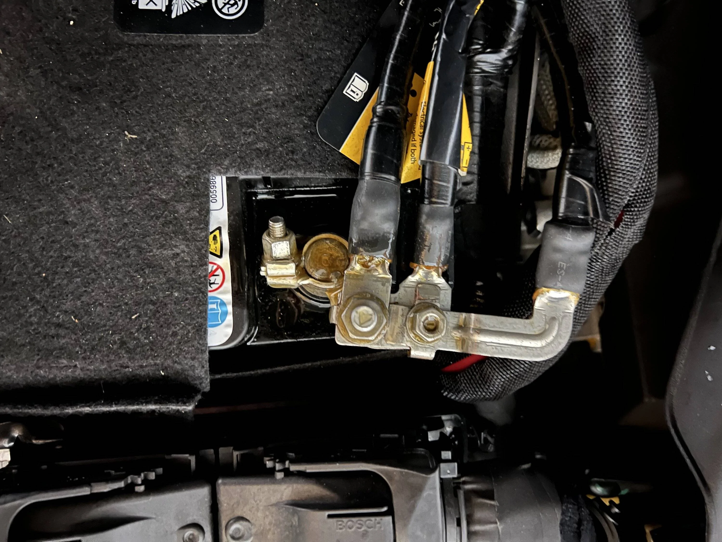

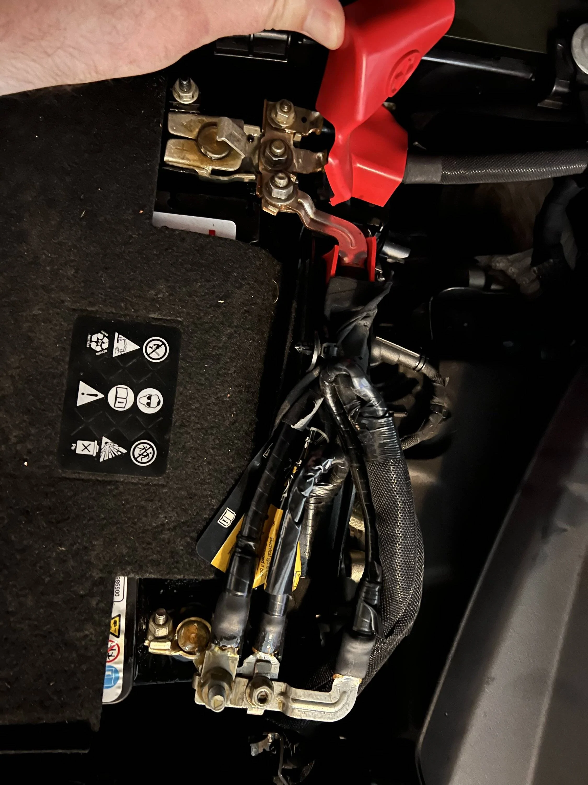

Had some nagging concerns on the AUX battery situation. I have the ESS disabled with and add on so it is never used. Super simple and glad to be rid of the potential issue. I did run the cables up to the main battery so as far as the Jeep knows it is still in place. Very simple to do. You will have to drill out one of the terminal connectors, and flatten the wings on both. 15 minutes, a drill, a 10mm and a couple of channel locks.
If it's on your mind, just do it. My Jeep is less than a year old and I probably wasn't really having any issues, but being that I do not use the ESS it made sense to remove it.
Before removal my battery voltage was beginning to range between 11.5v (start) and 14.7v (charging). Not really an issue I guess, but it did bother me to see the low end of the swings. It did not dip that low for the first 6-7 months, at least not that I noticed.
After removing I sit between 12.7v (start) and 14v (charging). I feel a little better knowing that my start voltage is normal now, and the Jeep can be jumped if needed without any fuss.

Try trickle charger for a few days and see if the battery will stay at a higher charge? The AUX may have hurt it before you got it removed.
What did you do with the 2 ends of cables that attached to the AUX? If you just pull the negative off the main battery and tape it up and push it out of the way....you have no circuit. You made it sound like you have them connect back to the main battery?
