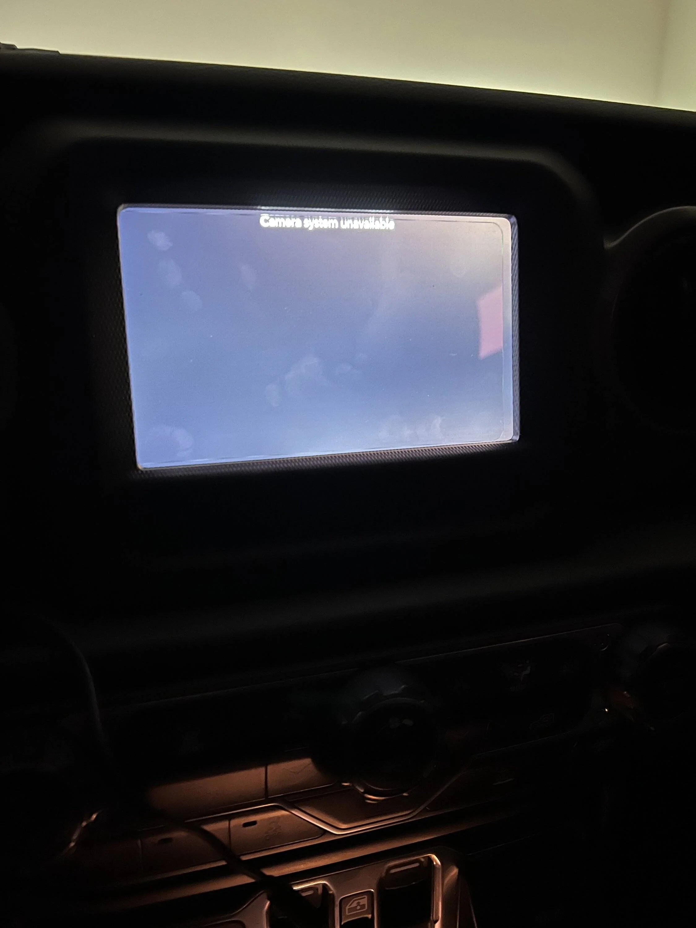

So I replaced my 7" radio a week and then my backup camera because of a chip out of the lens. Tested before putting back together and it worked. Put everything back together and now its says "camera system unavailable." Any ideas? Disconnect the battery?
when someone told me that it will just start working after a day or so I thought they were on drugs. But sure enough it started working the next day.
That’s about the only advise I have.
Fingers crossed.
