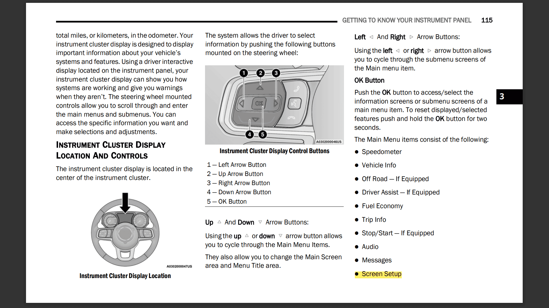

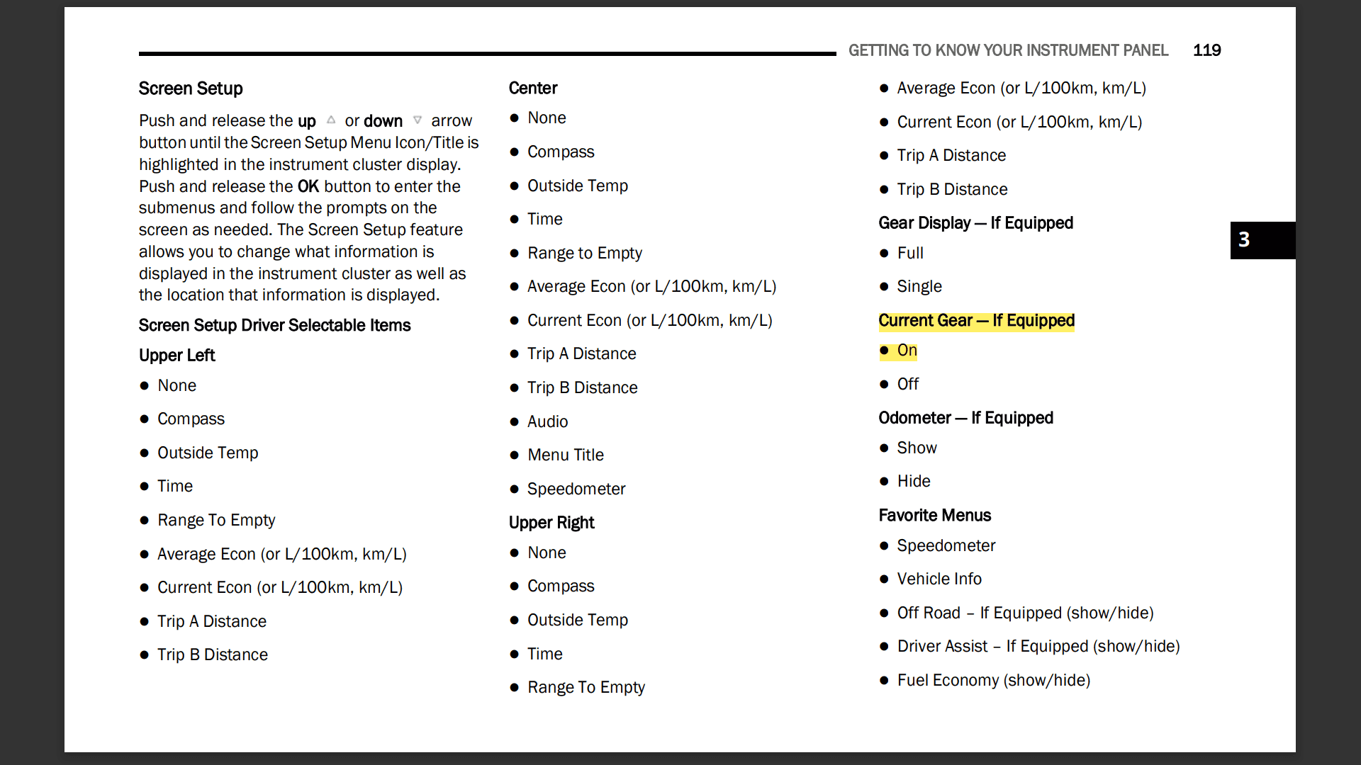

Thanks @davis53 for asking about this. I have a '15 Grand Cherokee that displays the current gear in the instrument cluster and was bummed that my JLU did not. I looked, but somehow missed the settings where it was also.
Thanks @Reinen for posting something helpful.
Here are the pages from the 3rd edition owners manual (that evidently I missed)if you don't want to watch the video.
Jeep Wrangler JL Automatic transmission gear indicator? 3rd edition Screen Setup 1
Jeep Wrangler JL Automatic transmission gear indicator? 3rd Edition Screen Setup 2
