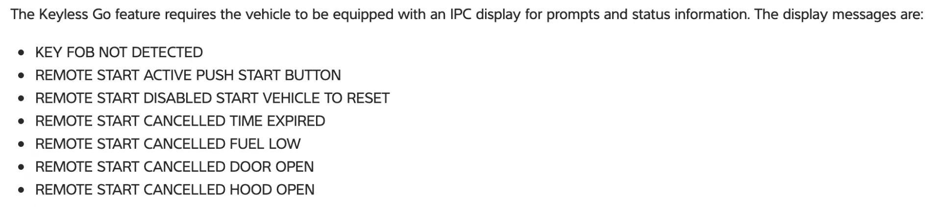

Here are the indications you may see.
Jeep Wrangler JL Auto start not working - shuts off quickly Screen Shot 2021-02-13 at 9.44.48 AM

I recall not seeing the A Triangle with arrow around it lit up, yellow light but no words

You do have to start it manually to reset the auto start. It's weird, I know, but I had the same problem with my Ram truck. One manual start and I was good to go for a bunch of remote starts.
