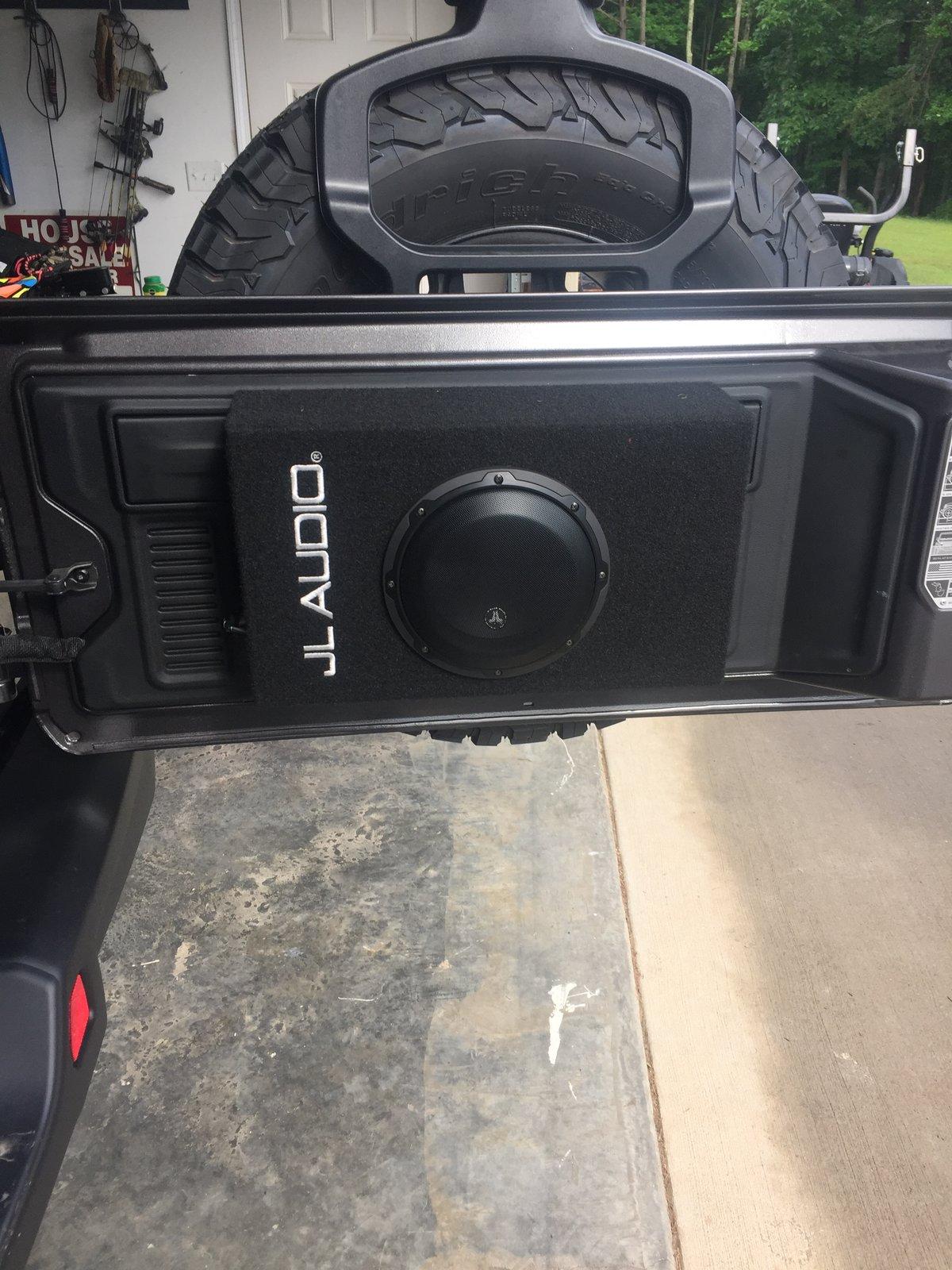

Secenario: I bought a 8" jl audio
ACP108LG-W3v3 with built in amp and asked my installer to duplicate @cmb396 awesome tailgate mount shown below using the 6 screw holes already on the tailgate with the goal of taking up less trunk space like this:
Jeep Wrangler JL Audio Experts-Help Needed Mounting Sub ehzTnva

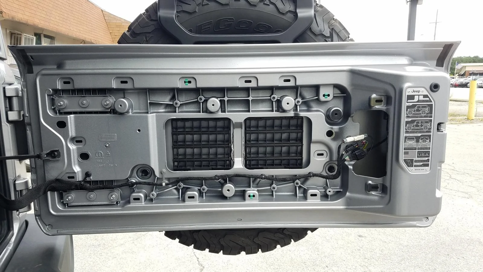

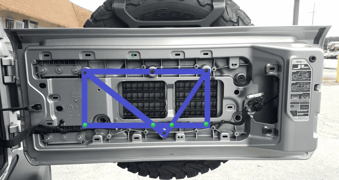

He took the plastic off the tailgate and said 6 mounting holes are spaced wide and the lower holes are recessed back atleast 1" requiring spacers to flush mount with the other holes. He could only access getting 2 bolts into screw holes working around the internal box frame/amp through the 8" hole cut out for the sub and didnt feel it would be a good long term anchor considering the box is made of 1/2" MDF. He also thought running large sub wiring through through a hinged area via the black sleave going to tailgate isnt ideal because of the bending of the wires every time the tailgate is opened. He said adding a mounting board would work, but that may block the whole plastic piece from connecting back to the tailgate exposing everything around the sub.(dont want that) @Sting_NC_USA was kind enough to draw this up below showing how metal or plywood mounting board could work:

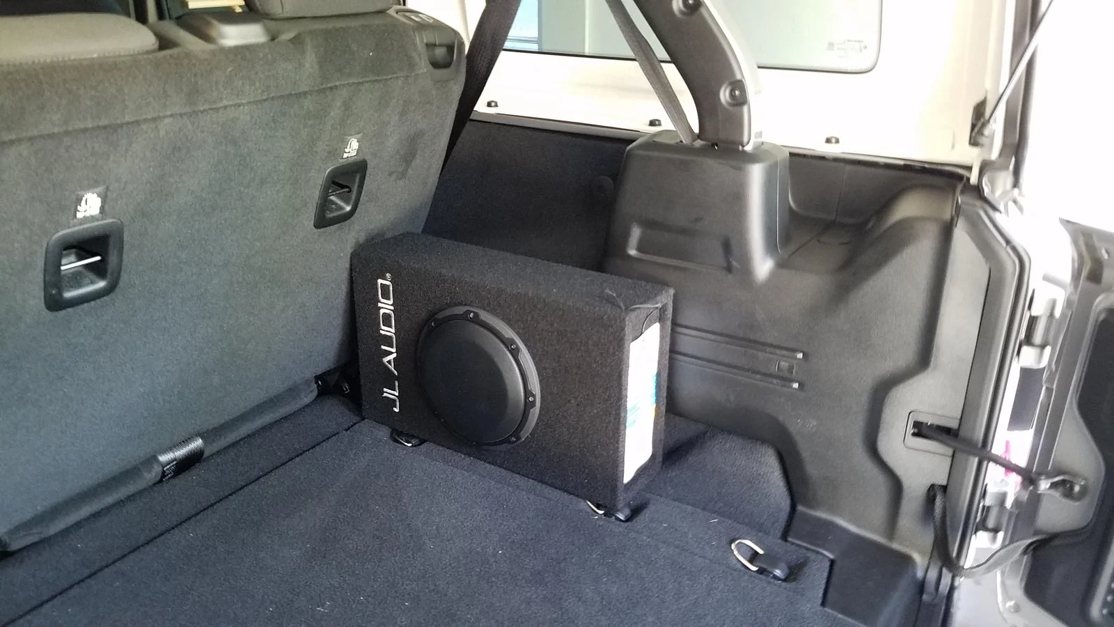

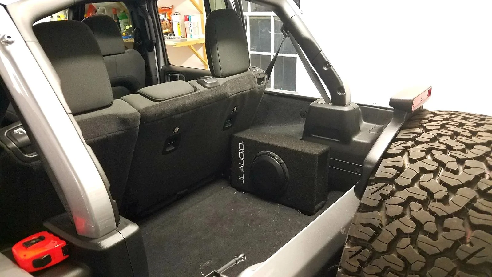

I am having him lay the sub in the floor until I can get a solution. Any other ideas of different locations to mount this? The tailgate mount is also going to cost more bc he needs to add wiring to reach. I would actually prefer to mount it myself using the current wiring to save money. Here's the current location and I have about 3' of loose wire length left to move it.
Currently sitting here:
Jeep Wrangler JL Audio Experts-Help Needed Mounting Sub guq5rfg

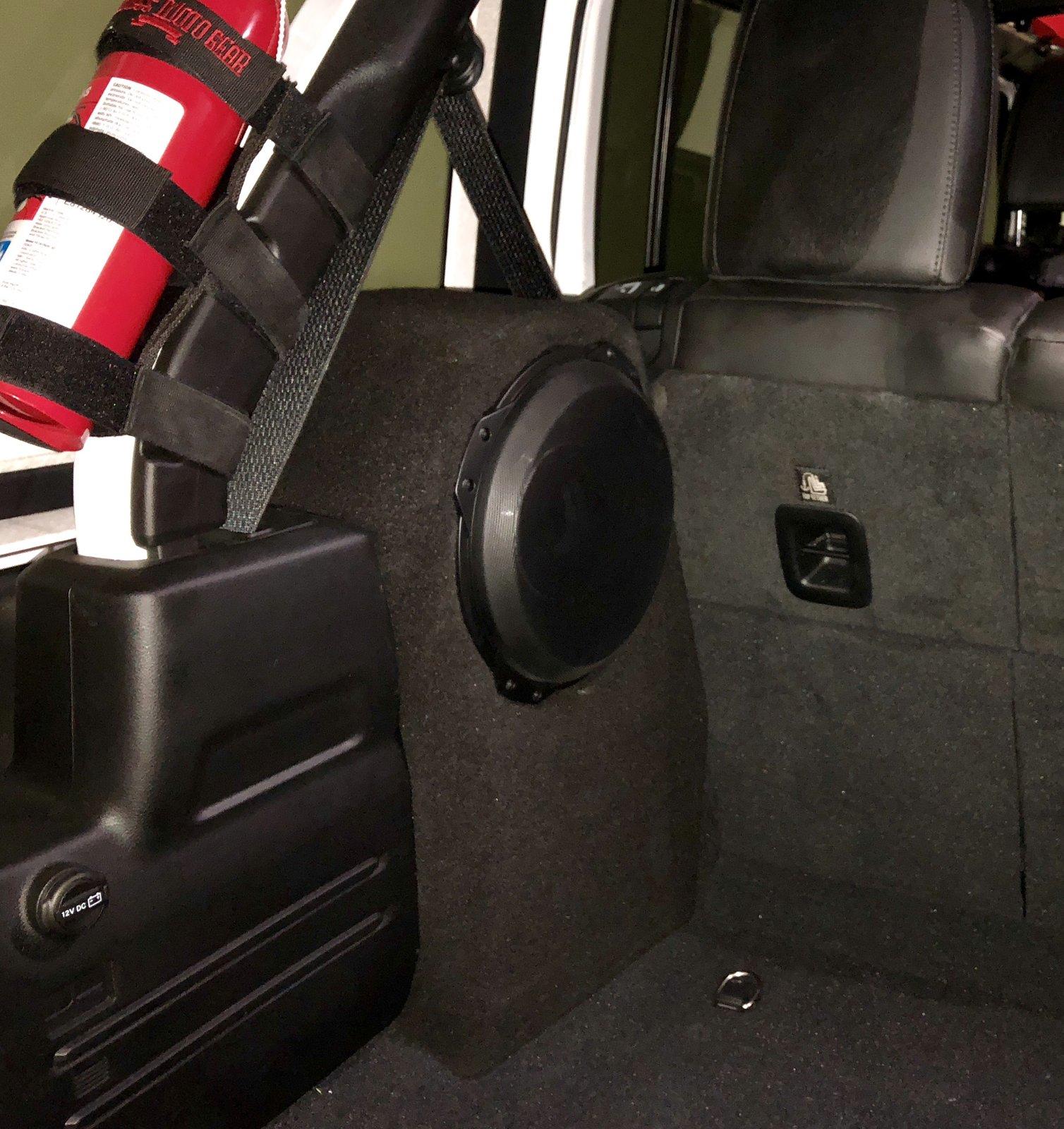

I ended up building a mounting board on the side of trunk with a 2x6 and mounting there. I gave up on the tailgate mount due to not wanting to pay another $200 for wire + professional install. It sounds great with no vibrations. Looks like this:
Jeep Wrangler JL Audio Experts-Help Needed Mounting Sub skgRG3U

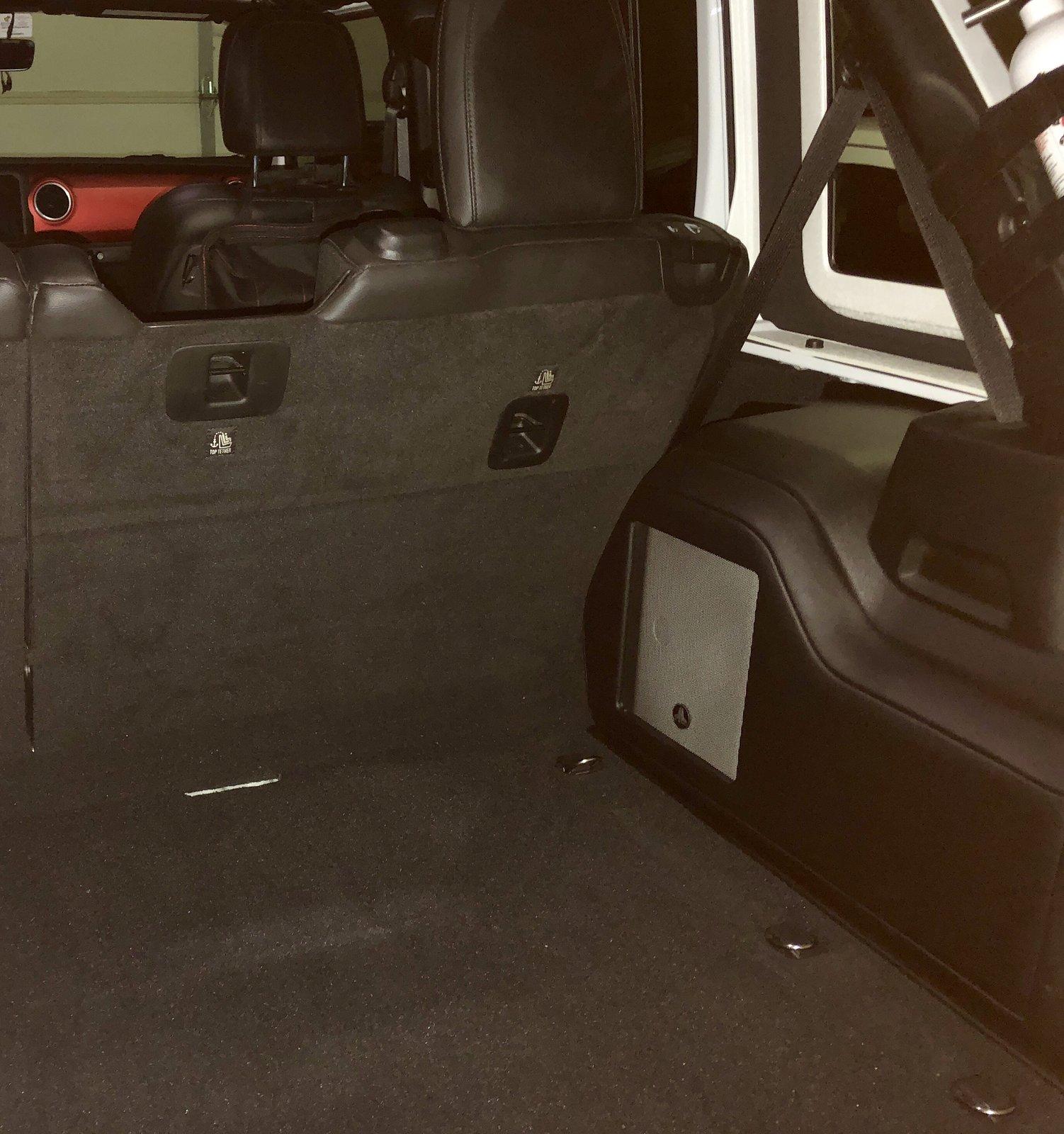

Here is what my shop did for a 10” JL Audio
Amp rack where the factory sub was and a new Sun enclosure on the drivers side. There is a 750x1 and a 150x4 Marine Grade JL Audio amp
Behind the panel.
