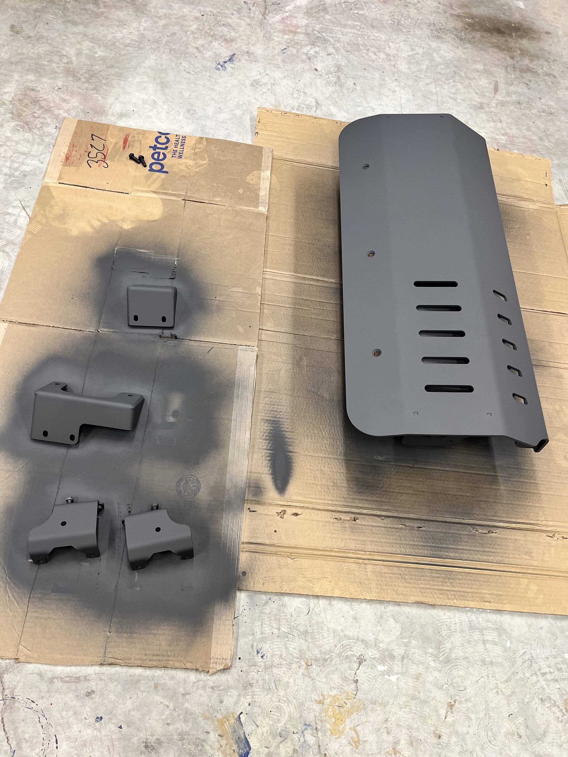

Before paint
Jeep Wrangler JL Artec DEF skid and belly pan install notes 37DE3137-31F6-42BF-83F7-1C29EE9C91AC
I washed the pieces with Dawn soap and water, scuffed with 150 grit, then wiped it down with alcohol. The paint I used was the Rustoleum high temp stuff. Nobody local had the high temp primer in stock. Finish was nice but I’m not terribly impressed with how well it’s holding. Could be because I didn’t use primer though.
Jeep Wrangler JL Artec DEF skid and belly pan install notes 6841D90D-17C9-436C-BA8A-71C503ED0A2D
The first pieces to go on are the ones in the lower left above. They attach to the frame using the two small nuts on either side of the body bolt

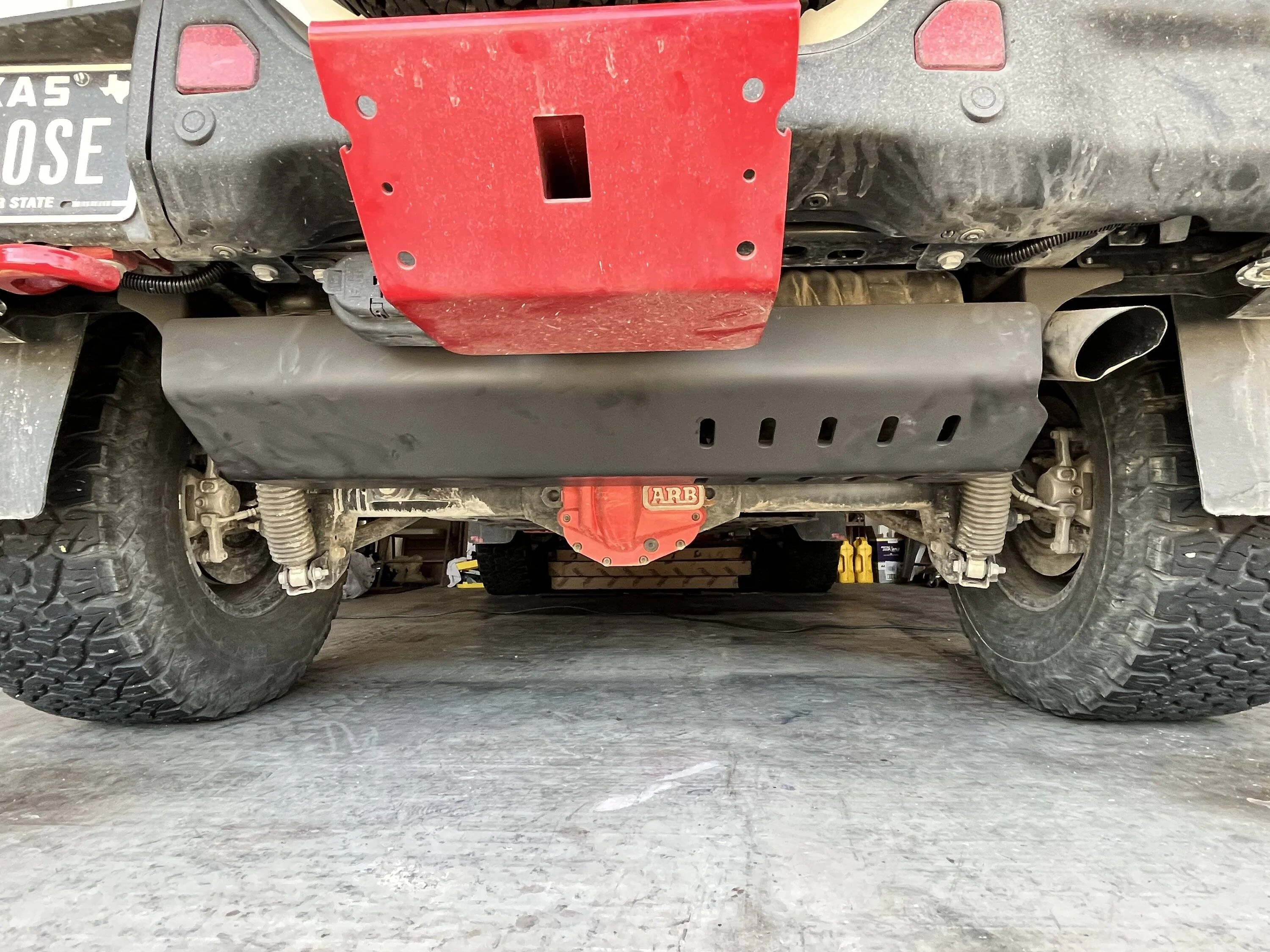

Once the these brackets are on the rest is pretty self explanatory. We used a pipe in the exhaust to move the muffler to access the one bolt hidden behind it.
Jeep Wrangler JL Artec DEF skid and belly pan install notes 77969720-111E-49DD-9657-7537DE1D08E5
The last thing we tightened up was the three countersunk bolts that are on the leading edge (visible in first two pics). Make sure you insert the threaded backers before you block access.
Not too shabby looking…

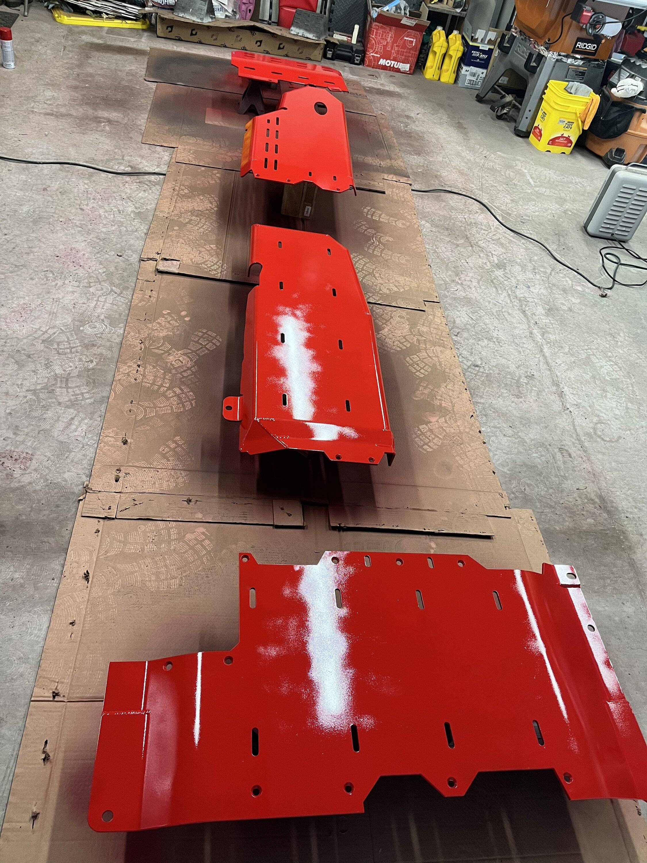

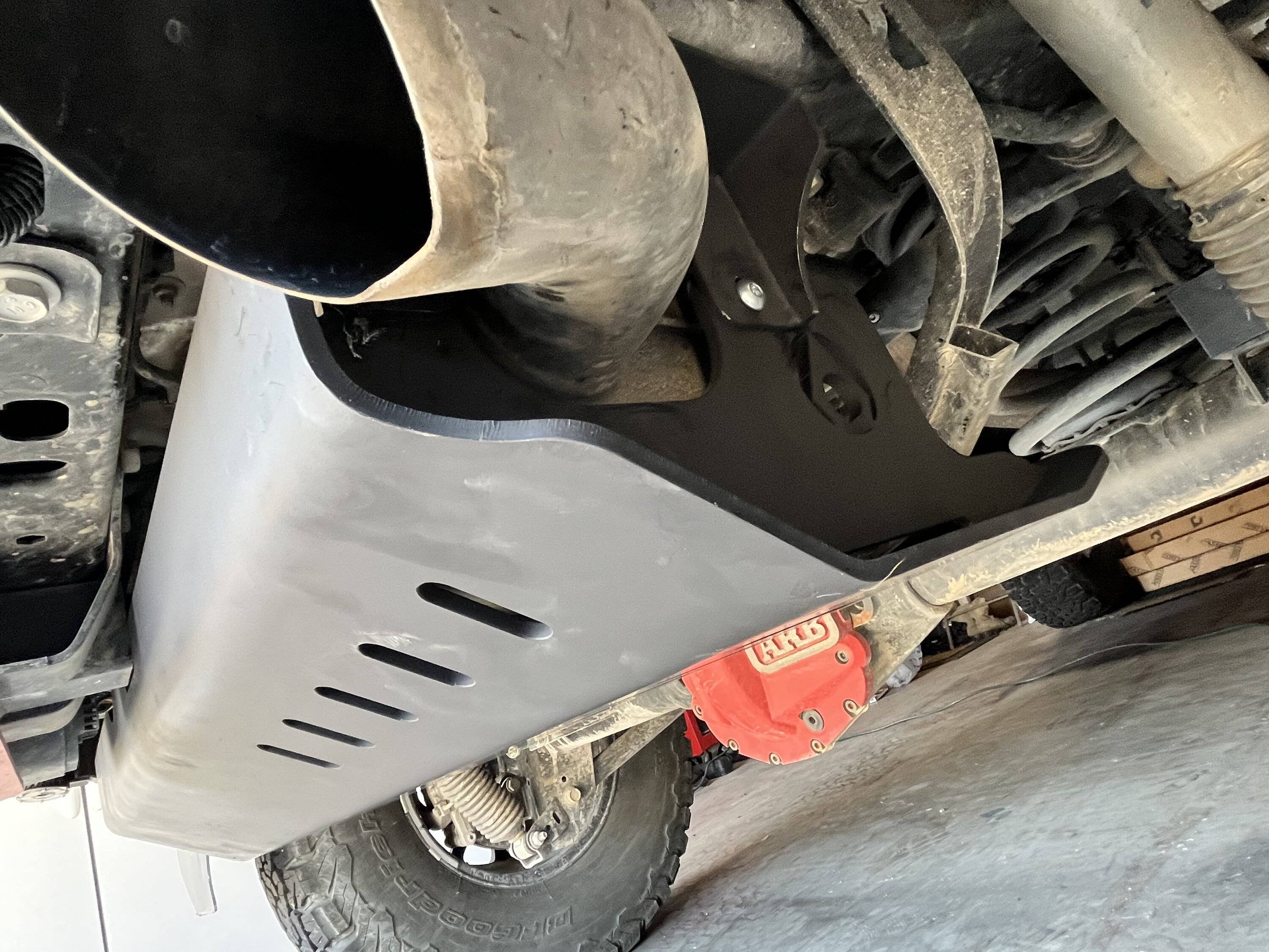

Got up early (and started work a little late) to prime and paint the belly pan. It’s supposed to be above 70° so seemed like a good idea. Check out all this extra HP that just bolts right on! Between the red and the manufacturer stickers I’ll stick on later I might be poppin’ wheelies.
Jeep Wrangler JL Artec DEF skid and belly pan install notes BE13A640-73D8-4D63-8379-BDF23EAFBF99
I used different rustoleum paint here than on the DEF skid:
Jeep Wrangler JL Artec DEF skid and belly pan install notes A16FBB0F-0A36-42C7-90BD-D4579D8BD88C

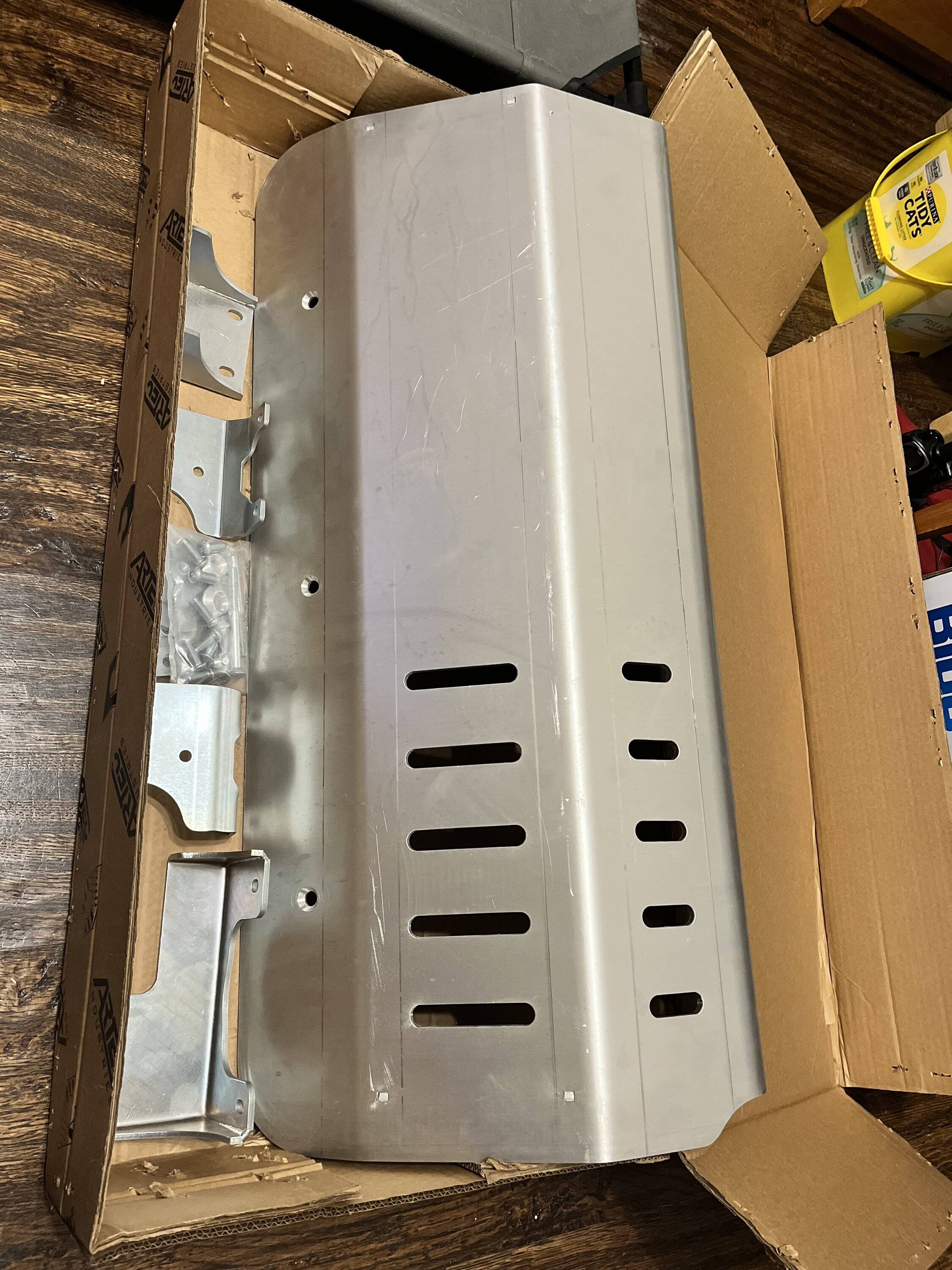

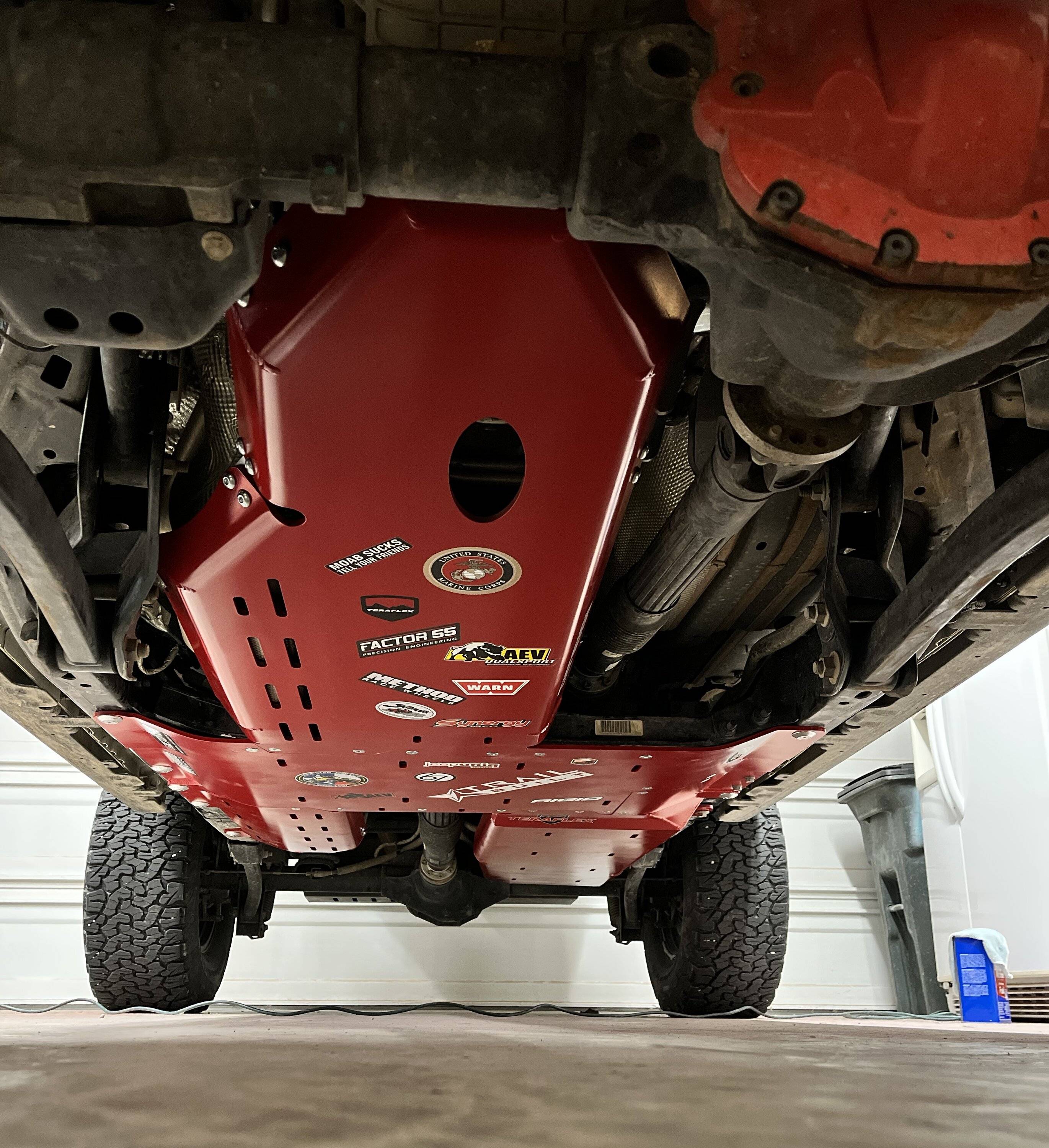

Got the belly pan installed
I rewatched their JT install video several times and made these notes:
  1. Remove factory transfer and other skids.
  2. Remove fuel filter, skid set aside big bolts on rail and inside to frame to reuse.
  3. Use 10mm inside for bracket trim piece.
  4. Use 13mm for fuel filter to bracket, save, will reuse.
  5. Loosen fuel tank skid, use ratchet strap to hold up tank. (Had to nearly remove all bolts before metal fish tape would go through).
  6. Install metal tank strap with factory bolts. Then remove ratchet strap.
Loosely install:
  1. Engine brackets
    -4 on passenger side
    -5 on drivers side
  2. Insert threaded plates in factory crossmember.
    -8 on passenger side
    -9 on drivers side
    Note: These both needed to be cut down to fit through crossmember holes.
  3. Install oil pan skid to crossmember and engine brackets. Add small support bracket on passenger side of skid.
  4. Add new crossmember with one countersunk on driver side only. Wings on either end point to the rear.
  5. Install T-case skid using flag nut -3 on passenger side
  6. Install exhaust skid and bracket -23
  7. Install fuel filter into bracket, slightly thread on factory nuts. Install bracket with 9/16 bolt into new crossmember and re-use factory 13mm bolt. Tighten nuts holding fuel filter.
  8. Hang fuel tank skid brackets -21 and ? With factory bolts. Insert carriage bolts into rear of fuel tank skid from inside, use tape to hold in place. Hang skid from rear brackets, work forwards using countersunk bolts.
  9. Install fuel filter door with bracket -17. Will reuse two factory bolts that held on original filter bracket.
  10. Tighten everything back to front
  11. Drill 3/8 hole in frame for forward most driver side hole. Start with center punch. Use flag nut and recessed bolt.
  12. Apply stickers.

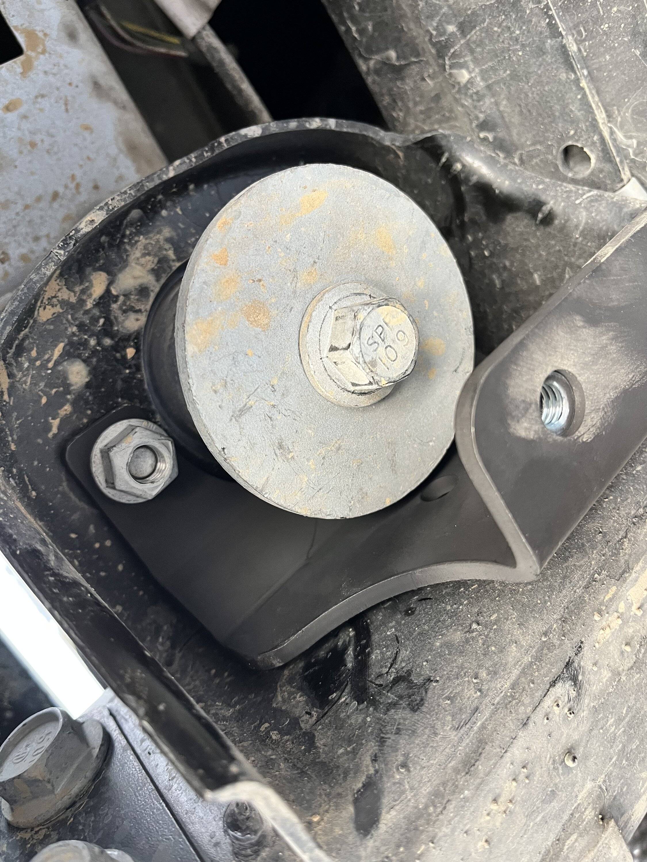

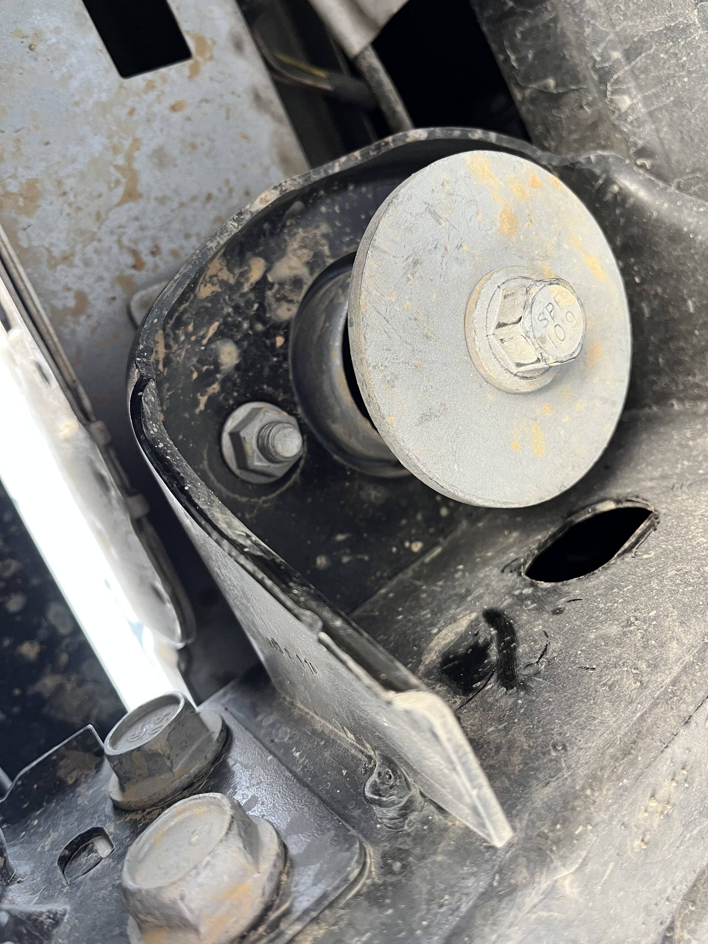

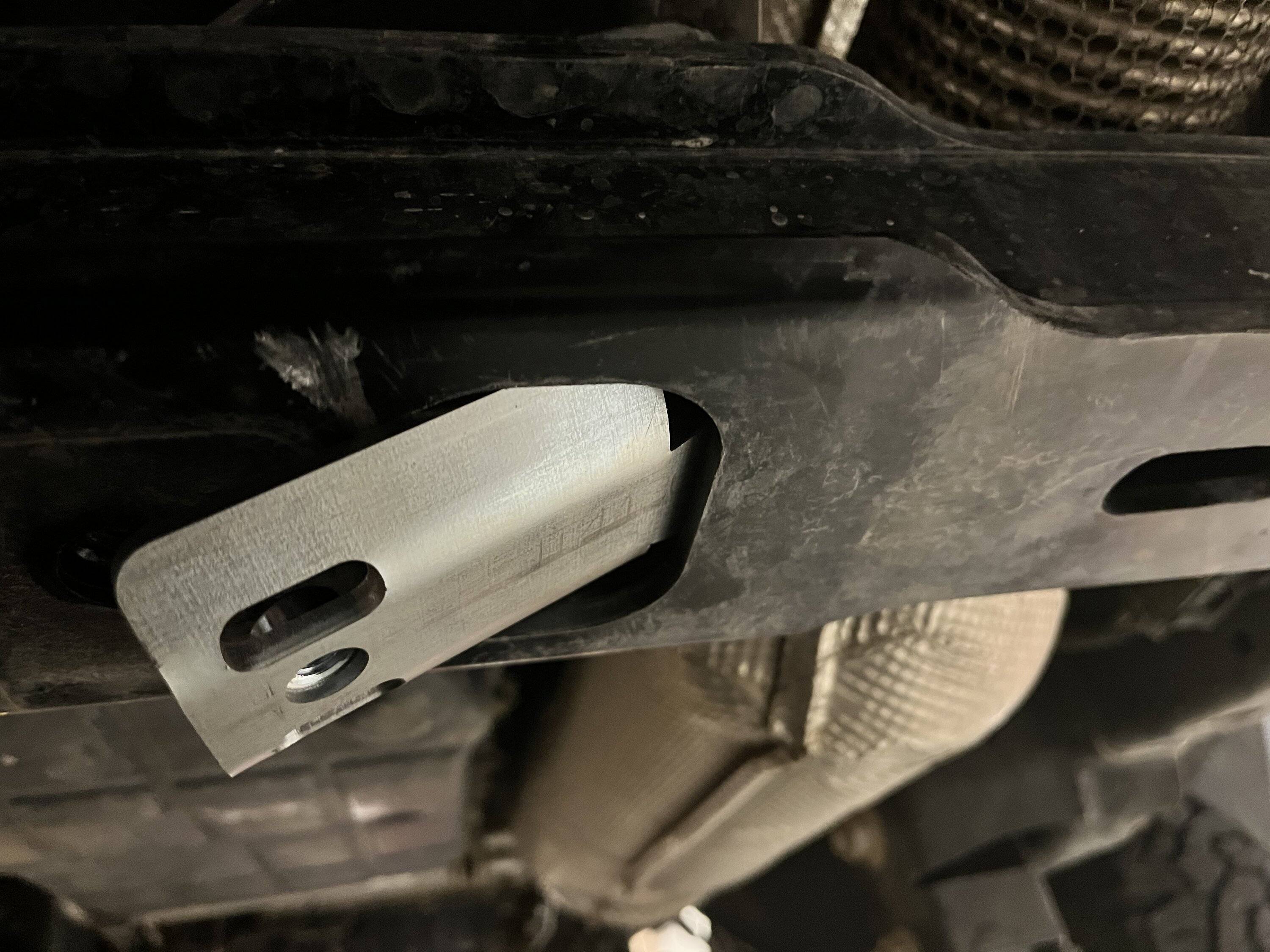

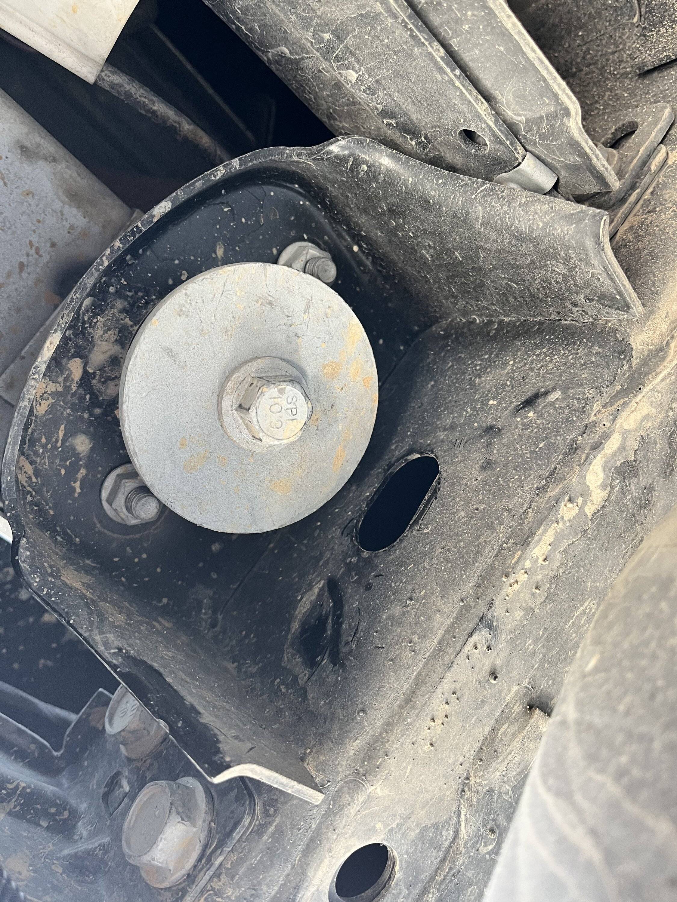

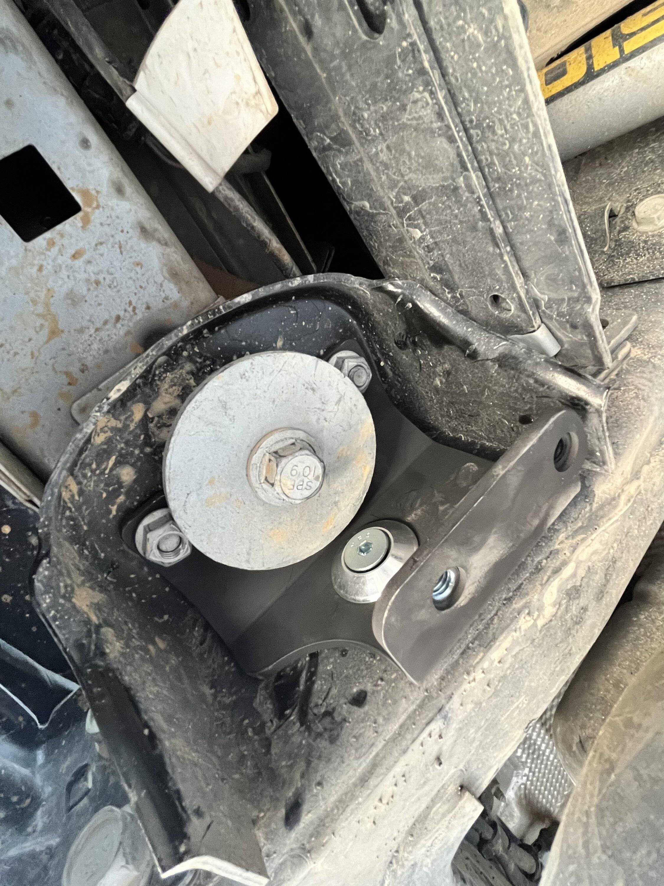

Some other folks mentioned receiving flange nuts in the parts kit that are the wrong thread pitch. I did as well.

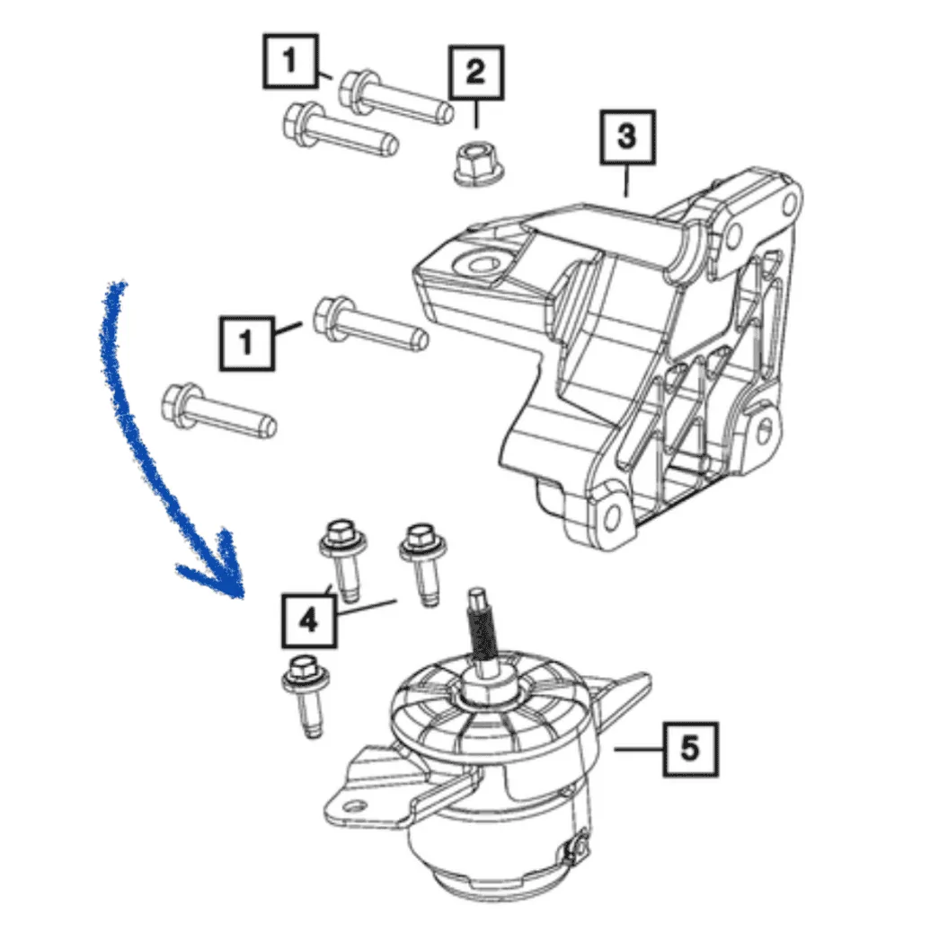

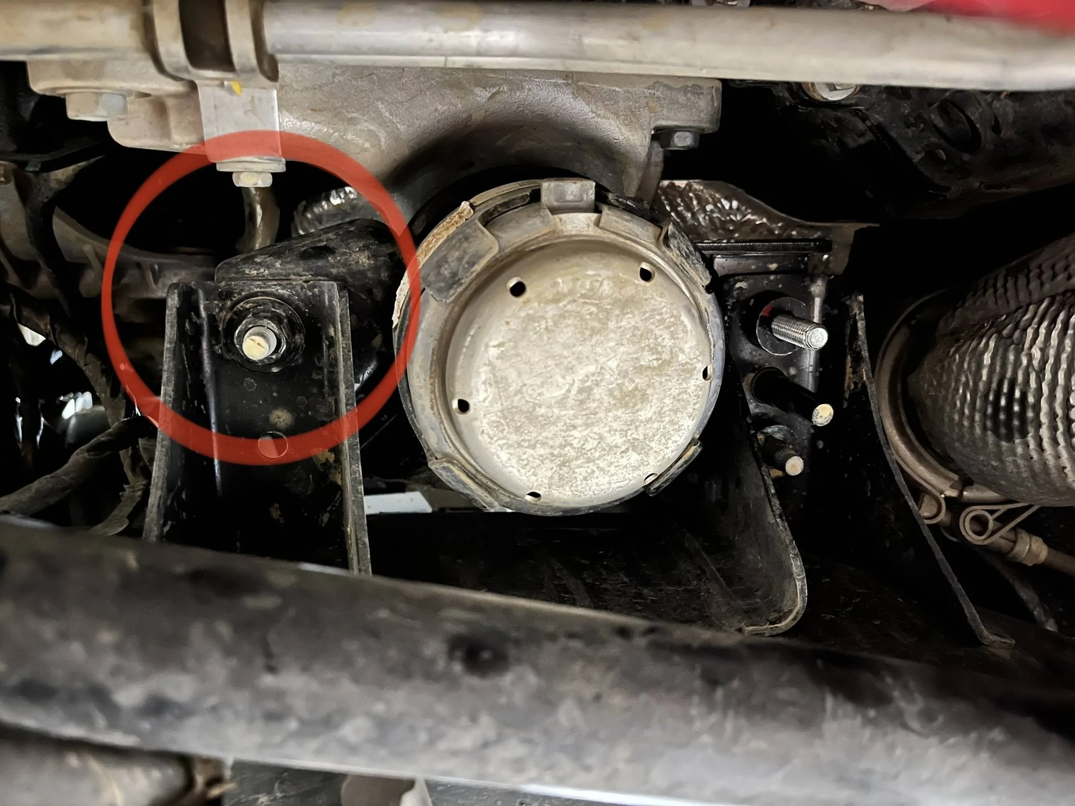

The video doesn’t go over how to hang the engine brackets. On the passenger side, you need to use the forward most bolt:
Jeep Wrangler JL Artec DEF skid and belly pan install notes 1671255202498
Jeep Wrangler JL Artec DEF skid and belly pan install notes F272E8C7-B38C-4FAB-A8E7-FF9B797D95D5

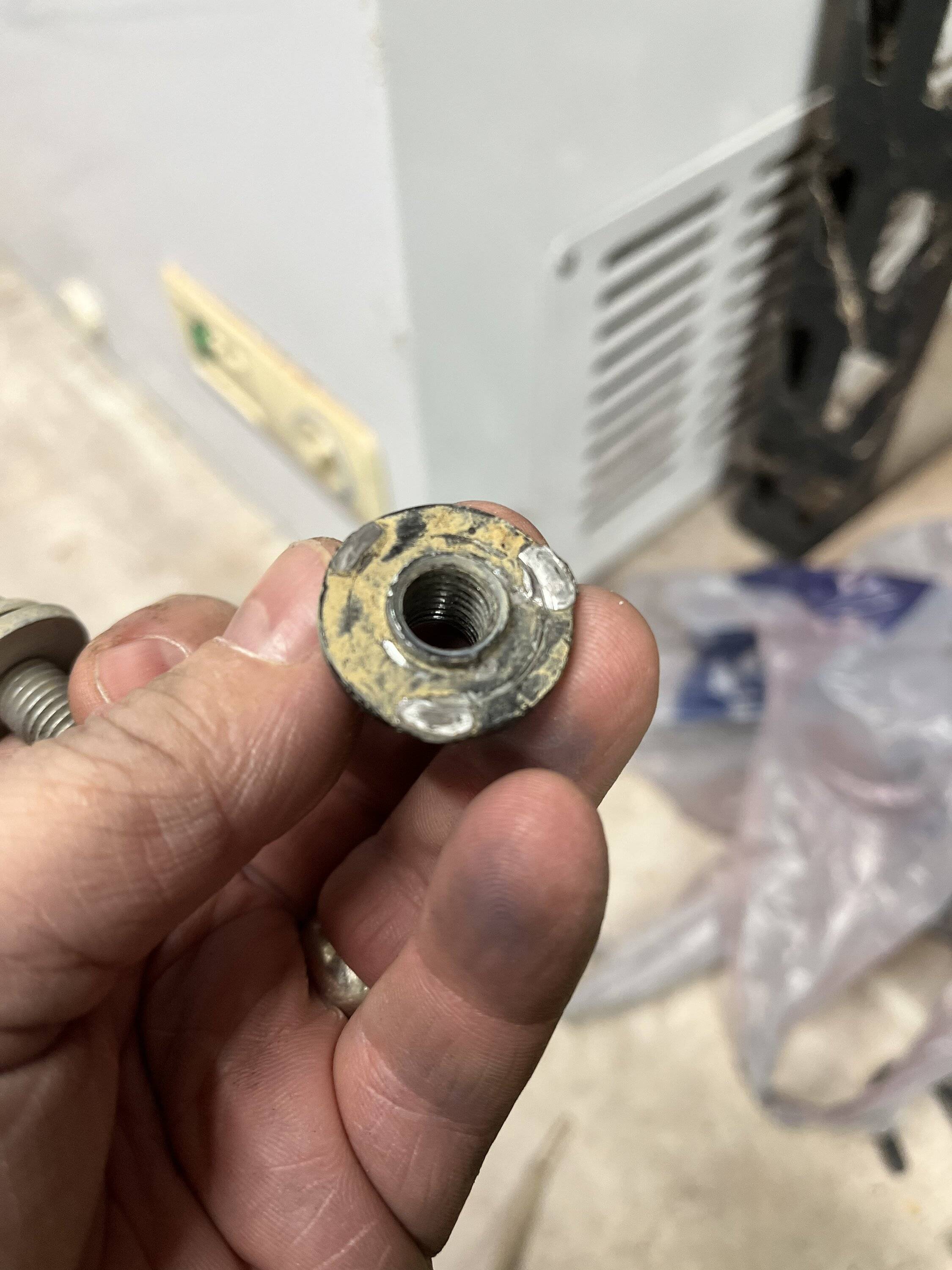

Turns out that ”nut” is spot welded in. Hopefully it isn’t too important… =/
Jeep Wrangler JL Artec DEF skid and belly pan install notes 0FFD6CC2-7F4E-491D-BEDB-04EF80A2E3D0
I think their intent is that you back out the bolt, install the new 10.9 longer one, then sandwich the bracket between that nut and another one.
