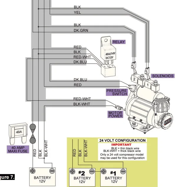

2018 JLU 3.6 installed ARB with the wheel mount, all good there. My question is, HELP PLEASE, I want to buy pass the ARB relay and wire from the pressure switch on the ARB to my Rough Country's ML C-6 switch; both relays are 40 amp. Yep,
Jeep Wrangler JL ARB Single stage no lockers 20200314_171114
I have a RED & DK BLU on the pressure switch. Which go to the positive on the pod switch, and where do I connect the red?

So here's the issue with your plan. There is a low amperage and high amperage side of the ARB recommended installation.
The low amperage side contains the switch and the pressure switch which both control the relay to turn on the high amperage side. The high amperage side activates the motor power.
Without knowing if the pressure switch can handle the 40 amps, I would recommend installing the ARB relay in addition to the Rough Country one.
So here's how I'd eliminate the ARB switch, wire the RC output to the Red "input" on the pressure switch (not the relay 40 amp input). Run the rest as shown, with the Dk Blue from the pressure switch activating the relay.
