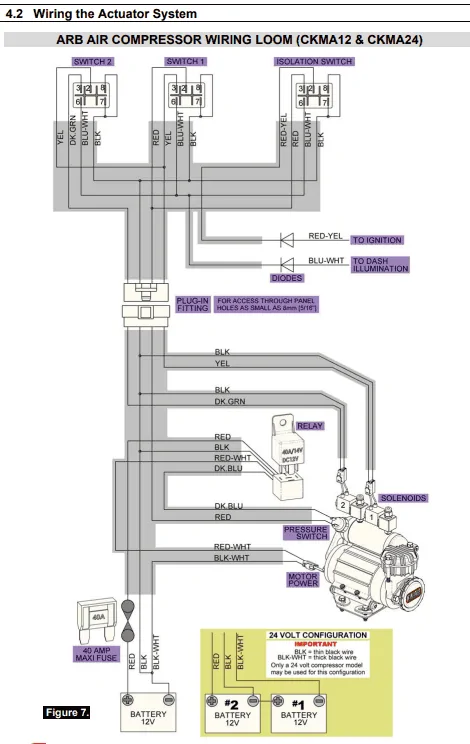

To help with troubleshooting, here's the wiring diagram (includes the solenoid portion for lockers)
Jeep Wrangler JL ARB Compressor wiring mystery - help needed please. 1661179307394
I'm trying to follow the posts above:
Power circuit:
12 V+ to 40 amp to Red to Relay to Red-White to Motor to Black/White - Checked okay by jumping relay.
Switch Circuit:
Aux 4 to Red to Pressure Switch to Dk Blue to Relay to Black to Ground. - Unproven Pressure switch and Relay.
Relay Circuit:
Switched: Red to Red White - Confirmed not switching, but may be trigger
Trigger: Red to Pressure Switch to Dk Blue to Black to ground - Unproven
So, need to confirm:
1. Aux 4 power to red at pressure switch
2. Pressure switch operation (need to confirm system is not at pressure before jumping)
3. Relay operation by supplying 12V+ to Dk Blue

So tonight I confirmed the pressure switch is the issue.
I turned everything on, ignition and Aux 3, bridged the pressure switch wires and the compressor turned on. I also bridged the hot wire on the relay with the blue trigger wire and the compressor came on.
