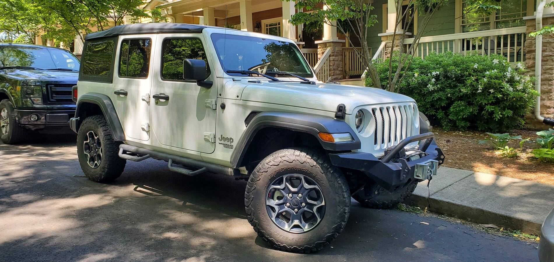

I have a spartan lunch box locker in the front of my 21 JL Sport. I have a Dana 44 LSD in the rear, wouldn’t change a thing, right now. I’m running factory rubicon wheels and tires, and suspension. I ordered Mopar lift and probably will go to 35’s.
I do drive my Jeep a lot, it’s a daily driver. I do have some clicking in 2 wheel drive when turning really sharp. It’s not bad enough to annoy me.
I off road as much as I can, but I don’t like doing mud. I go up to Beasley Knob in Blairsville and ride out there. Terrain is extremely steep and rocky in some areas. I drive as far as I can in 2 wheel drive, when it won’t go I put it in 4 wheel drive and it just goes. Never been stuck with the lsd and locker. That being said, I haven’t really put it in a situation to get stuck
I had a 2017 Rubicon, ( ex-wife got it in the divorce)I would love to have lockers in my JL, but I can’t justify the expense based on how much I go off-road and don’t put the Jeep in a situation that would damage it. I think one day I’ll buy a locker for the rear, maybe find something for the front, but for now this works for me well.
