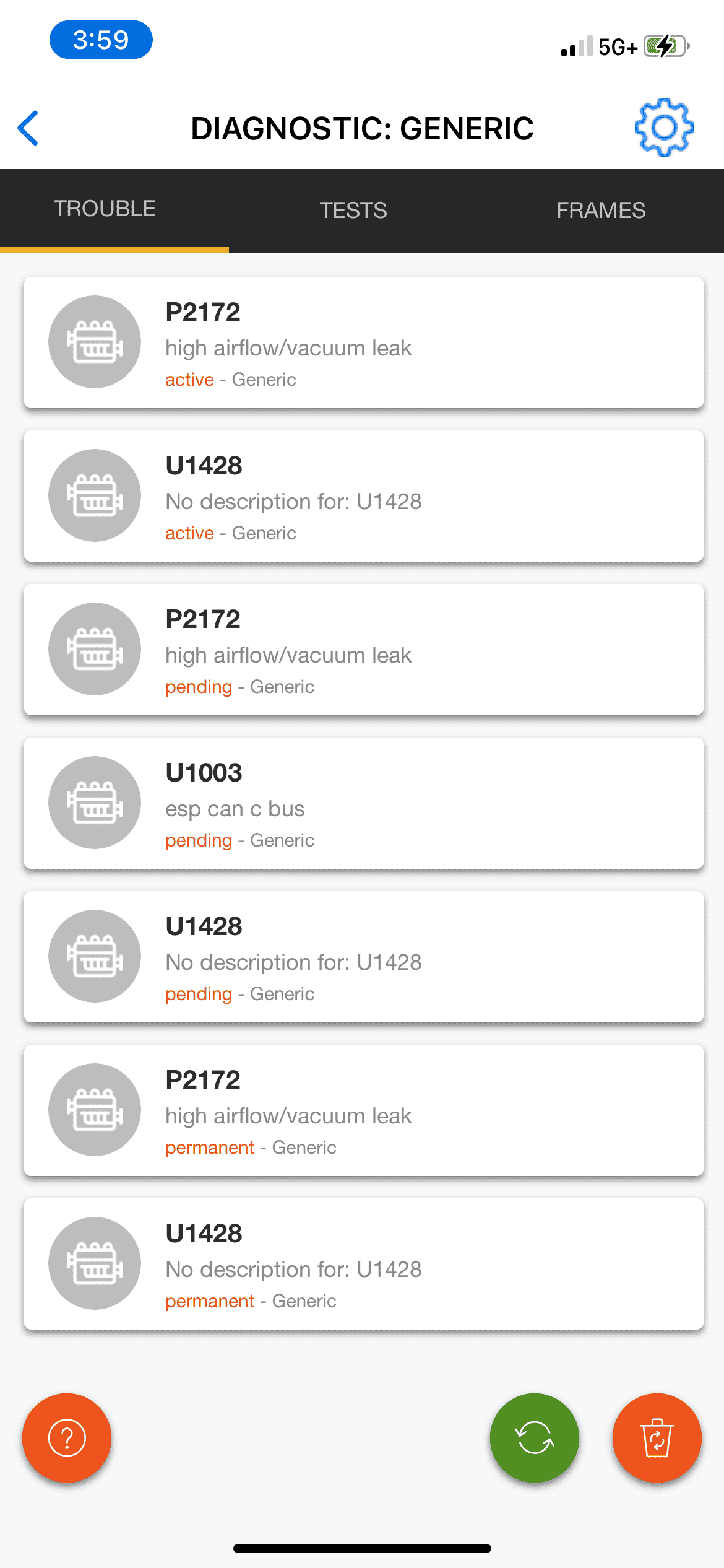

While doing a passing maneuver on the highway, the entire car cut out into limp mode with service electric throttle on the screen.
Check engine, traction light and red charge light all illuminated. After restart limp mode goes away, check engine light remains. The Jeep drives normal. After 3 drive cycles the check engine self resets.
It happened again 50-60 miles later, same results. On the highway passing and cut out. Restart, out of limp mode, 3 drive cycles check engine gone.

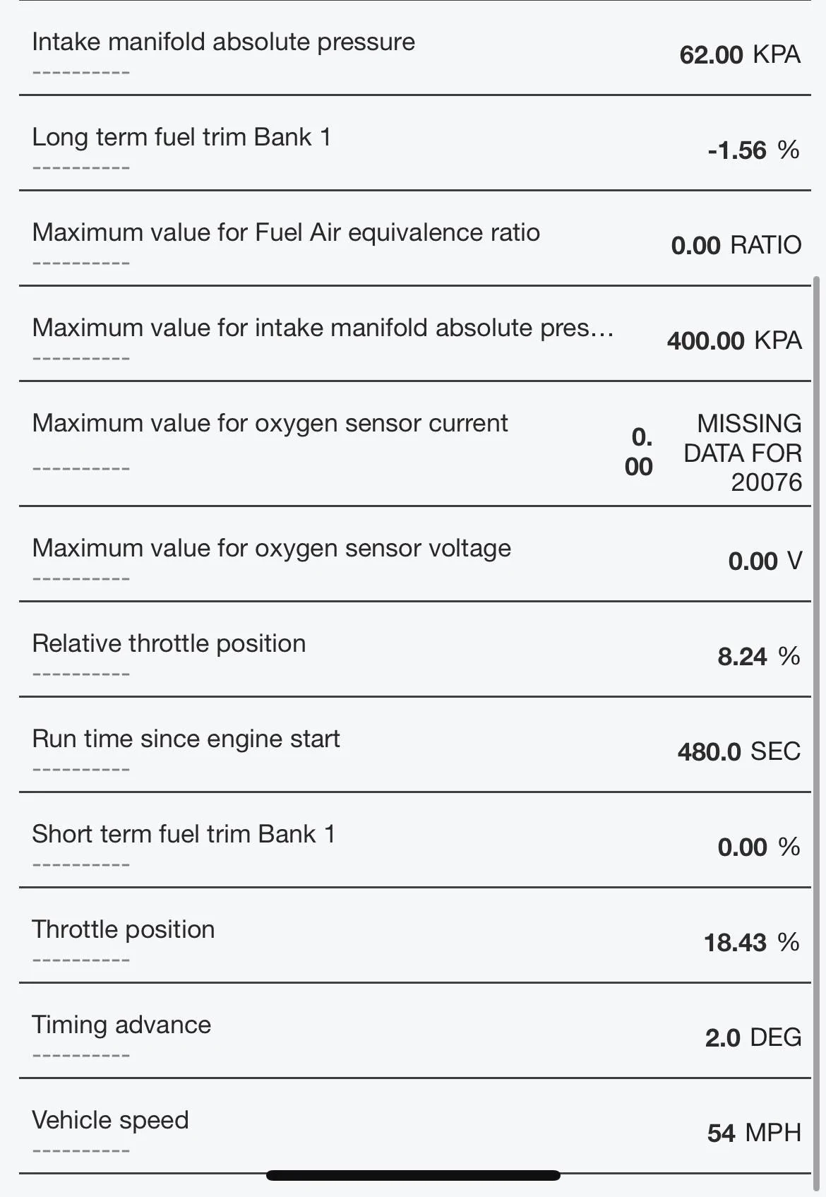

150 miles later, it happened around town. The freeze frame data I attached is for the third incident.

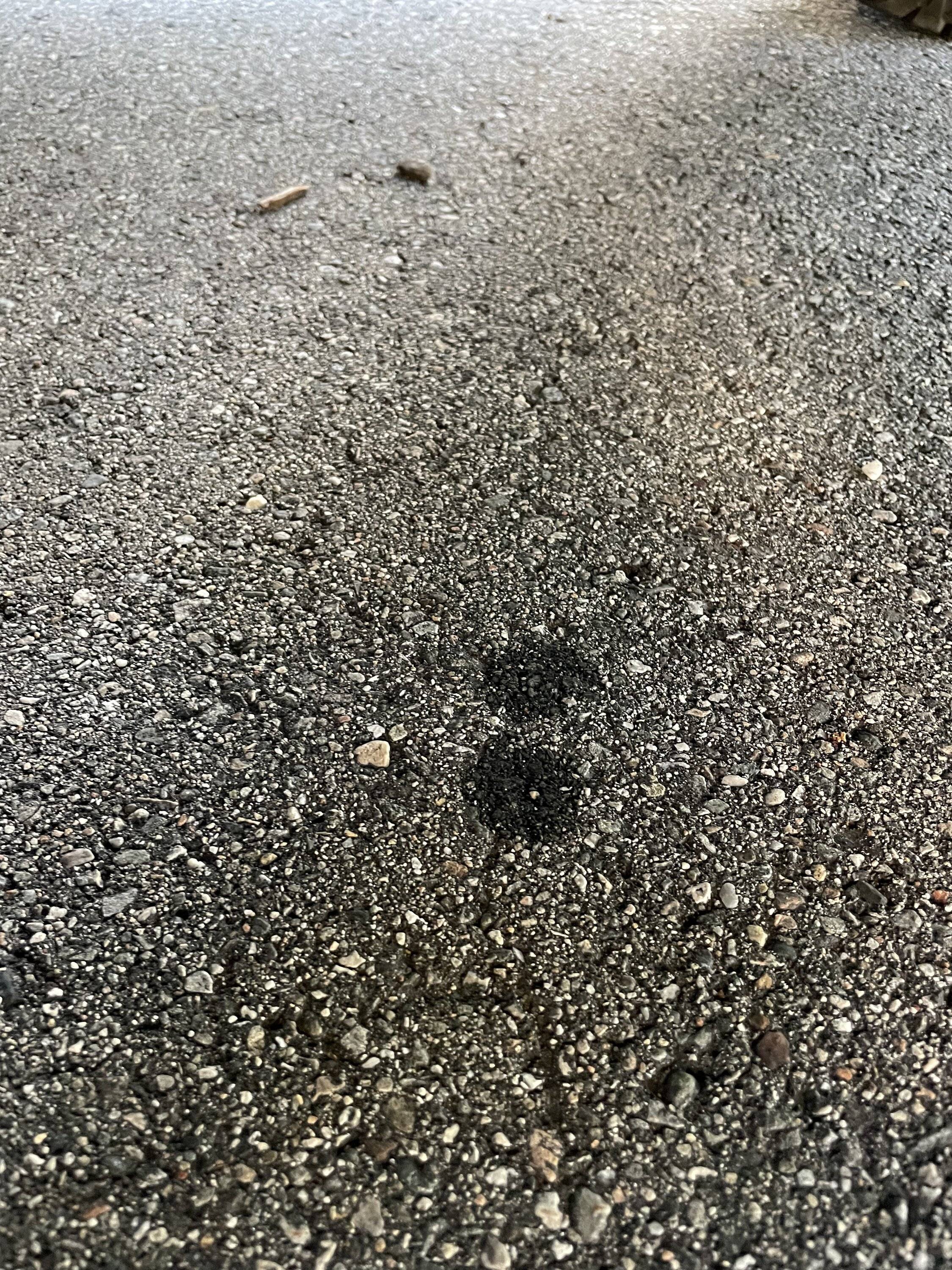

After the incident some leaking oil was spotted again.

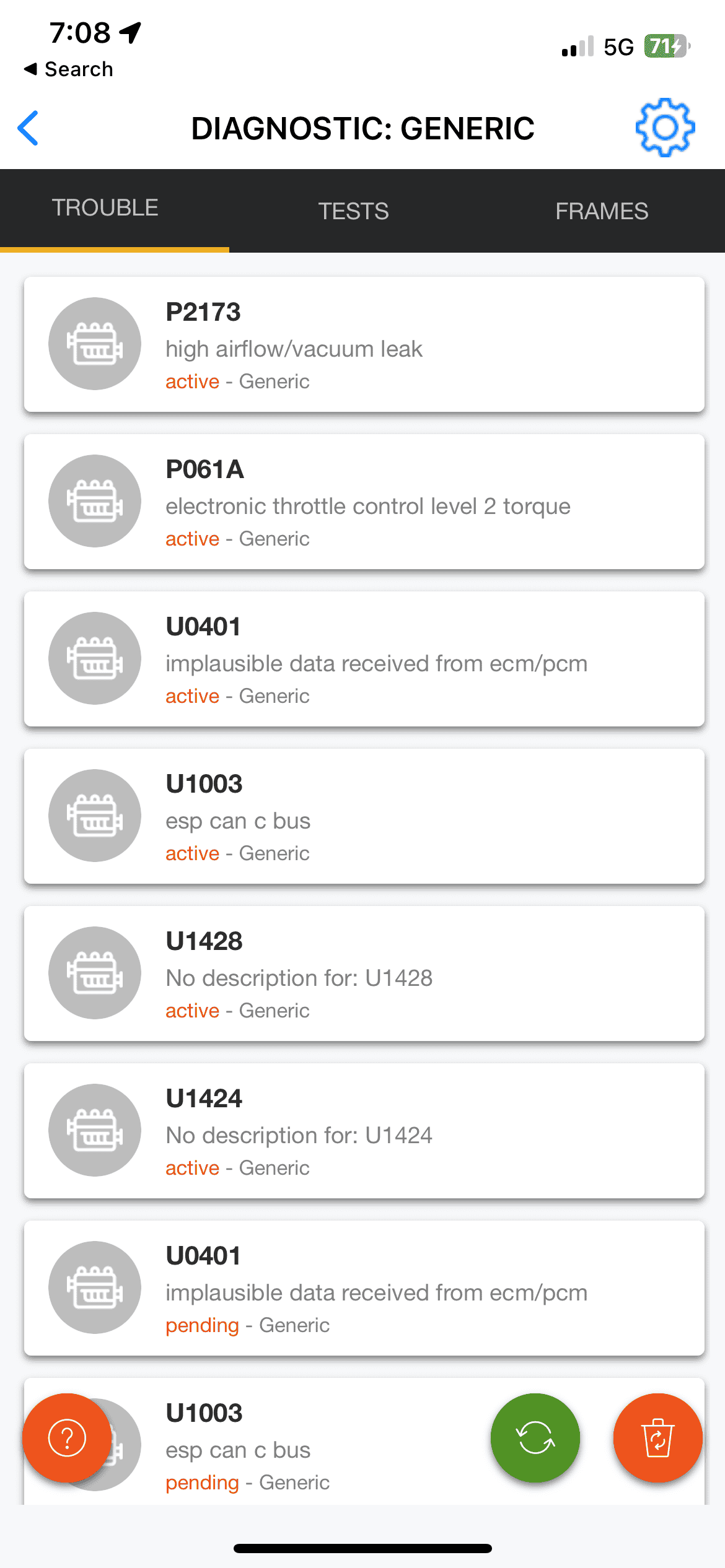

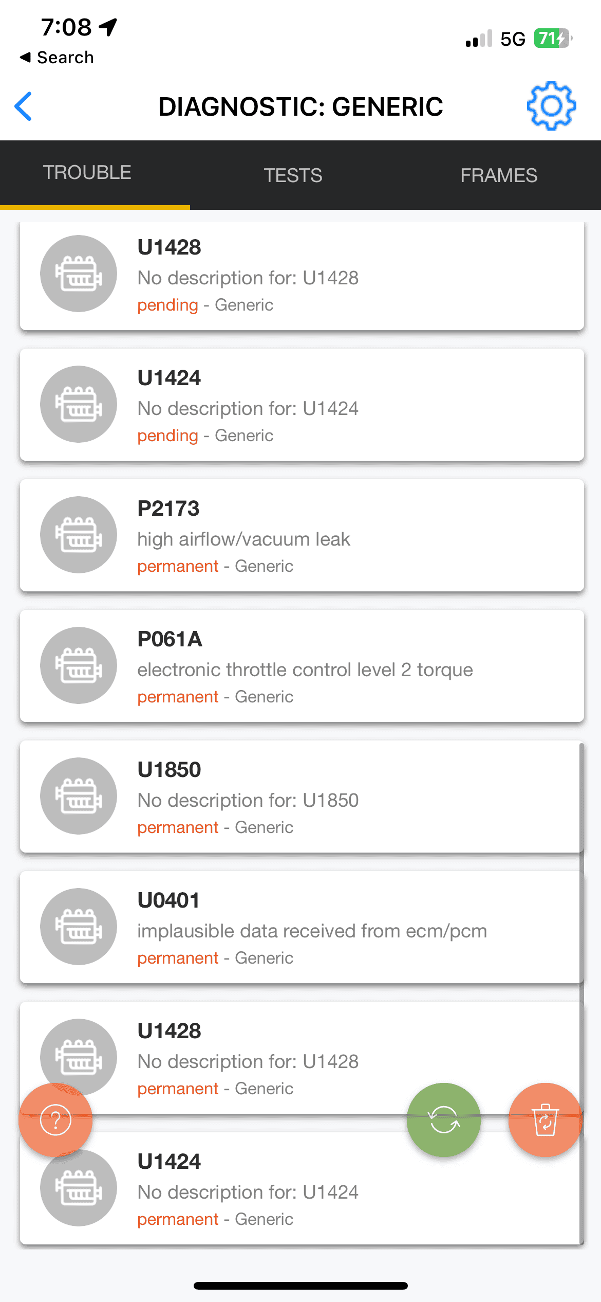

first a P1cea code. Then a p061a code. The p061a is a level 2 torque code which induces limp mode which goes away after a restart.

New pcm in, 300 miles later; constant limp mode. Comes on almost instantly.
