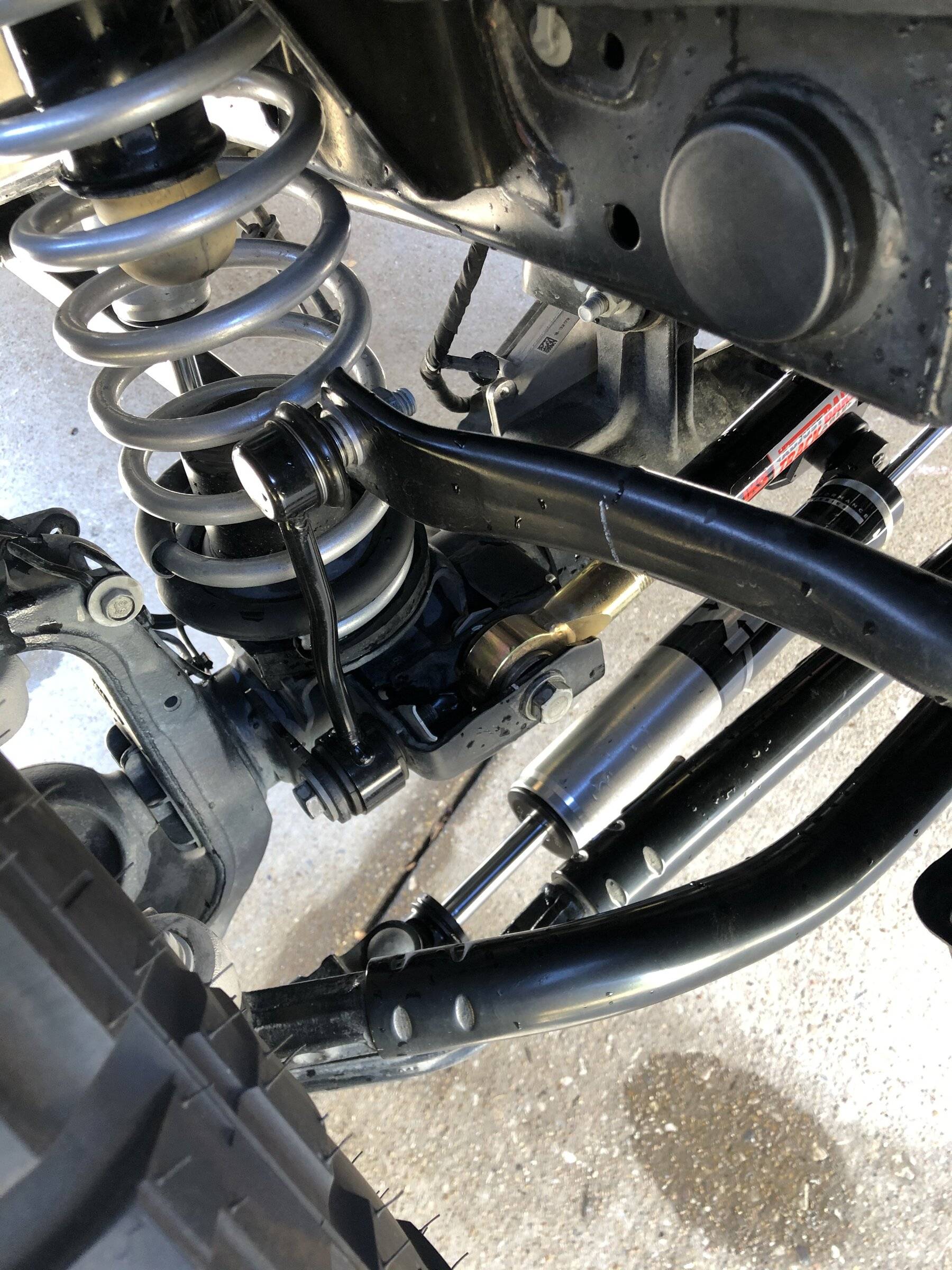

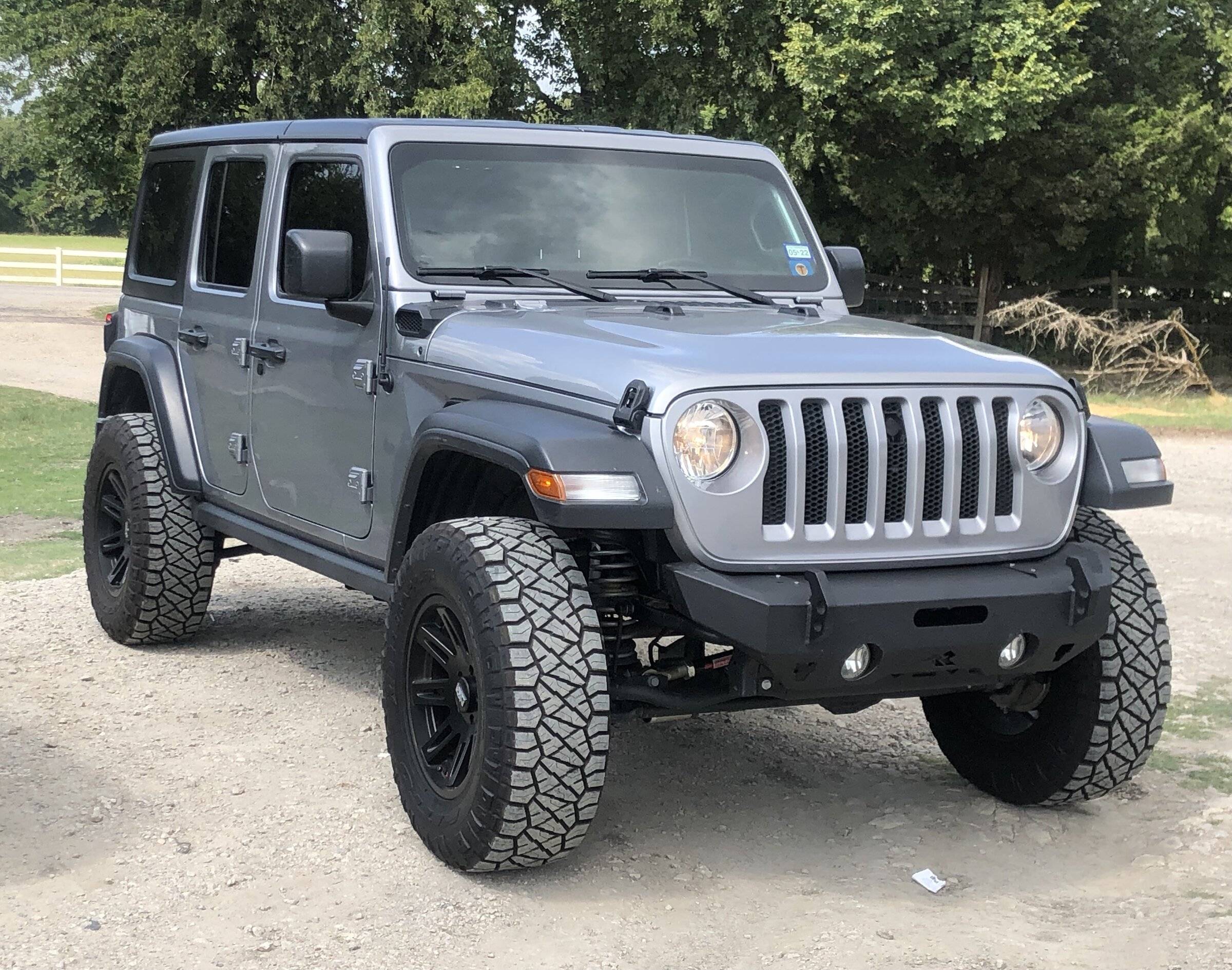

I have them. I have a light Jeep and run the 2” shocks on all four corners with 1/4 spacer on the pass in the rear and .5” spacer the front. I like them because my Jeep is light. I think they would be too soft or need an adjustable shock for a heavy Jeep. Highway they are great. I know a bunch of kits come with Eibach springs but they are rebranded.
Jeep Wrangler JL Anybody use Eibach springs? F61E46BF-053B-4D86-B6F4-0A4EEBCFAE1A
Jeep Wrangler JL Anybody use Eibach springs? 7D9A9384-F54F-4EFB-962B-F6F2E34AE692
