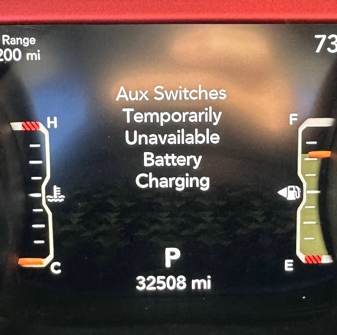

Even after charging periodically I started to get this message consistently after initial start up. But this is only if you have the auxiliary switches. I change the batteries preemptively in our vehicles, typically every 3-4 years. The Jeep was sooner.
