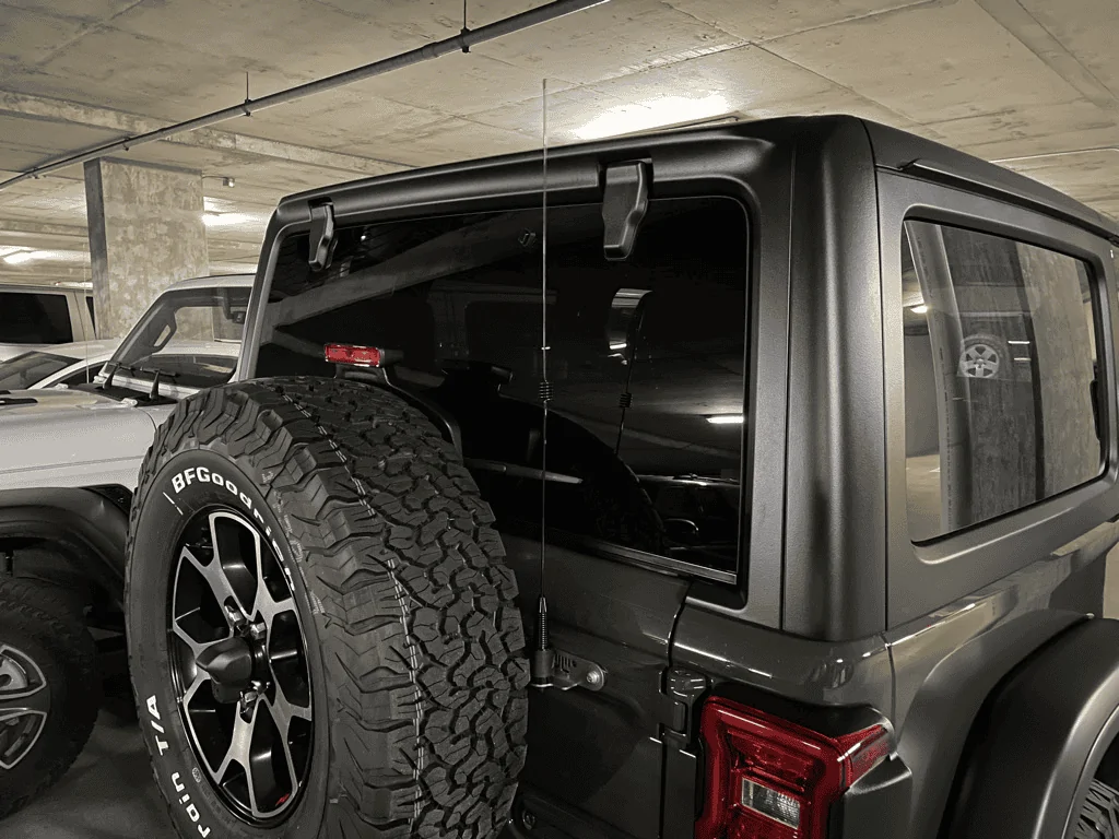

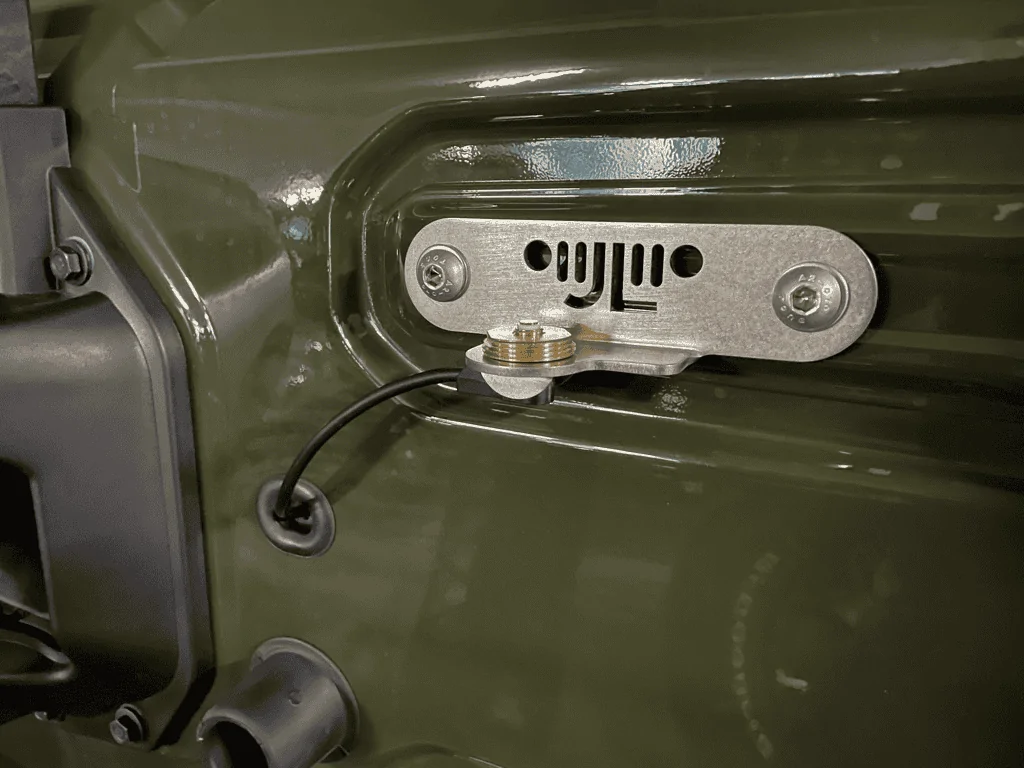

I mounted my GMRS to the tailgate so that it's out of the way, and it works great.
Jeep Wrangler JL Antenna 1715735983011-s5
Jeep Wrangler JL Antenna 1715736483025-pr
