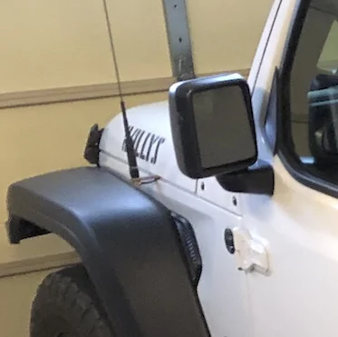

I made a mount by bending some 3/32" strap steel (I would get some stainless next time) and using one of the body bolts just inside the hood to mount it. This position gives the advantage of easy routing through the firewall plug underneath the power brake assist. It also has the advantage of making your hood a ground plane for the antenna. Sorry about the crappy photo. Apparently I didn't document my build.

I made a mount by bending some 3/16" strap steel (I would get some stainless next time) and using one of the body bolts just inside the hood to mount it. This position gives the advantage of easy routing through the firewall plug underneath the power brake assist. It also has the advantage of making your hood a ground plane for the antenna. Sorry about the crappy photo. Apparently I didn't document my build.
This is a popular location & there are many aftermarket brackets to go here, or a little further back where the two cowl bolts are.
That or the rear tire carrier area are the two most popular antenna mount locations - lots of aftermarket brackets there too.
