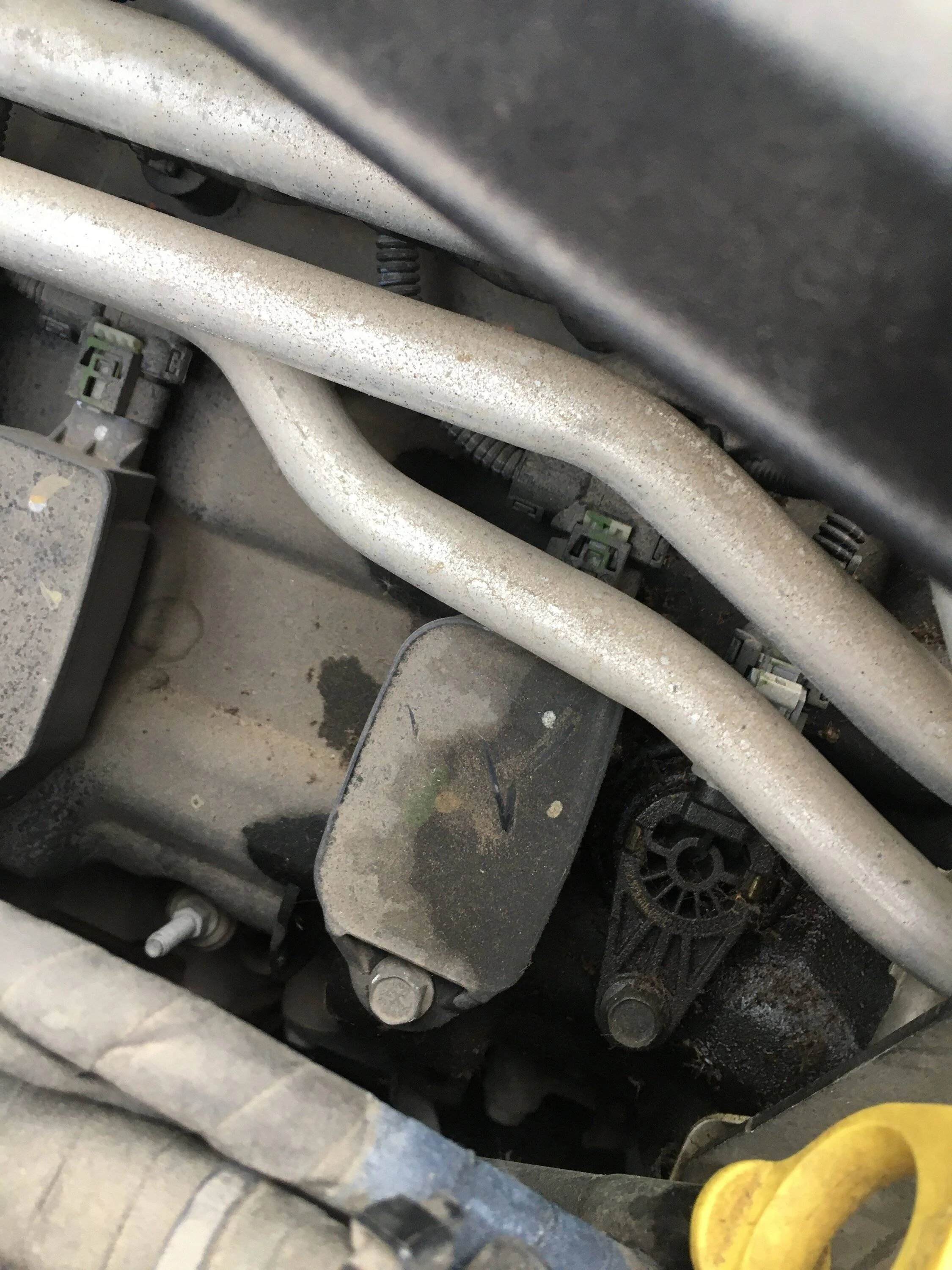

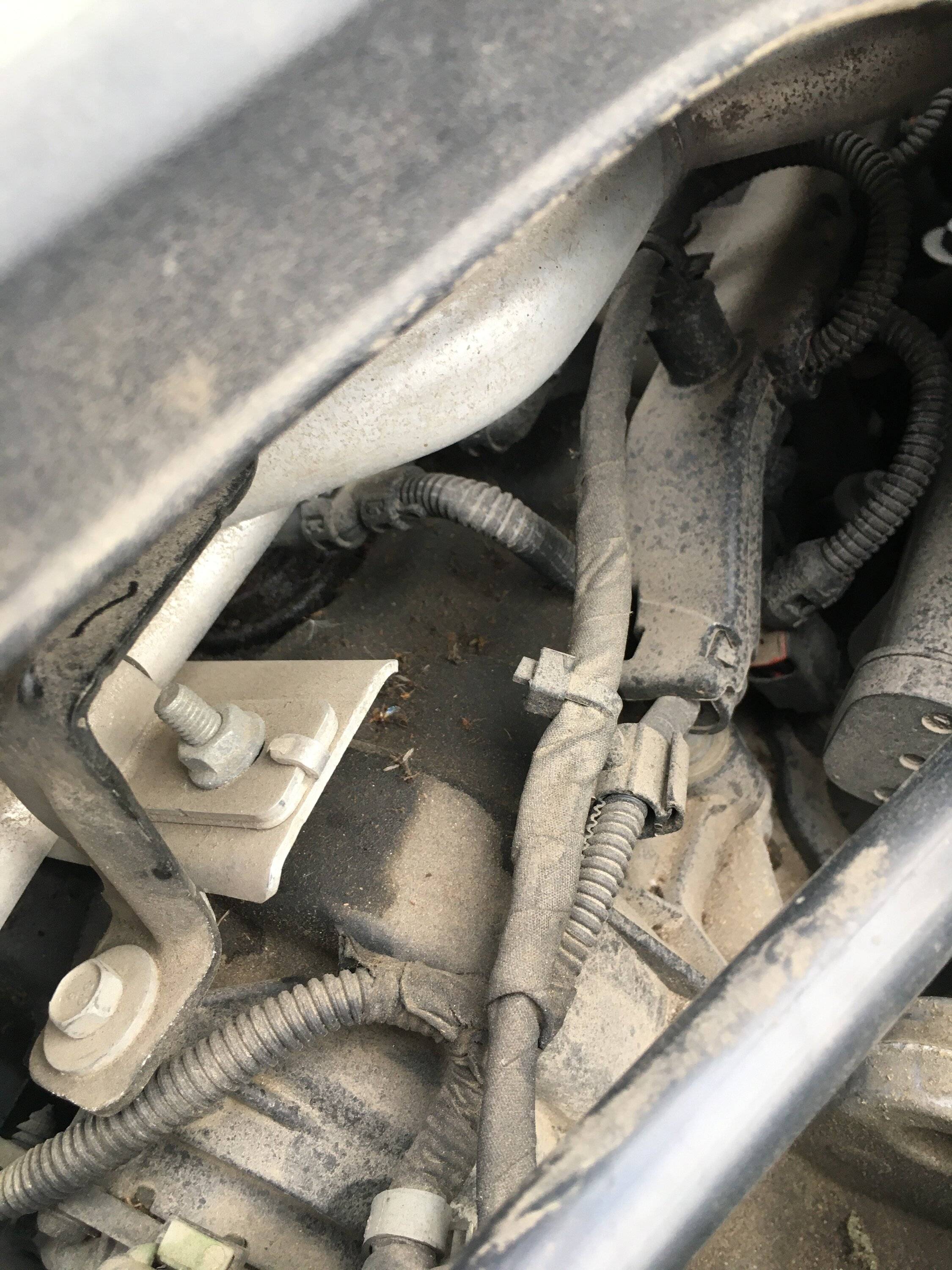

Hello,
Noticed this tonight when taking pictures of my alternator for a potential rebuild, it’s on the passenger side near the spark plugs, what is that beside the coil?

On a Honda, I would say it is a spark plug tube seal. Have you pulled the coil off of the plug to see if the tube is full of oil? I had some go bad on my civic and I had to pull the valve cover because the seal is on the bottom side of the cover. When I started it after the repair, it made quite the smoke cloud for a few seconds. :)

Turns out to be the VVT. a good post was suggested once I posted, https://www.jlwranglerforums.com/forum/threads/valve-cover-oil-leak.45262/
