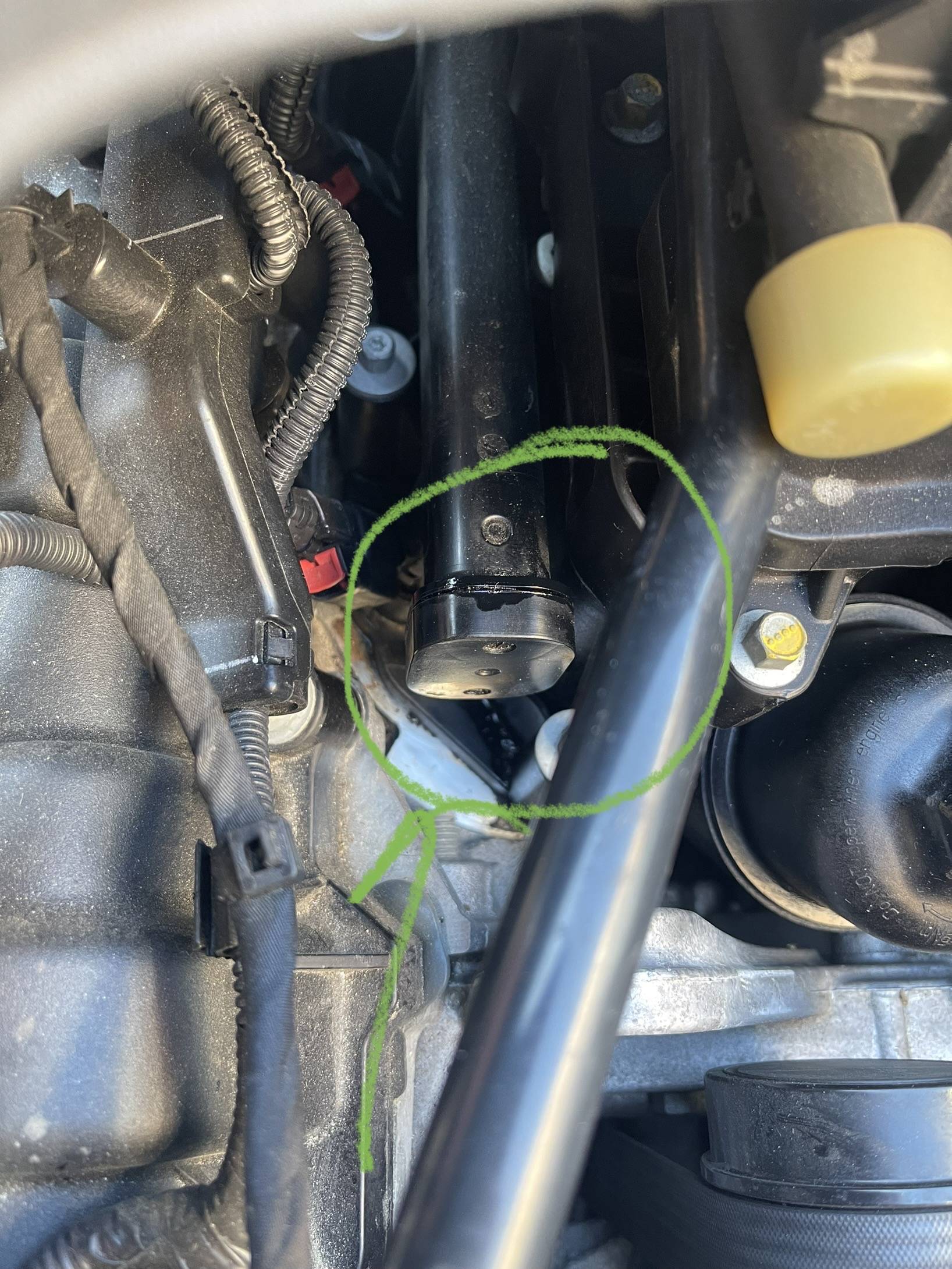

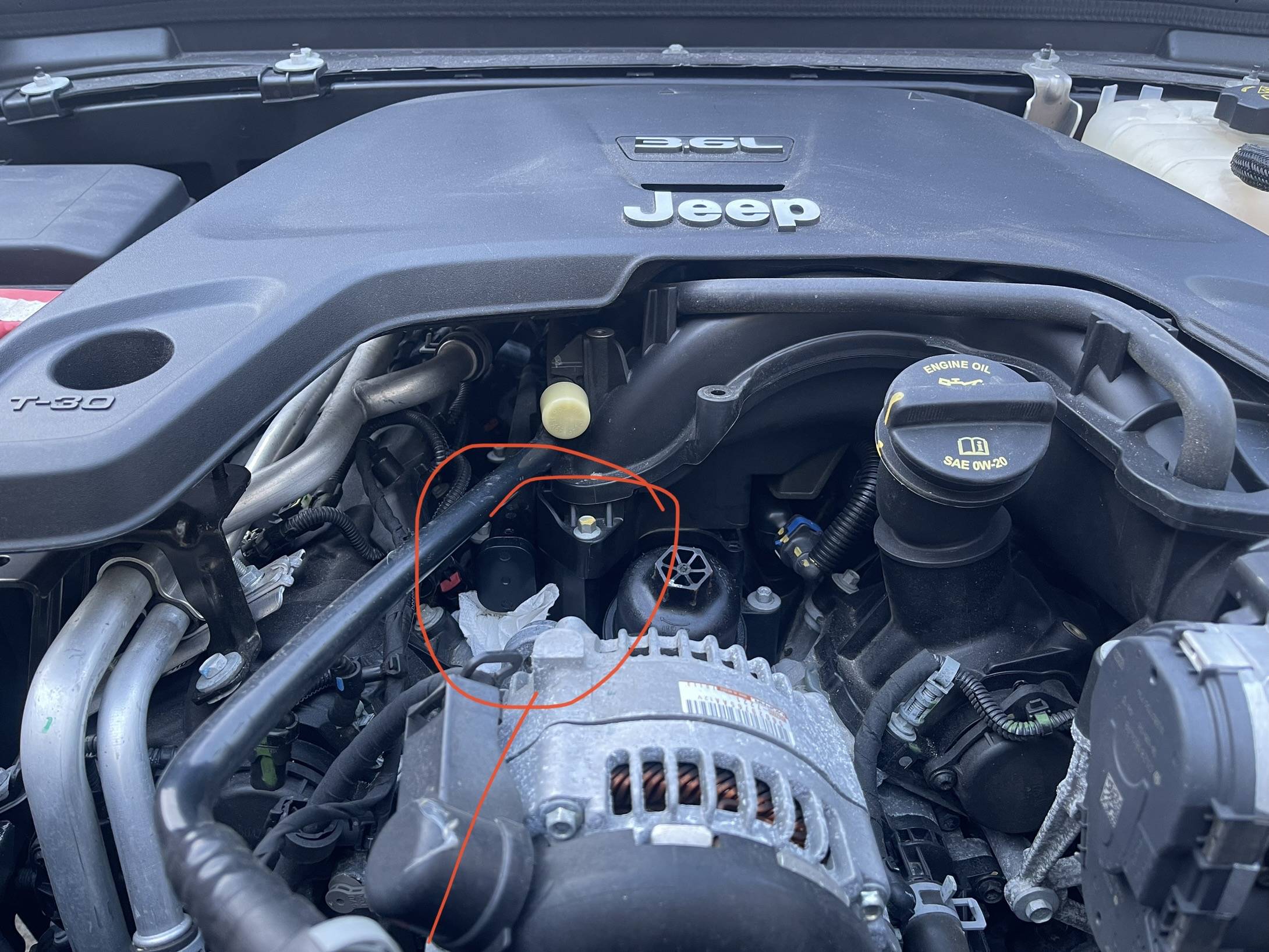

I noticed a small leak (oil) and just trying to figure out what it is that’s leaking.
Jeep Wrangler JL Oil leak IMG_6481
Jeep Wrangler JL Oil leak IMG_6483

That’s the fuel rail

Get a paper towel and wipe off the residue and use your nose and see what it is. If it’s Gas, get it fixed ASAP. If it is oil it may be just a drop from an oil change might be my guess.

you are correct... its fuel.
I just did an oil change and filled it will gas as i was supposed to head to SC from Ohio on Wed.

so how bad is this from a repair standpoint? I can’t get it to my repair facility til Friday
There's only 4 bolts that hold the rail on both sides. Looks like about $300 from Mopar. Almost looks like that end is screwed on with a gasket but they don't list separate parts for it.

Well 1296.01… fuel rail is not covered under my remaining powertrain warranty
