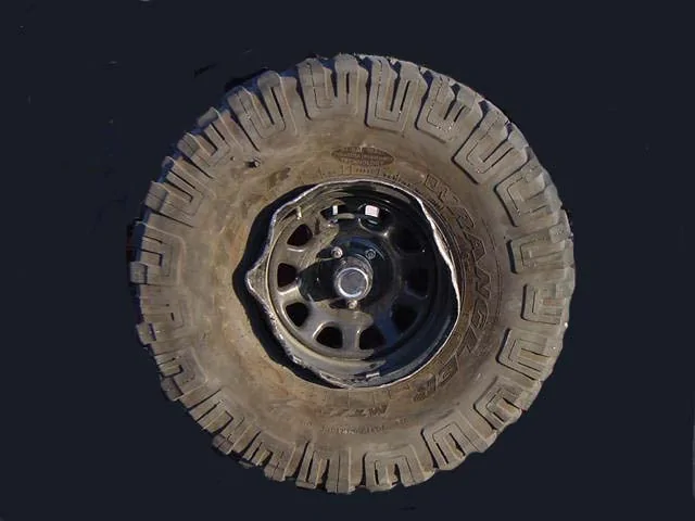

remember the flares are lower on sports than on rubicons and new model willys. on my stock rubicon with 255/85-17 (35x10 and taller than 315/70's)on stock wheels I needed 1" wheel spacers to get the extra clearance at the rear..and rubicons have wider axles so that is something to think about. also the something to think about but would not be an issue for me but it is for others..the 315/70-17 is E rated and a couple lbs heavier than the 35x12.5-17 which is D rated. Oh and I always think of this when people say they can pound their steel wheels straight on the trail..in all my years I have not broken a cast wheel..not that it can't happen most good offroad tires do a good job of protecting them.
