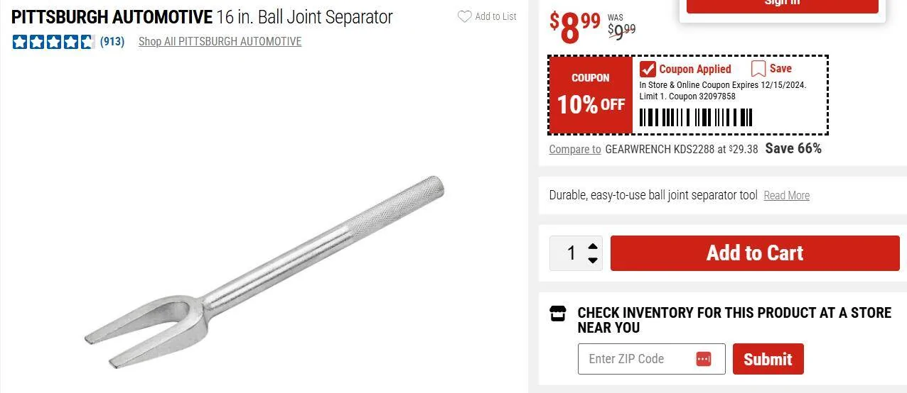

I read all the guides on here and the other forums about how its impossible for a drag link to be the cause of the death wobble, and how some people claim it can be. I'm here to add my 2c to the argument and say that it definitely can. after fighting the pitman arm for a few hours, it was out. My solution to popping it out is a 4lb sledgehammer, and this 10$ tool from Harbor Freight.
Jeep Wrangler JL Another JLU Death Wobble Case 1734212169053-y1
I went at it from the drivers side with the wheel turned all the way left for a few hours before I realized that I'm braindead. If you go at it from that side, the fork end of the separator is impacting the ball joint arm and won't go all the way in. The trick is with the wheel almost all the way left, go at it from the front left side of the bumper, almost where the fog lights are, it'll give you the right angle to get it all the way in. 10 hits later it was out.
