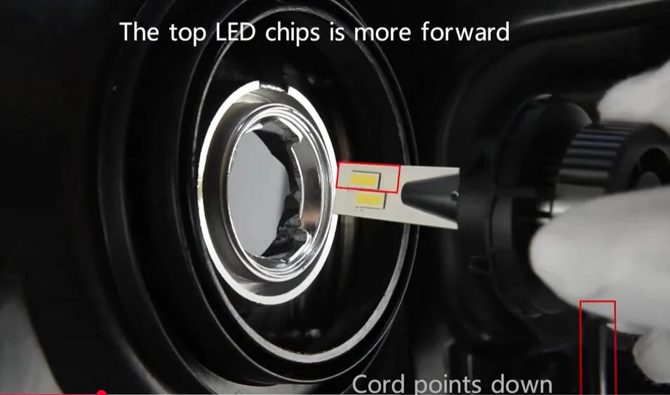

Three possibilities:
1. You're using LED bulbs with poorly designed wick positions that scatter when they're mounted in the reflector
2. You've mounted them backwards or, the correct way to mount them I post a picture.
3. you need to adjust the height of the headlight assembly after installation to aim the headlight
That's great. Thank you. I'll go tomorrow and check if it was installed properly. also, you mention adjusting the height of the headlight assembly. What exactly do you mean? Screwing the top screws less?
There are bolts inside the headlight assembly to adjust the height of the headlight assembly, you can check this tomorrow in the meantime (or ask that mechanic)
Perhaps this video will give you a clearer idea of this. I hope it can help you!

I upgraded our 2021 JL Sport to Led bulb replacements. No problems . Be sure the LED emitters are pointed at 3 and 9 o'clock. Led fog lights took some time to swap. Variety of plastic bits for fog bulb access. The headlights were easy.

Success (I think). We reinstalled the bulbs which were originally installed the wrong way and lowered the beam using the adjustment screw hole. It isn't dark yet but in his garage we set it up and it looks like it works as discussed. Yay!
