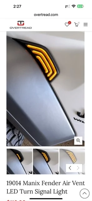

So I purchased the Overtread "19014 Manix Fender Air Vent LED turn signal light".

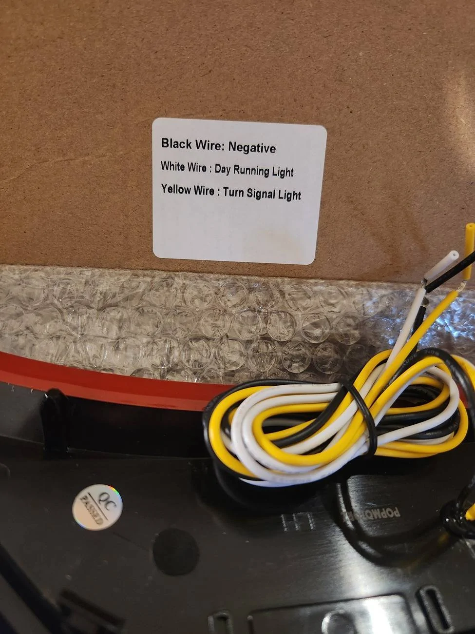

Did you ever figure it out? I'll be hooking them up soon, I'm guessing red is DRL/+, black is GND/- and yellow is Turn Signal/+?

I bought a different brand from amazon but here ya go...

Thanks!!, that seems to jive with what I was thinking, sure would have been helpful if mine came with a label like that...lol
