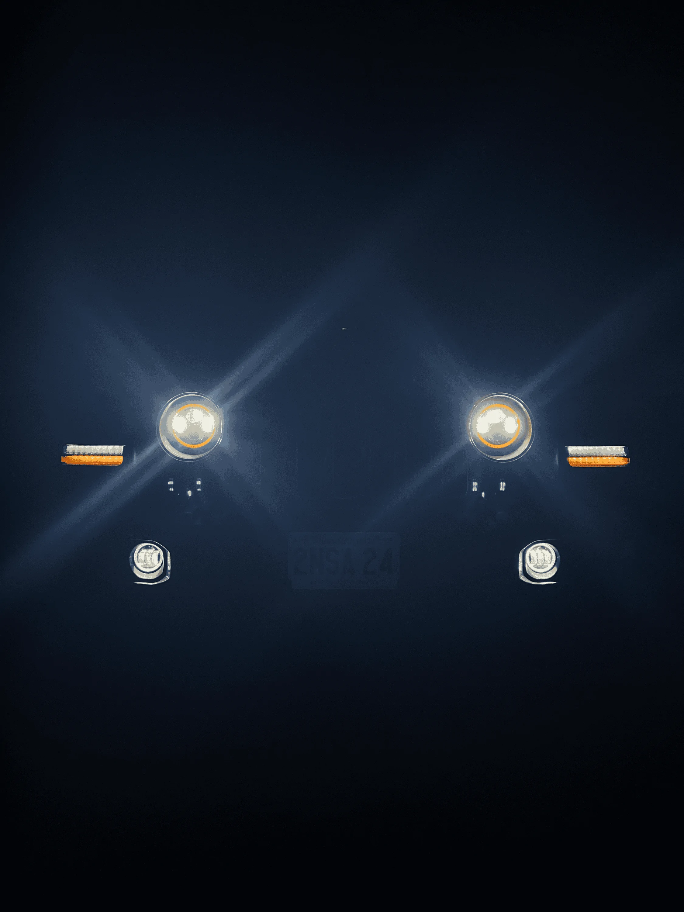

I have a 2018 Sahara Unlimited JL. I bought it without the LED light package so it came with Halogens. I've recently upgraded to all LEDs and have run into a problem. When the lights are off, the turn signals work perfect. When I switch the lights on, all the lights come on (including the turn signal amber light) and stay on. The turn signal won't blink, it'll just constant. I've attached the videos. I'll also include the links the all the lights I bought. I think I could have messed up the wiring. I brought it to Jeep and they tried to program it and had no luck. They didn't even want to take it apart to see the wiring.
The HALO headlights plugged right into where the halogen lights plugged in. The HALOs included a red and yellow wire (link below) that is suppose to sync with the blinker lights. I tried to follow their installation guide, but they never showed how to wire tap them into the turn signal wires.

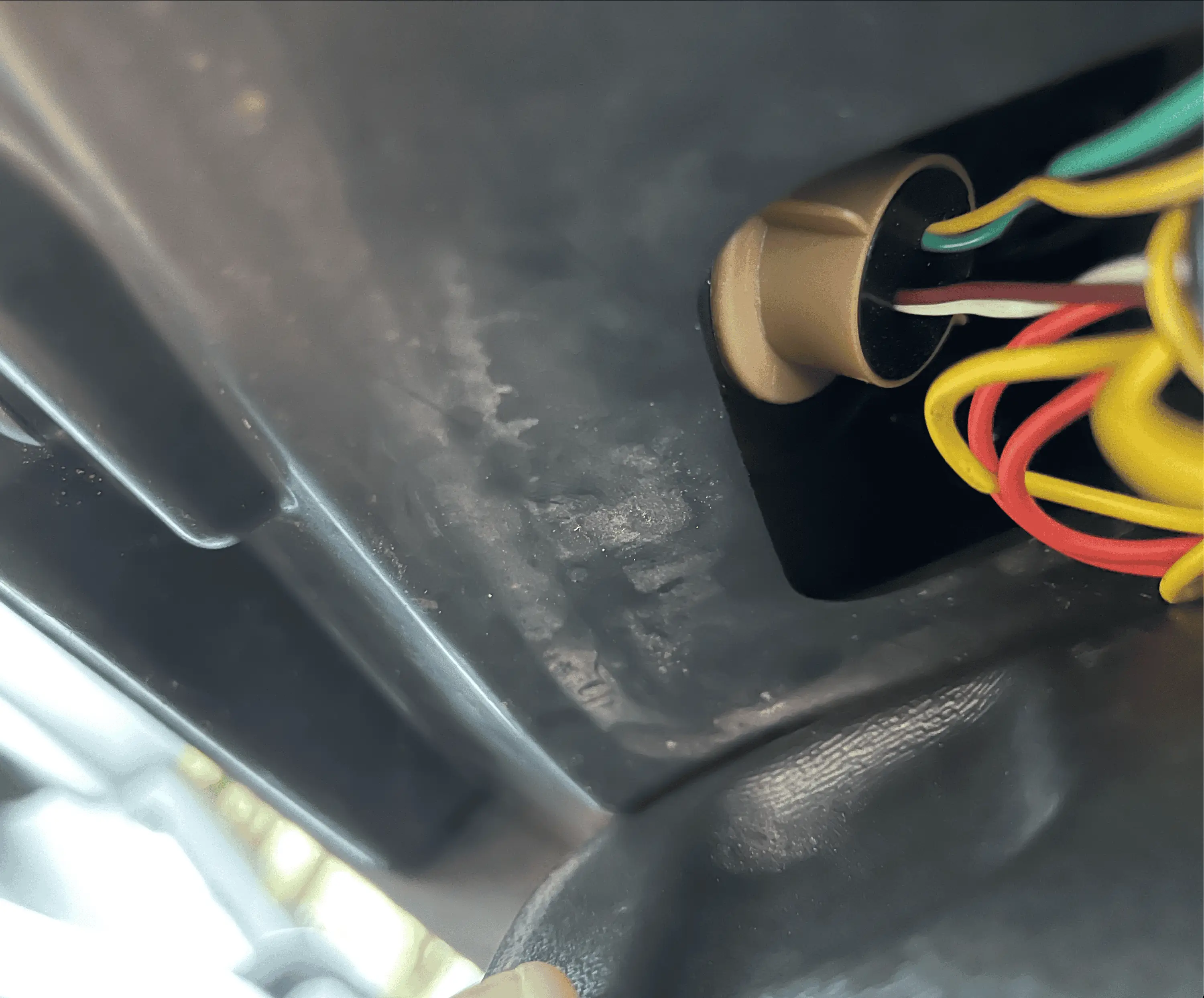

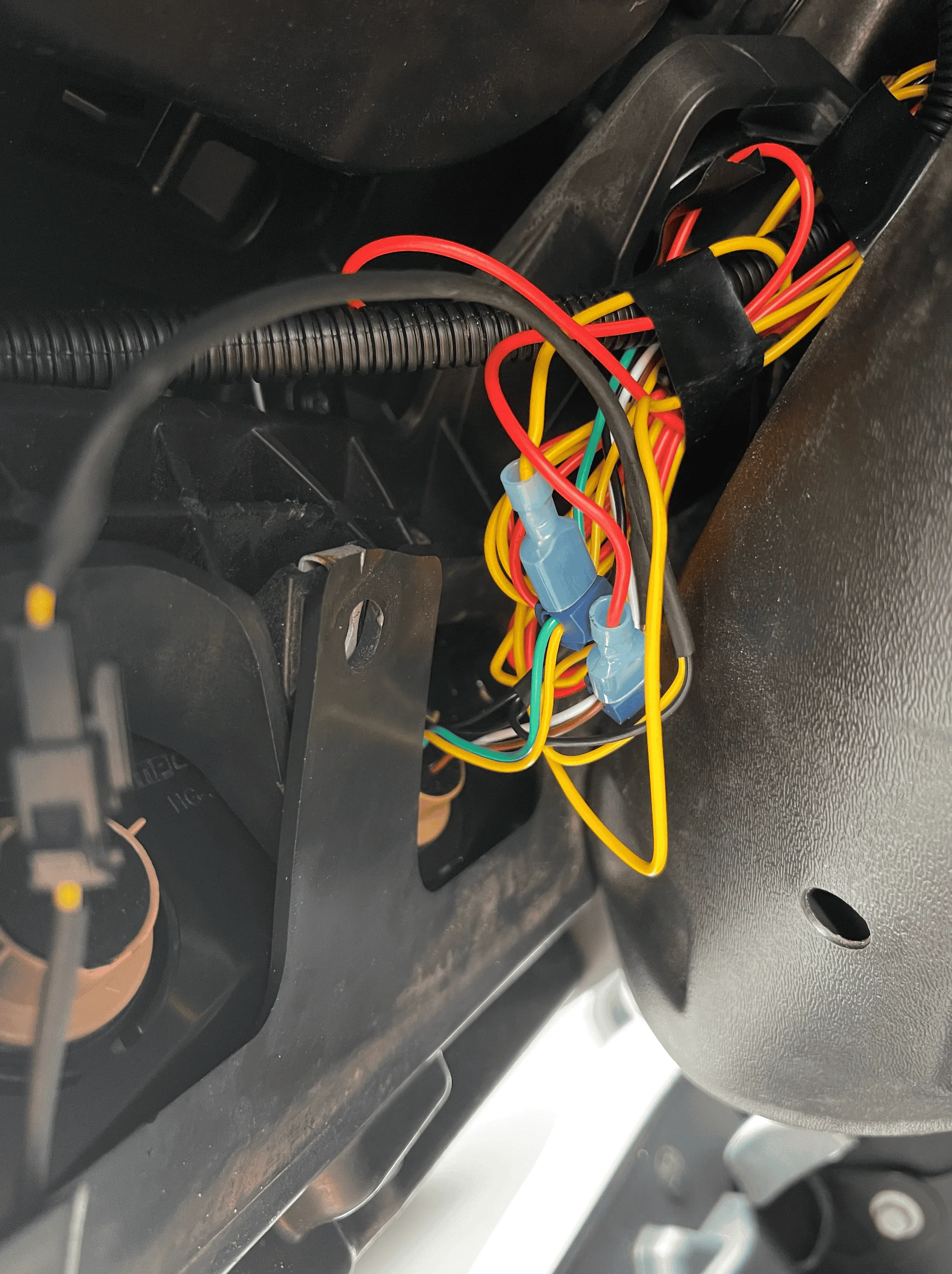

(UPDATE) I disconnected the HALOs from the turn signal by removing the t-tap connectors and the blinkers now work with and without the lights on. I've included new pictures on how it was wired. Not sure why I paired the wires I paired, but it was definitely wrong. When I still had the t-tap connector on and the HALOs weren't connected, the lights still didn't work. So the problem was the t-tap connecting the yellow and green wire, and the white and brown wire. So that being said, does anyone know what wires from the turn signal (yellow, green, brown, white) connect to the HALO wires (red, yellow)?

Why are you tapping into two wires on each?
You should only have to tap into 1. Green is usually ground so you don't want that. I have the same turn signals, I would check the instructions, it might tell you which is turn and which is parking lights.

Definitely could have been avoided if I knew what I was doing. I finally got everything to work as expected by connecting the HALOs yellow wire to the turn signals green wire, and the HALOs red wire to the brown. I tried yellow to yellow first, but had no luck.
