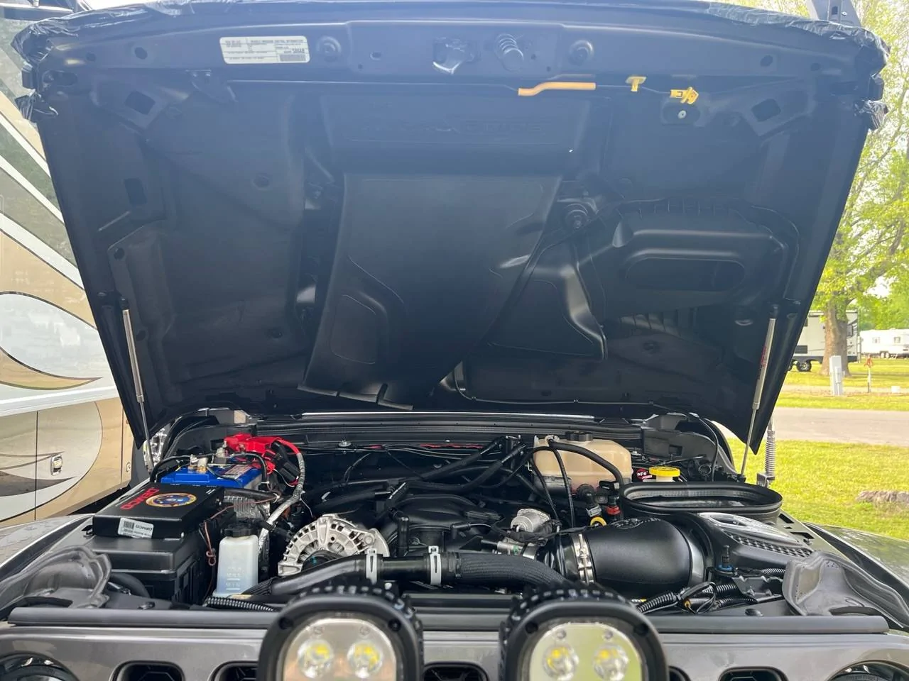

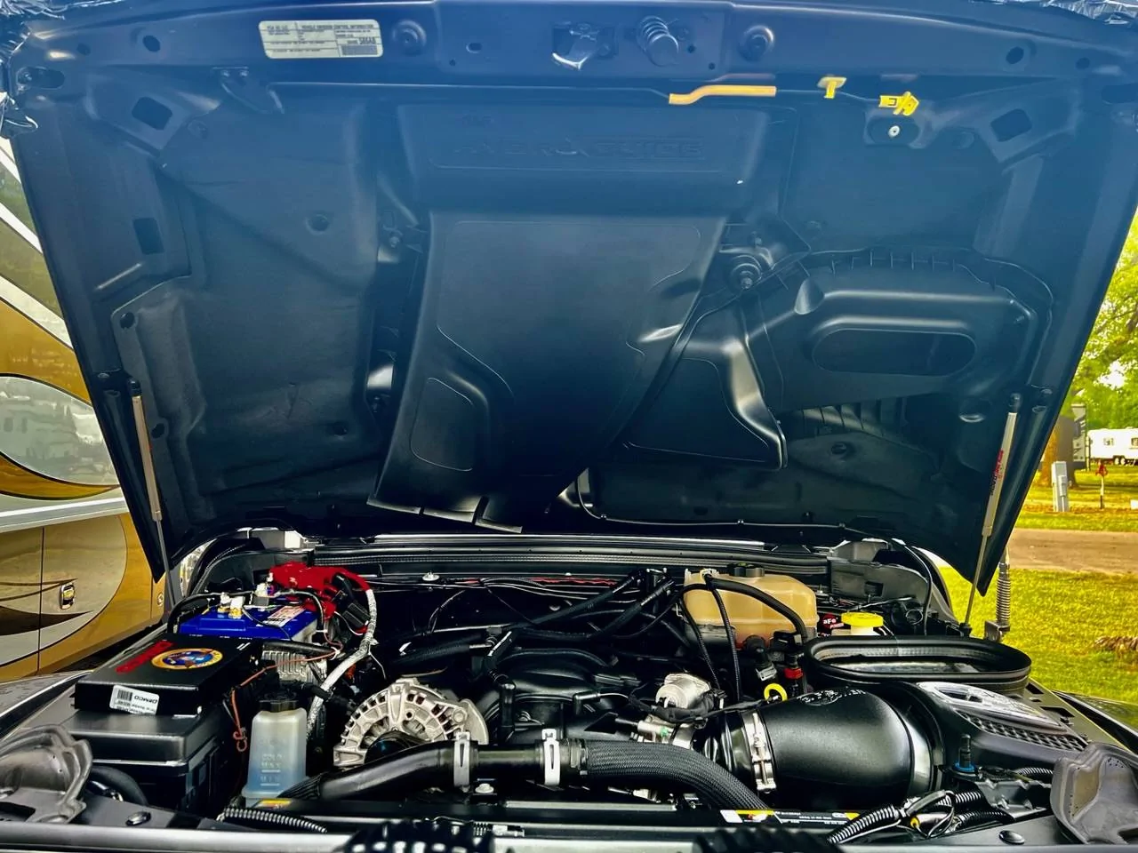

Hi Everyone! I was hoping to get some pictures on where you all mounted your Air Force 1 brake box. The engine bay is so different than my other JL. Thanks I’m advance!

Here’s one option for consideration:
As seen in the attached photographs, my unit is affixed to the fuse box cover forward of the battery mount.
I quickly drilled a few pilot holes in the cover for ZIP TIES that secure the box in place.
Be sure to seal the pilot holes with caulk if you select this option (sealant is recommended to prevent water intrusion during river crossings).
