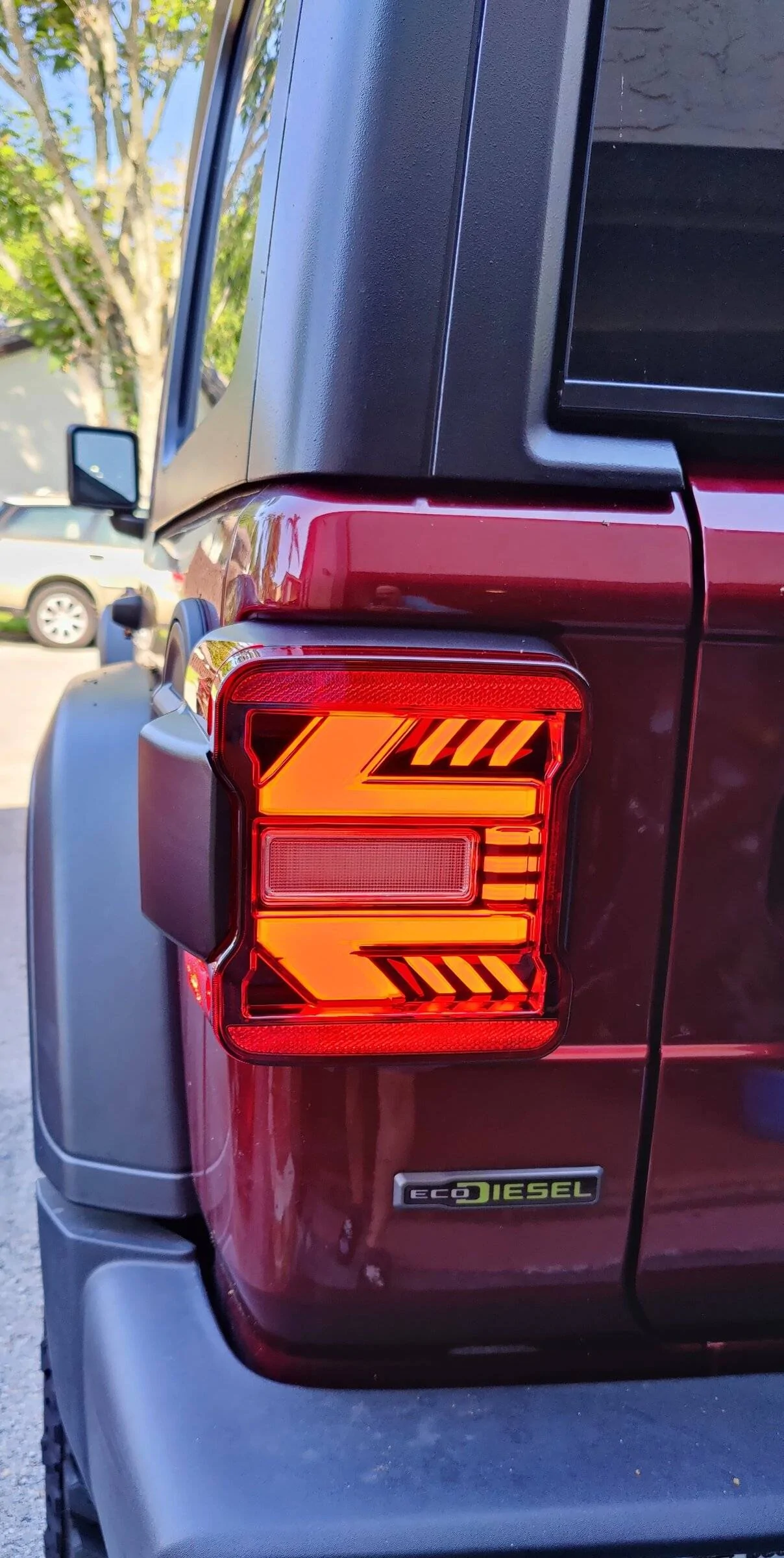

Just got a new set of Sealight LED tail lights in today. They look great and seem to be working fine, but I'm getting a warning on the dash that the turn signals are out. The lights are supposed to be plug and play. Anyone know what it might be? They have a toggle switch on the back but I'm not sure what it does. It doesn't seem to matter what position it's in.

Interesting about the toggle switch, my smoked OEM knockoffs use an inline resistor and have no lights-out warnings.

I think I may need to add those. I've messed with the toggle switch and it appears to do nothing. I'll try ordering some resistors and give that a shot. Did yours come with that bracket? Looks like a perfect fit.
Yeah, the lights came w/ the resistor & bracket, and it did work pretty well clipped where it is :)
