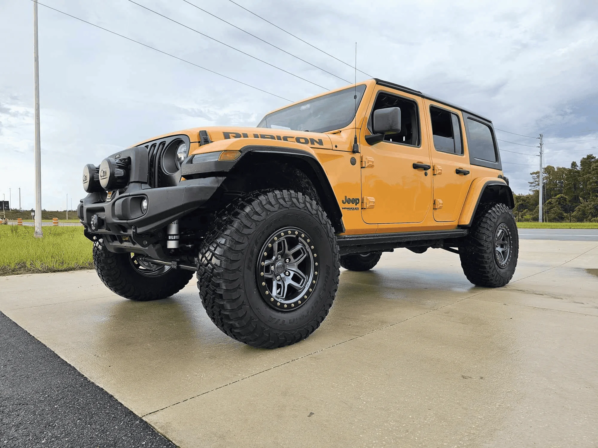

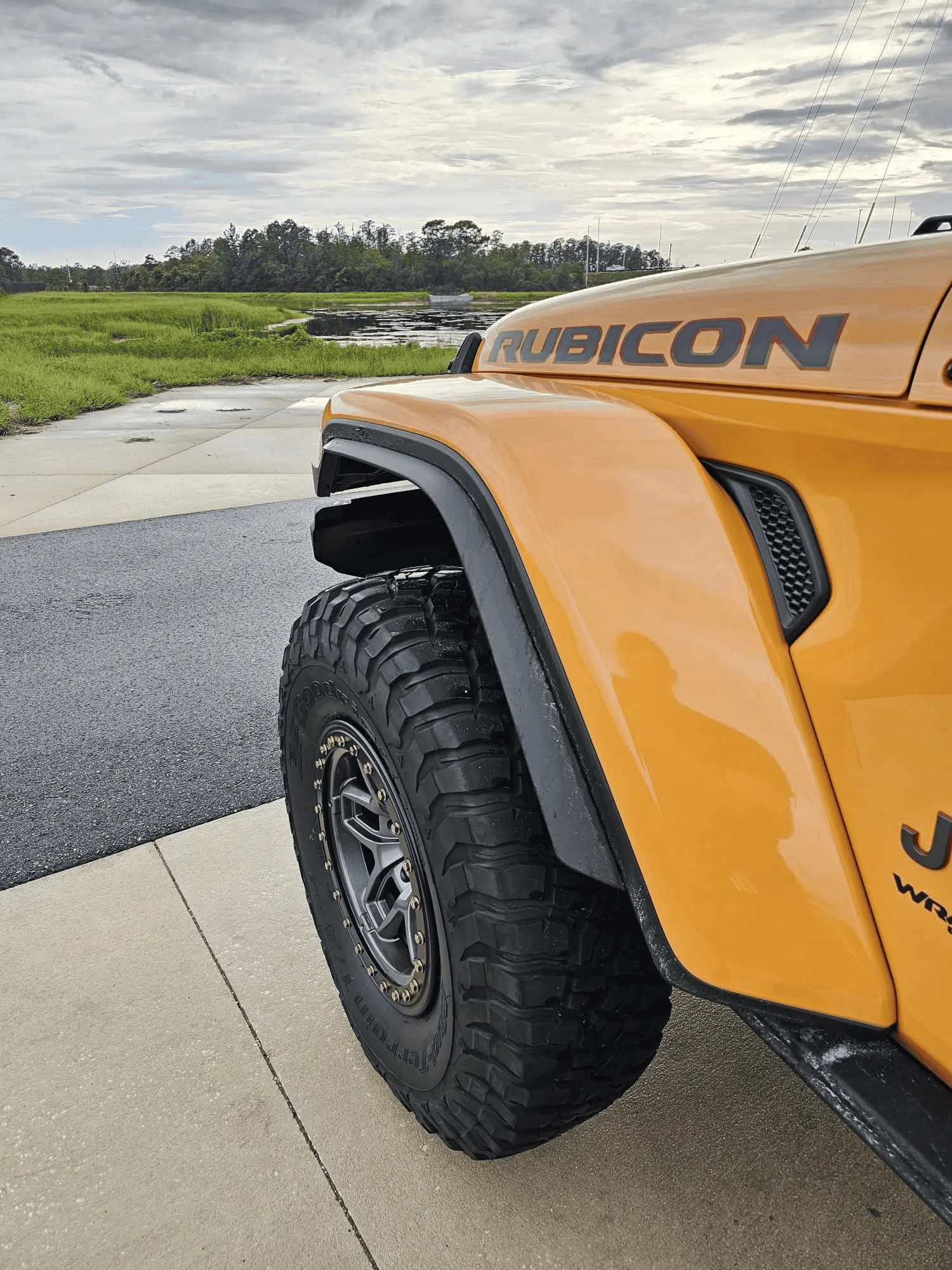

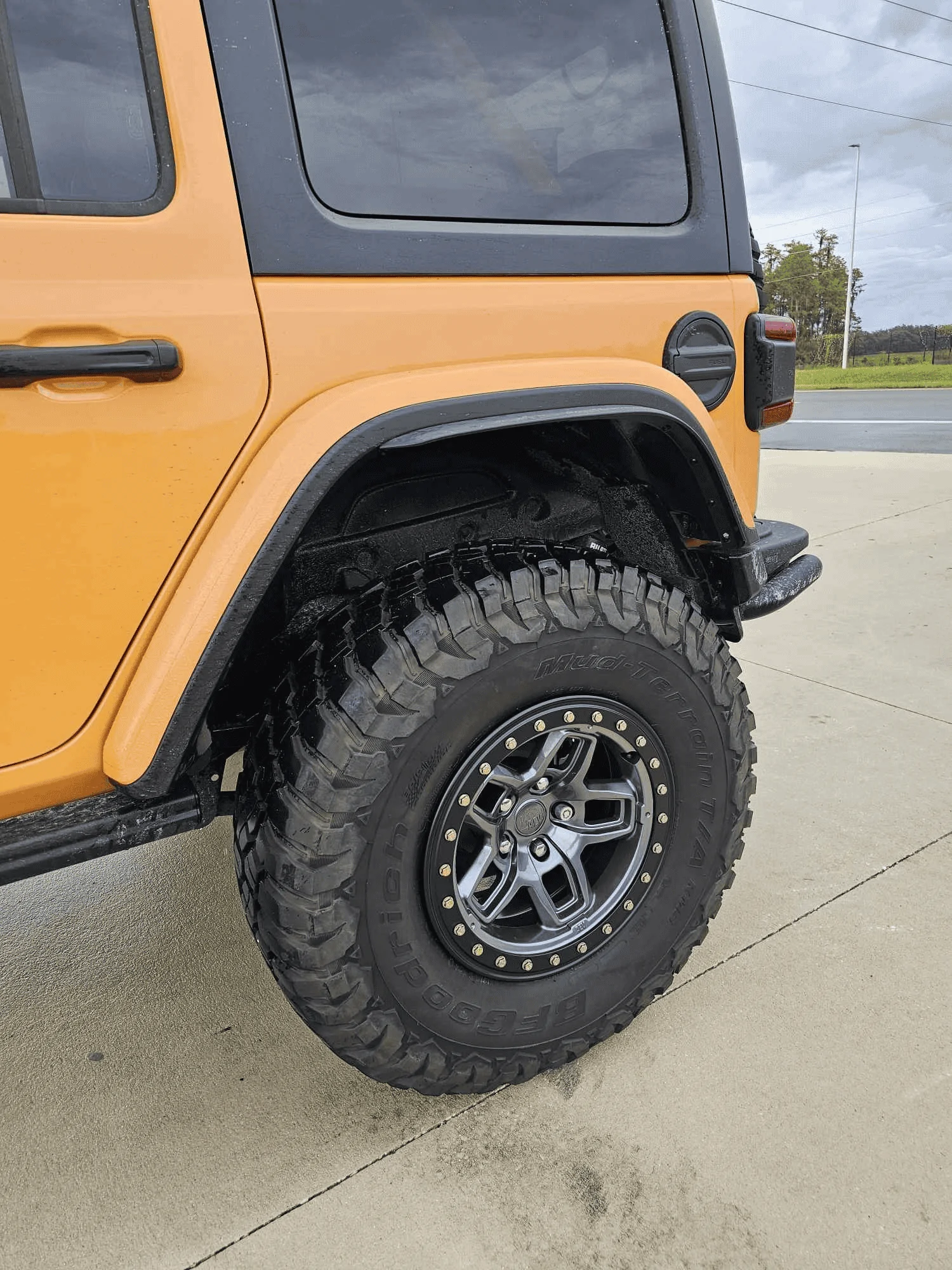

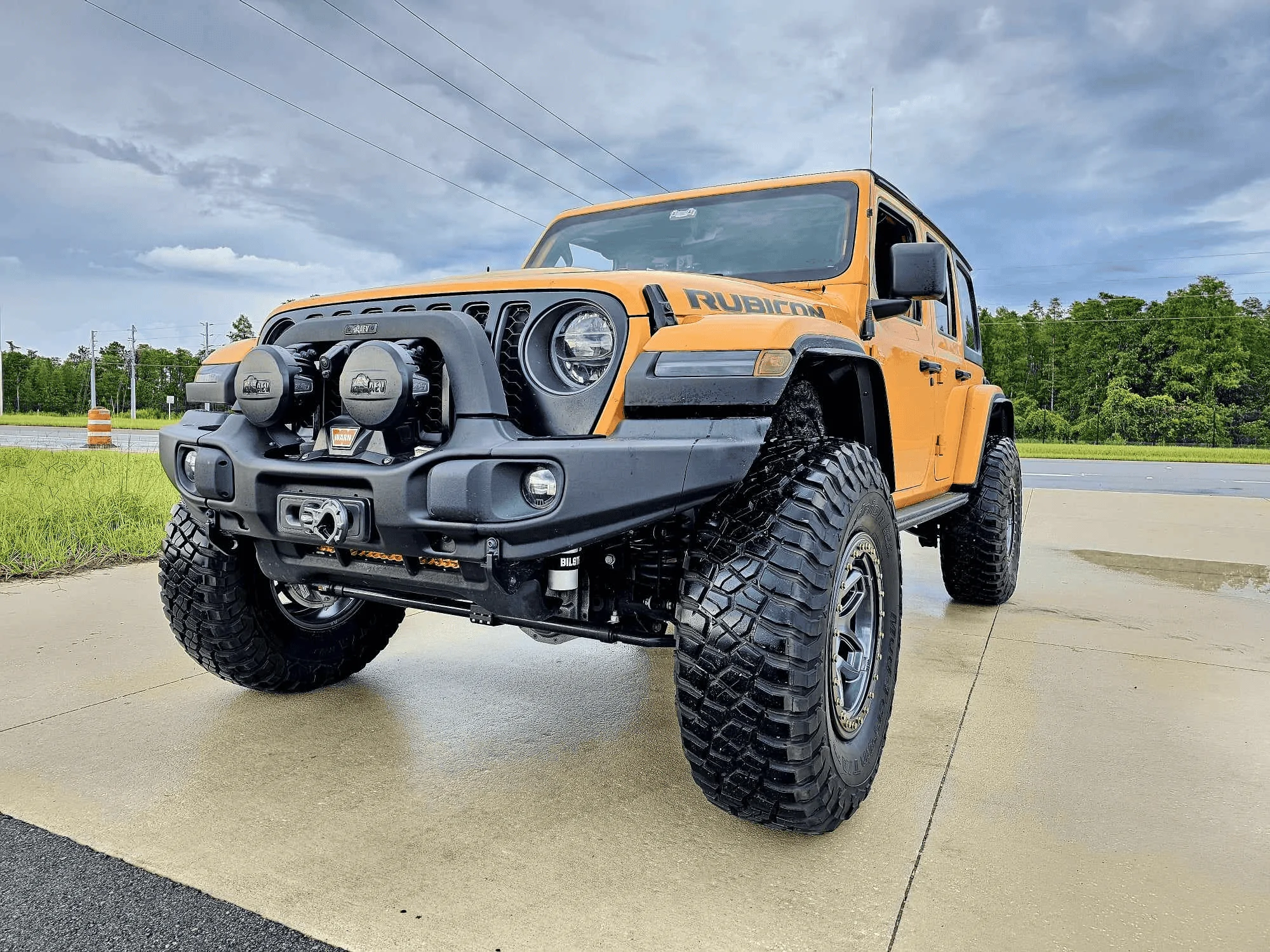

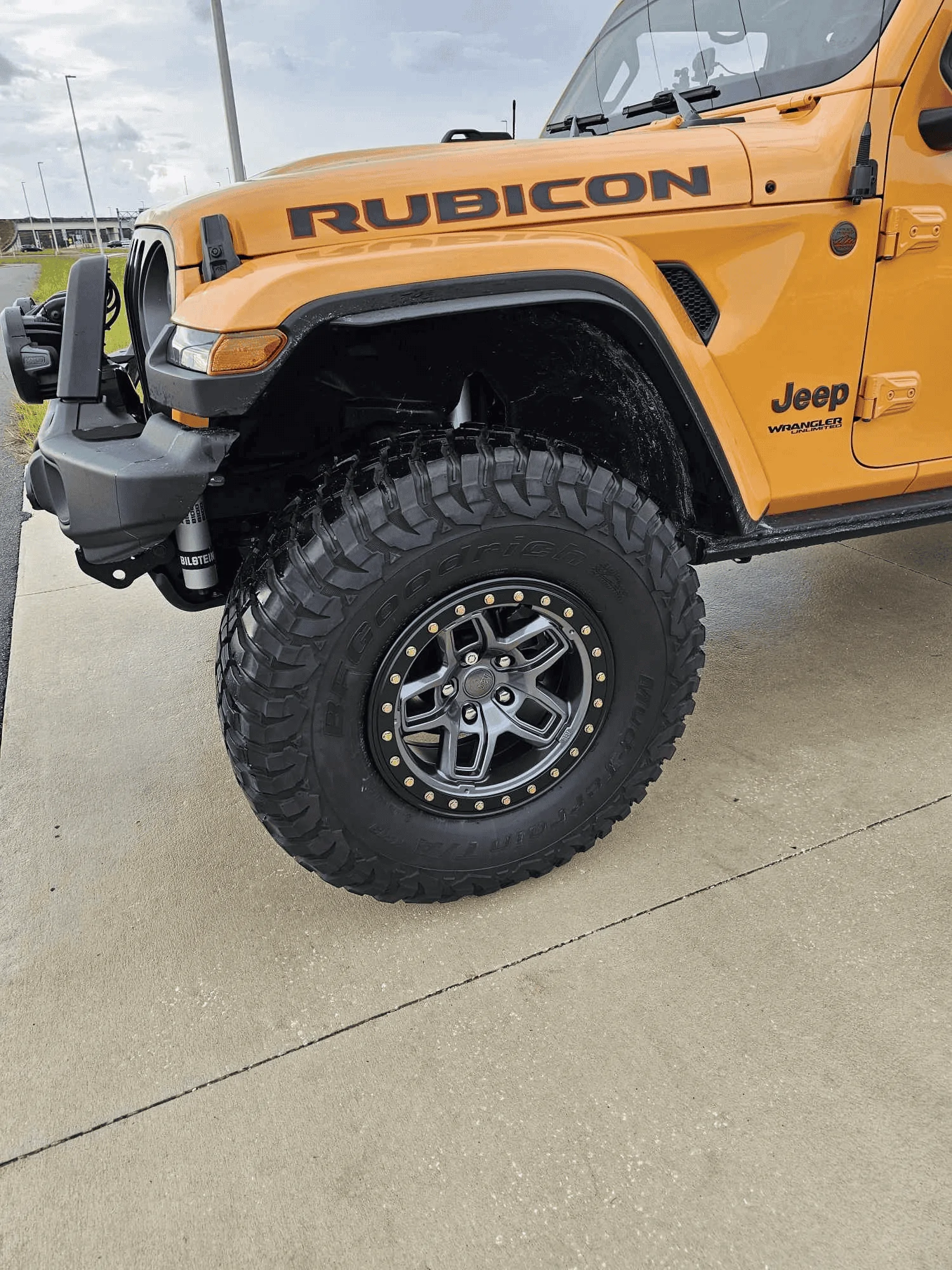

Got the satin black beauty rings on and the gold zinc hardware. Turned out exactly as I wanted. Very happy with the outcome! These photos are still with the BORA 1.25" spacer for anyone wondering.

Looks awesome.
Regarding the rings: I didn't know that AEV sold them in satin black. I have only seen silver and onyx. Are the black ones only sold in the JK version or something?

You are correct, they do not. I had a local company powder coat them that color. The JK and JL rings are identical and only come in those two colors. I appreciate the compliment! I'm liking the change.

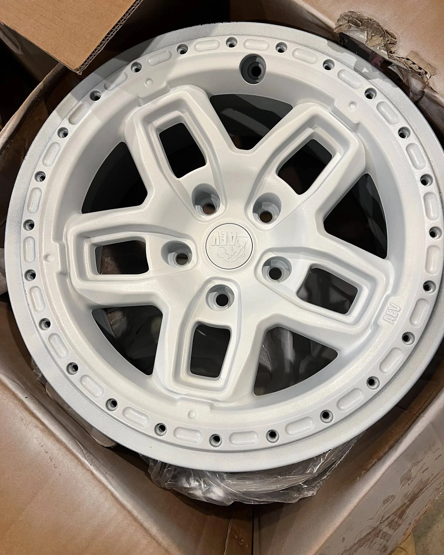

Not an update but a different angle for anyone who decides to go with the JK spec borahs on 37x12.5 Stt Pros
Shot on the iPhone 15 pro max

Looks awesome. I thought you were selling your Jeep! That thing is beautiful.

Did you custom powder coat those wheels? AEV doesn't appear to sell that color on that style of wheel forJL or JK right now.

I plastidipped them since they are easier to touch up
1 can per wheel and 1 can of glossifier for all 5 wheels to give it a little shine

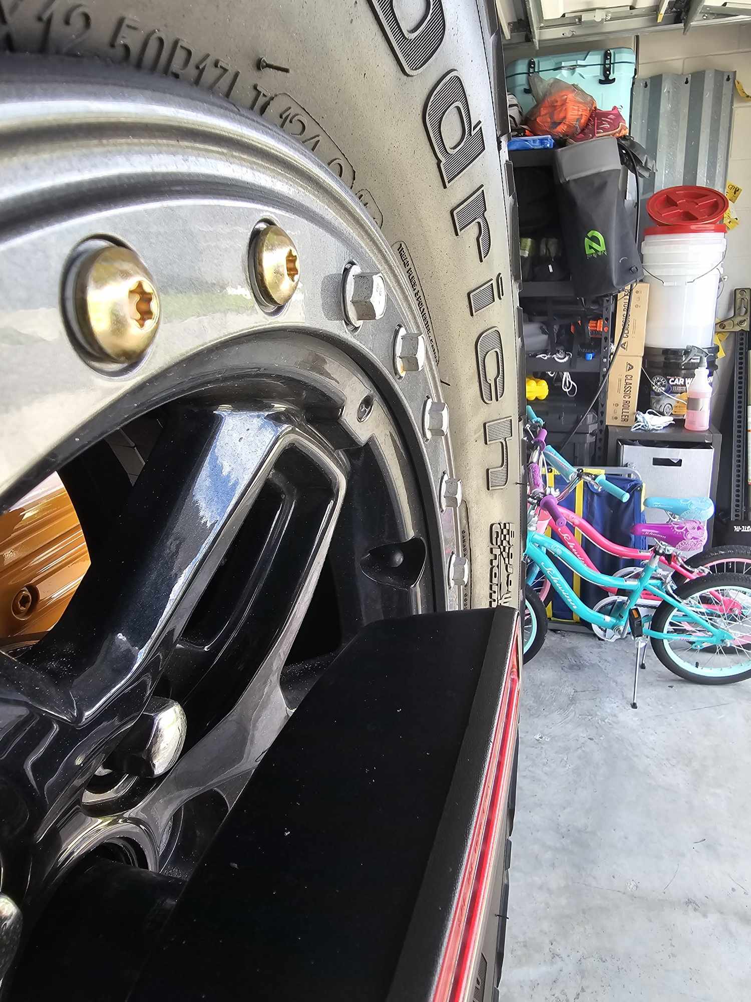

Thanks man! Absolutely, details are listed below. I see I missed another member asking for the same thing. My apologies @EU_Wrangler! I just saw these messages.
I got them from a vendor on eBay that sells quality hardware (linked below). I tried out several different head types and ultimately settled on these. I also tried a set of torx pan head bolts (pictured below). I decided against these and went with the hex flange bolts but these might be a good option for someone doing a lot of rock crawling. I have a full bag of them I didn't end up using if anyone wants them, just let me know.
As for the ones I settled on, the quality has been great so far and each bolt was consistent in quality across all I used. No issues at all and they are 10.9 DIN so no chance of rounding the heads off with hand tools like some have mentioned with the AEV hardware (limited issue I know). The seller got them out to me quickly. I also did zinc washers to keeps things consistent, but you could certainly use the AEV washers. I have included a picture of that with the hex pan head bolts. Link below for the washers are to Fastenal for those wanting them as well.
Note: there are 24 bolts/washers per wheel so purchase accordingly
M8 x 1.25 x 35mm Coarse 10.9 Hex Flange Zinc
M8 x 16mm OD DIN 125 Zinc Washers

Hey Wraith, I love your idea with the zinc hardware! Can you tell me where you got the bolts with the torx pan heads? I’m concerned with rocks, so I think I want the pan head.

I have two bags of them I'm never going to use. I can send you pictures if you want. Send me a PM and we can talk.
