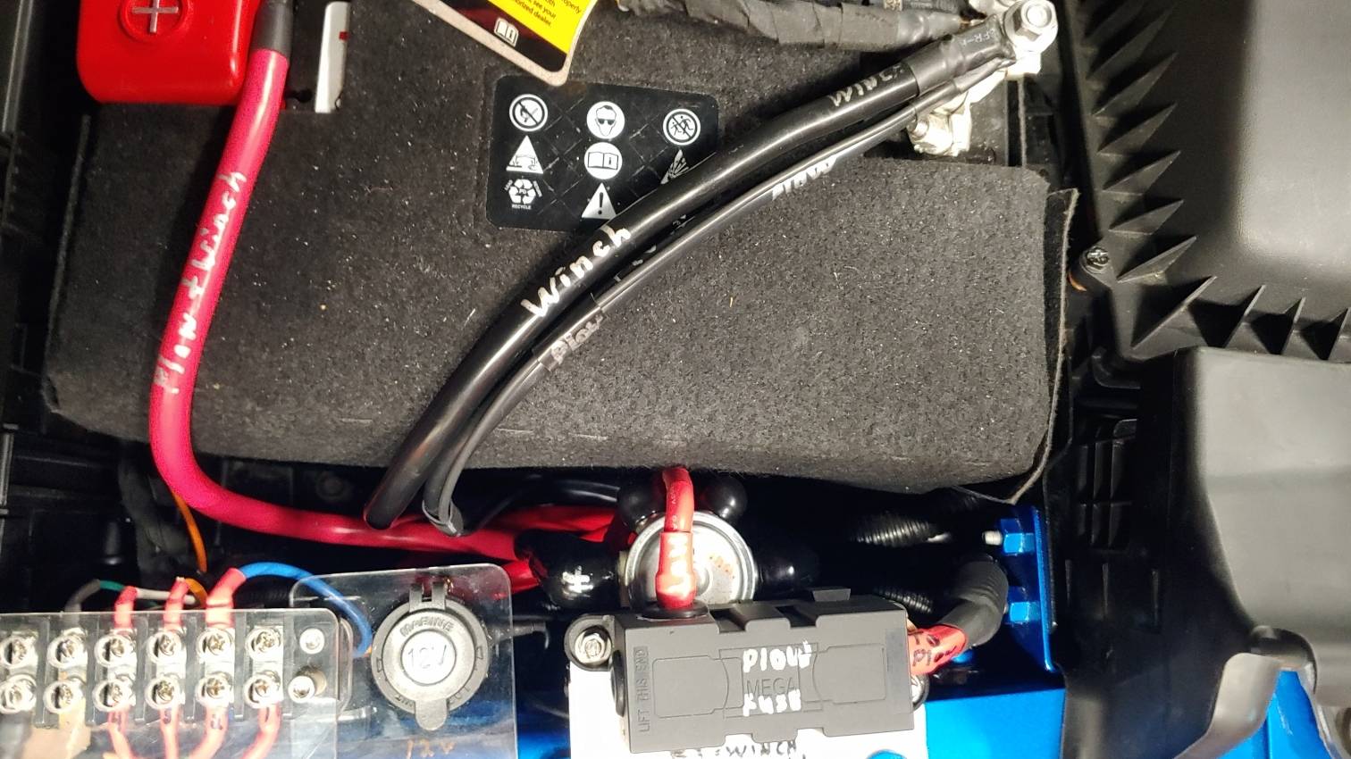

The positive cable goes to the winch solenoid and to the snow plow fuse. So there's only one cable to the battery, I use the battery side of the solenoid as a junction point for the snow plow power as well.
Two negative cables - one to the snow plow, the other to the winch.

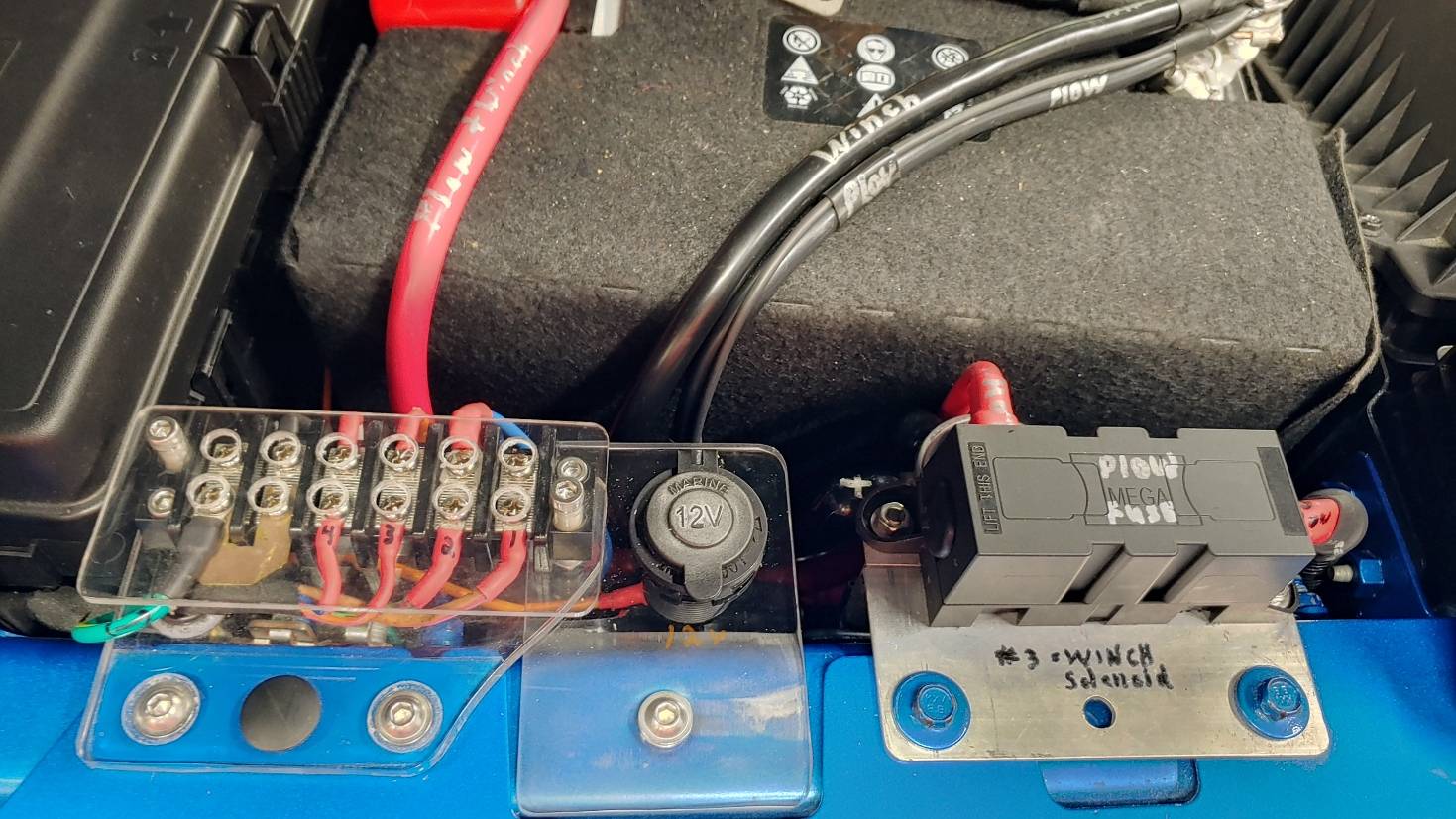

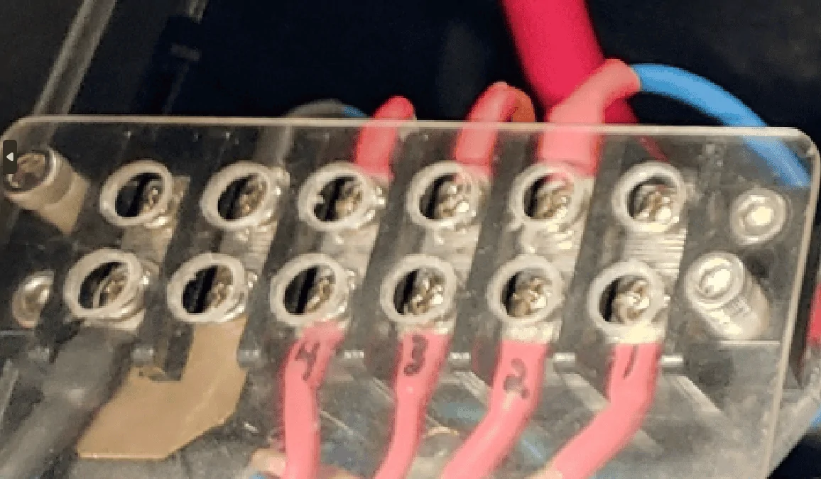

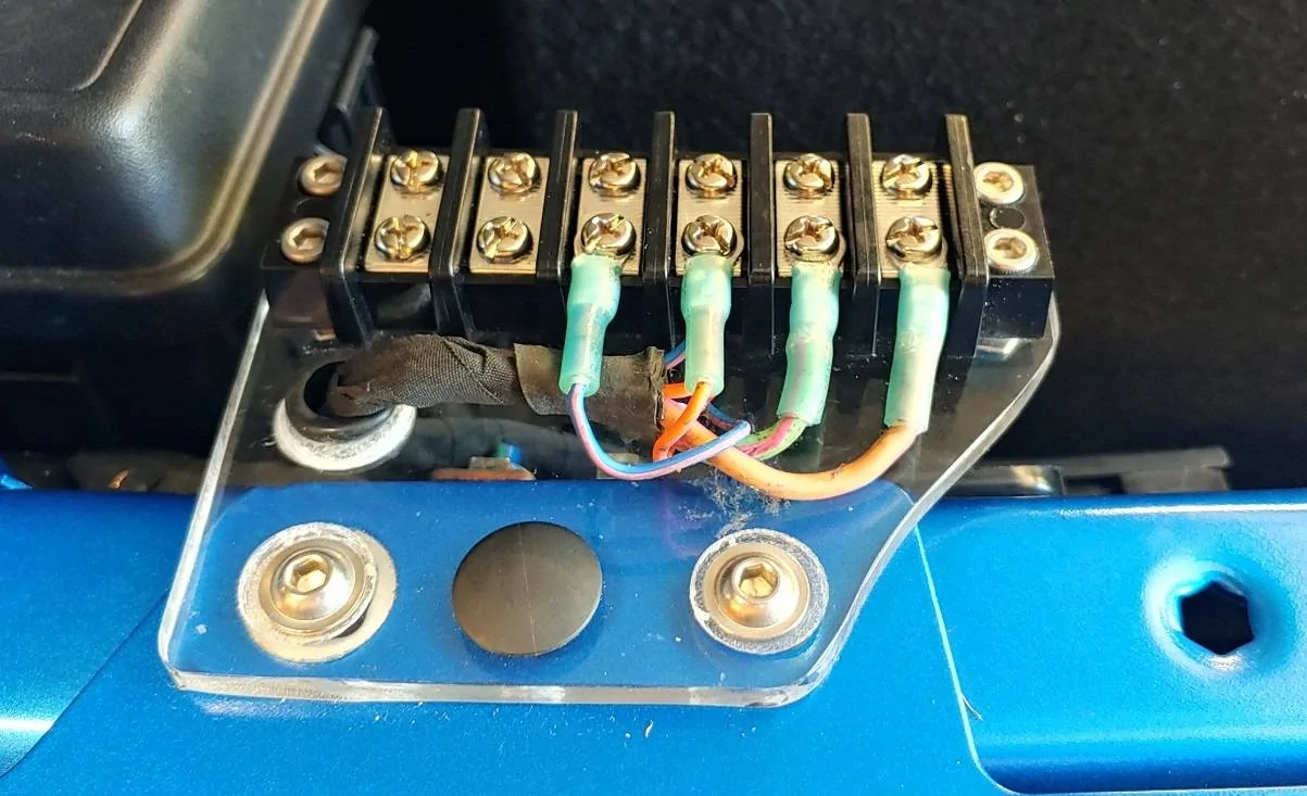

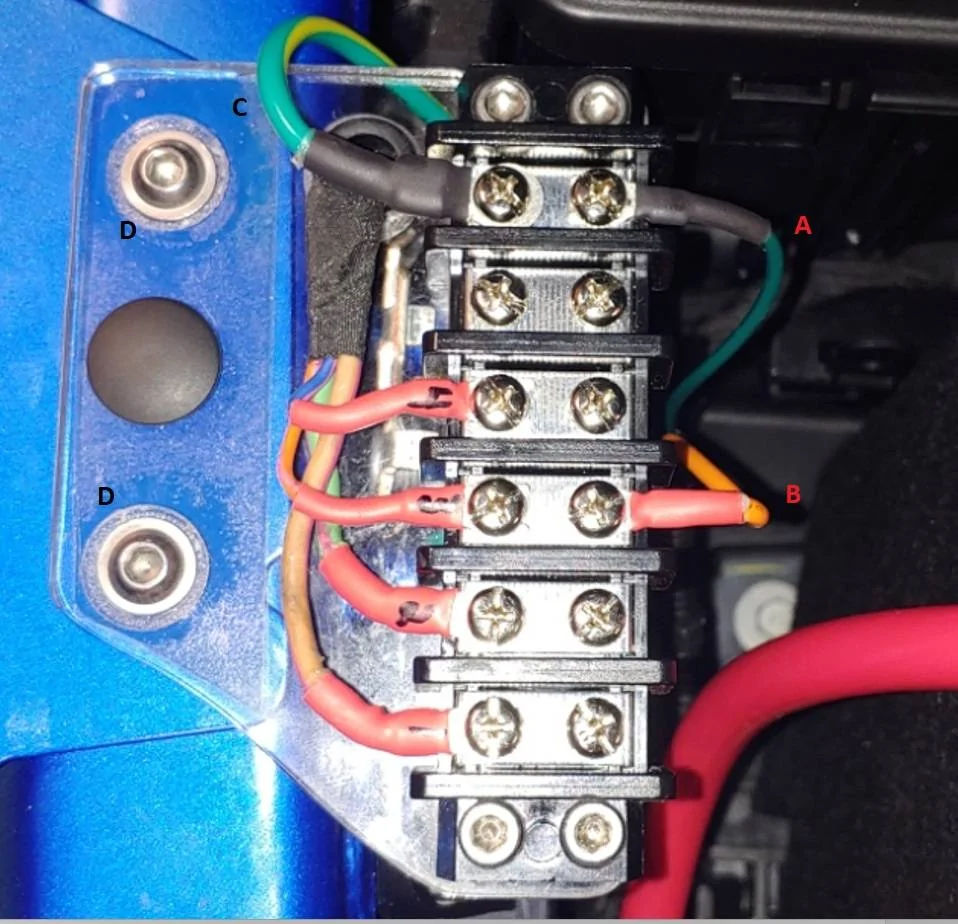

The acrylic was my method of more easily connecting to the 4 wires for the aux switches. You can connect directly to the wires using the kit Jeep supplies with crimp connectors and heat shrink, or do what I did - mount a terminal strip. One side of the terminal strip is the 4 wires for the aux switches, and the other side is where I can connect wires going to accessories.
This is before I added my snow plow wiring and other stuff - it's version 1.0 so to speak.
The wires numbered 1 through 4 match the aux switches. The far left in the pic is ground. I ran a wire to the chassis ground on the fender so I have 2 handy ground points.
The orange lead goes to the winch solenoid primary coil.
The top acrylic prevents me from doing something dumb and dropping or laying a tool across terminals. I can still use a screwdriver through the holes to loosen screws to remove or insert wire terminals, but they can't be accidentally shorted.

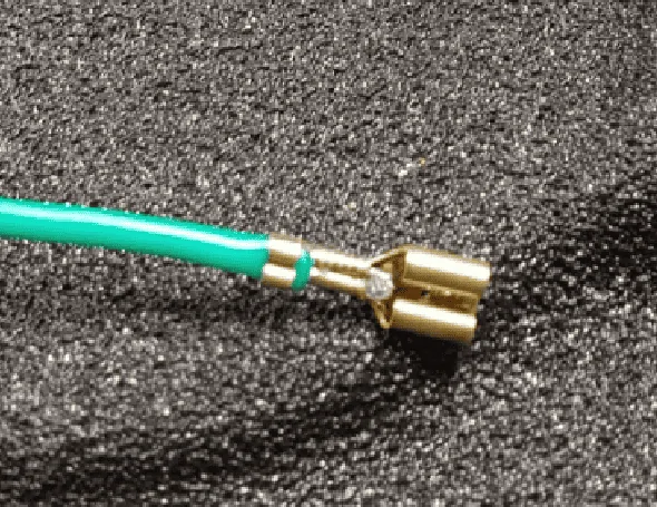

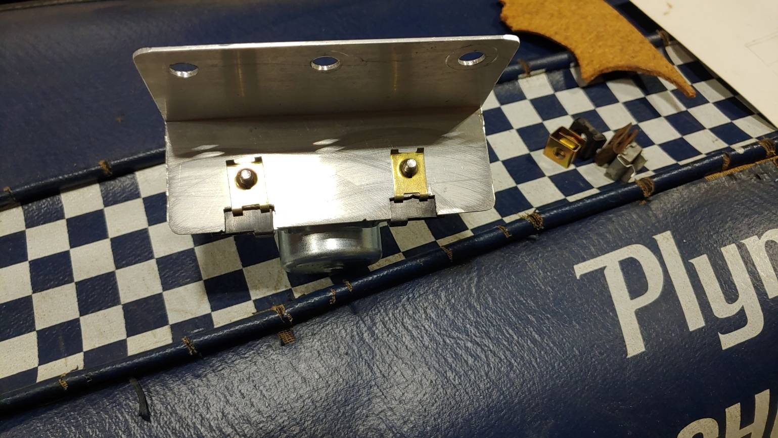

I do restoration of classic car electrical parts - windshield wiper motors, HVAC blower motors, alternators and make small harnesses. So I have several various crimp tools and crimp on factory type connectors (open barrel connectors) and use marine type heat shrink that has the glue that melts and seals the heat shrink as it shrinks.
If you don't have the type of terminals or tools I used, and you use a parts store terminal and crimp tool, you can crimp and then a bit of solder to be sure.

The big fuse is for my snow plow (this is my Jeep Gladiator (JT) by the way, but they are the same under the hood)

The black plug in the acrylic is because I used a scrap I had, there was an extra hole and one corner was chipped so I shaped it like this and plugged the extra hole.
I had to counter-sink the screw holes to clear the RedlineTuning hood struts when the hood was closed.

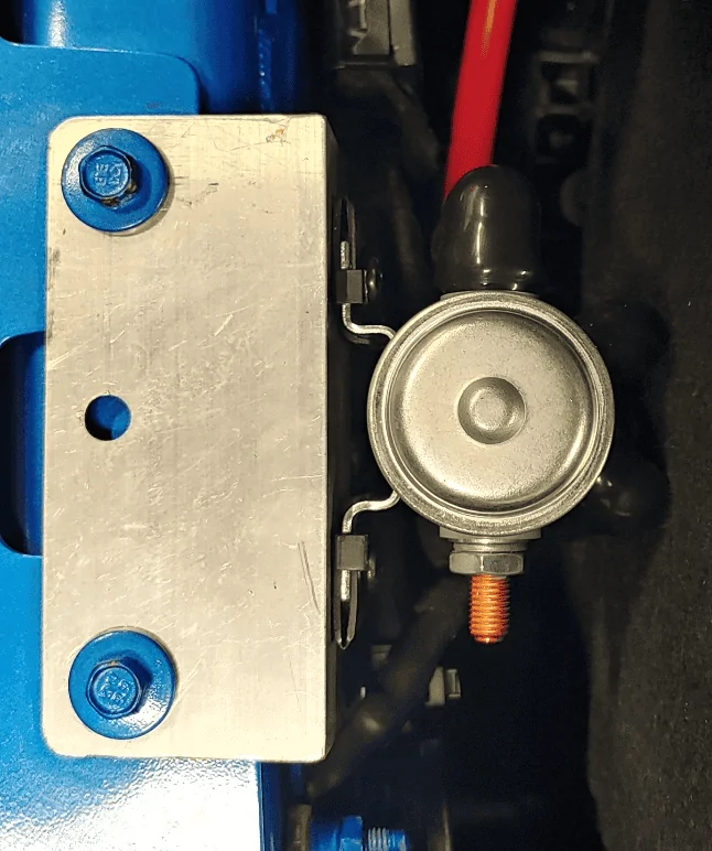

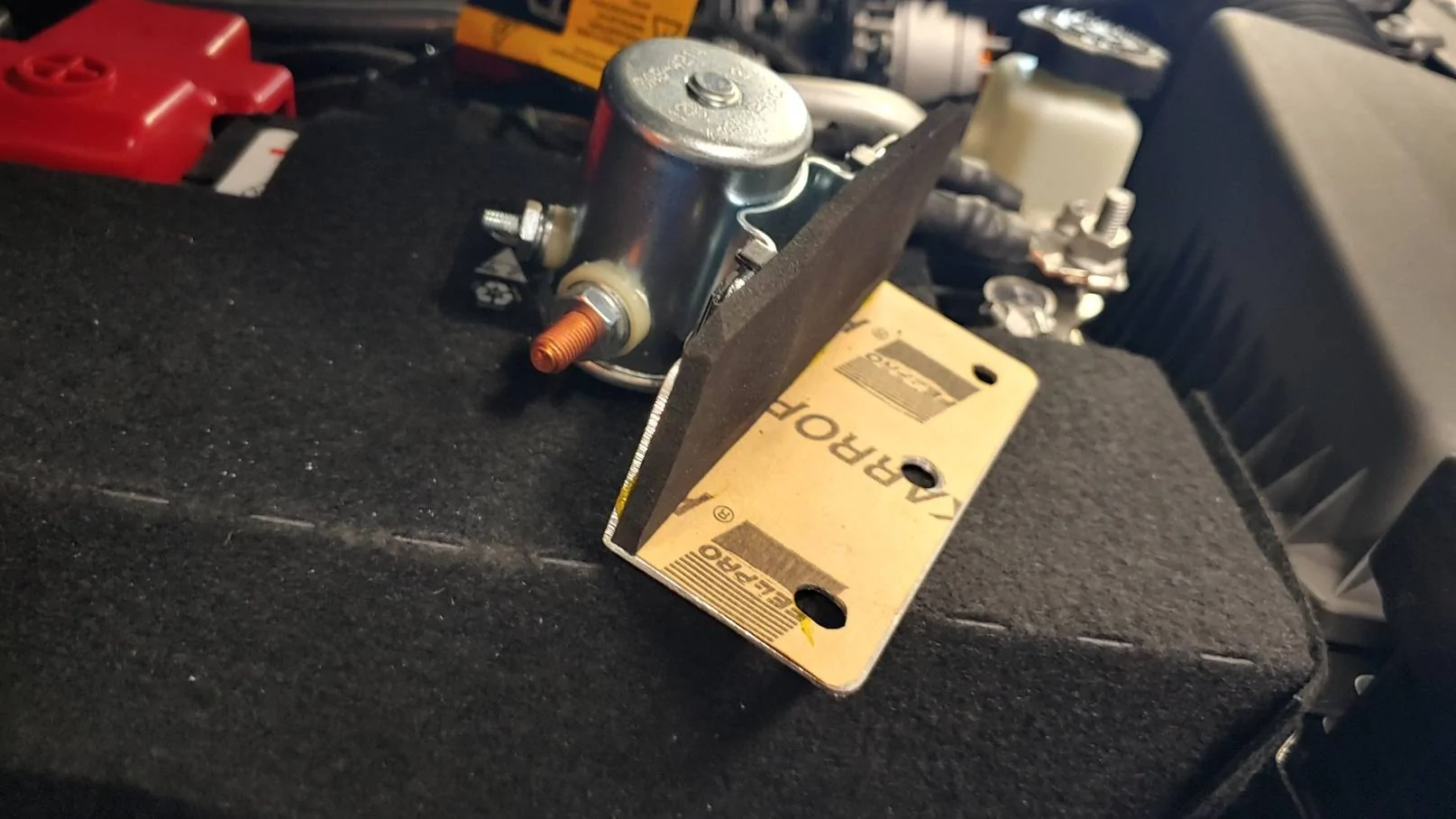

This is how I mounted the solenoid to the bracket I made...........
Jeep Wrangler JL Advice/Guidance on wiring multiple things from battery 20220717_165214

I used this bracket from 813 Fabrication https://www.813fabrication.com/product-page/underhood-electrical-accessory-plate
and modified the footprint slightly with some 1/4” ABS sheet to accept a Blue Sea Safety Hub 150
https://www.bluesea.com/products/7748/SafetyHub_150_Fuse_Block
I mounted a Warn solenoid under the 813 bracket for my Warn winch. It’s connected to Aux switch 4
https://www.amazon.com/WARN-62132-Power-Interrupt-Kit/dp/B000CQFVN8/ref=sr_1_4?crid=WYOLB5Q0YZ57&keywords=warn+winch+solenoid&qid=1679948663&sprefix=Warn+,aps,335&sr=8-4
My ARB Twin compressor, Rock Slide Engineering steps, and KC under hood lights all use their own switches. This leaves Aux 1-3 open for future devices
