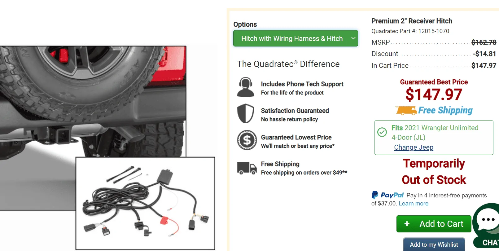

Would you recommend the Quadratec or the Mopar? I think they are about the same price.
Should be a pretty big difference. I remember Mopar being $300+ and didn't include the reciever.
Jeep Wrangler JL Adding trailer and wiring to JL + interstate move help 1678902953619

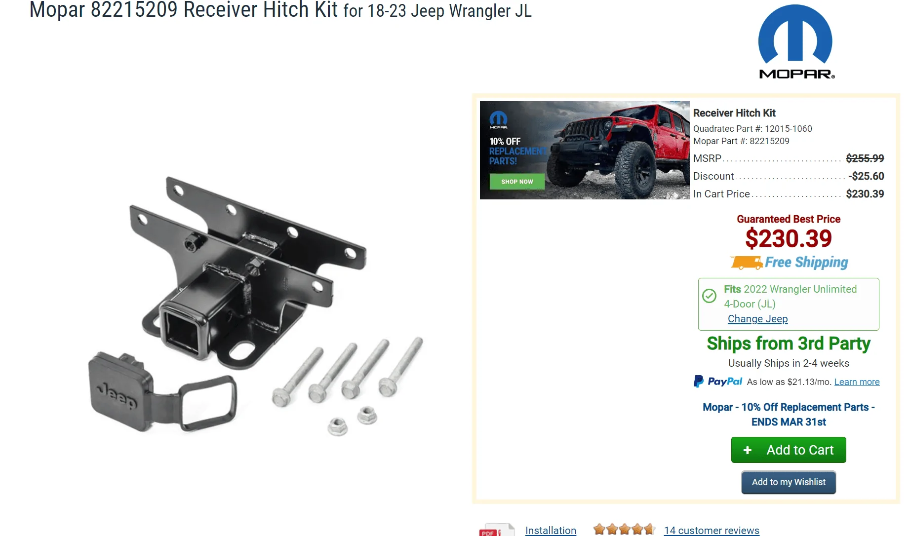

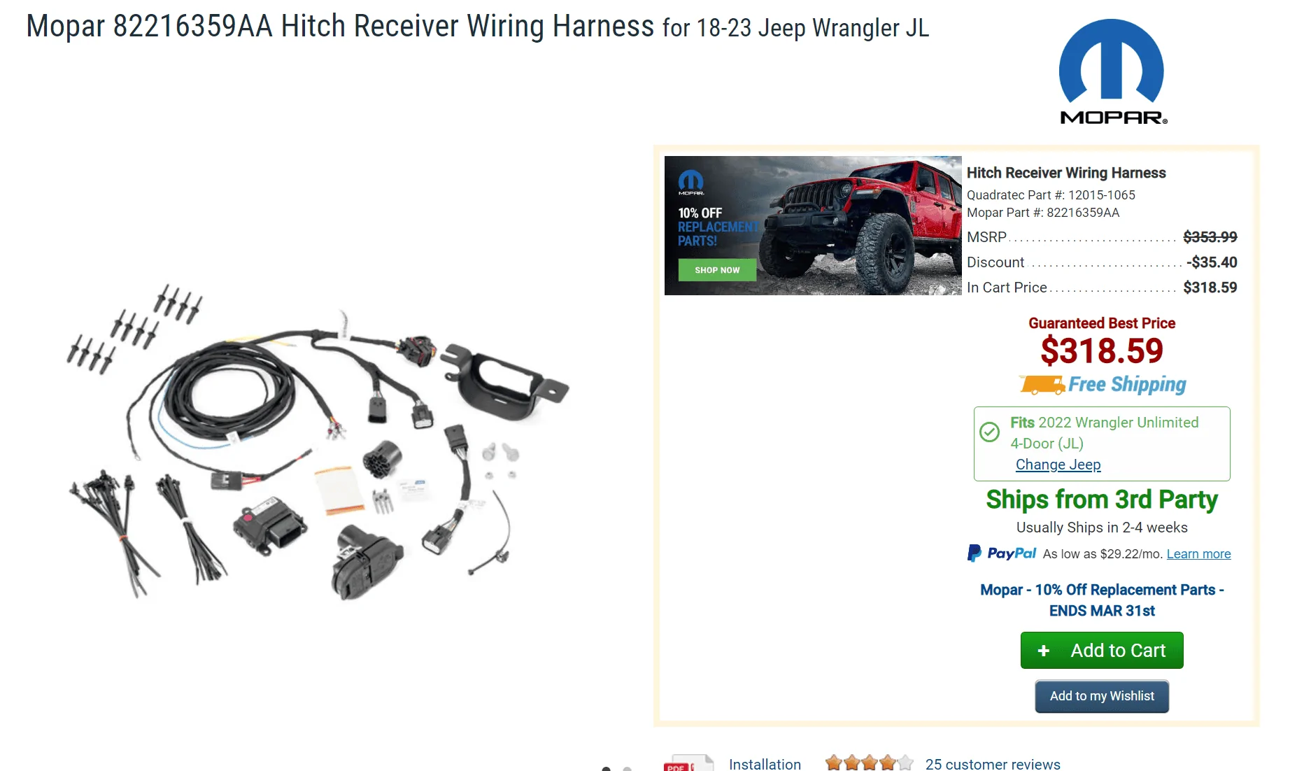

Hi Matt,
Can you confirm the following Mopar parts are accurate, if I went with Mopar?
Jeep Wrangler JL Adding trailer and wiring to JL + interstate move help 1678906553629
Jeep Wrangler JL Adding trailer and wiring to JL + interstate move help 1678906577436
