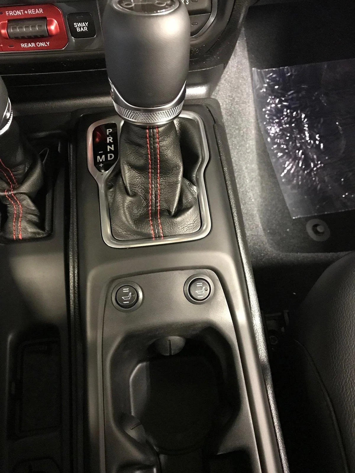

I had it added by the dealer on my preowned . Also the trailer hitch. They farmed them out to a local shop that does truck and car aftermarket stuff. They work fantastic. The buttons were put on the center console just rear of the shifter. They do not turn off , or reset to off when the ignition is off. You have to flip the little switch. Glad I did it. Don't know exactly how much it was but I think I paid the dealer 1600 for both. They said that was their cost. Do I believe that? Maybe, but either way I wanted thesis mods.

We used the same heated seat kit: https://www.amazon.com/gp/product/B001L6HYQK/ref=ppx_yo_dt_b_asin_image_o09_s00?ie=UTF8&th=1 , but without any seat covers. We removed the seats from the Jeep, then unlatched/unzipped the covers, removed the 2-3 hog rings (with diagonal cutters) on one side and slid the heat elements between the foam and the oem covers in the seat and in the backrest.
Then carefully fed the wires through a gap between the seat and back, secured the covers with zip ties (can't reuse the hog rings without special pliers), then reinstalled the seats and routed the wire underneath the seat rails into the middle console.
We installed the switches in the same spot as mazeppa. Each switch has a 10 amp inline fuse, leading into a single main lead. The ground is connected to a bolt in the middle console. We wired the main lead through the grommet in the passenger side firewall into the fusebox, using a fuse tap and 20amp fuse to piggy-back the existing front heated seat fuse location.
Took about 4-5 hours total, including a lot of alcohol and choice words ;). Overall, we are extremely pleased with this product...worth it.

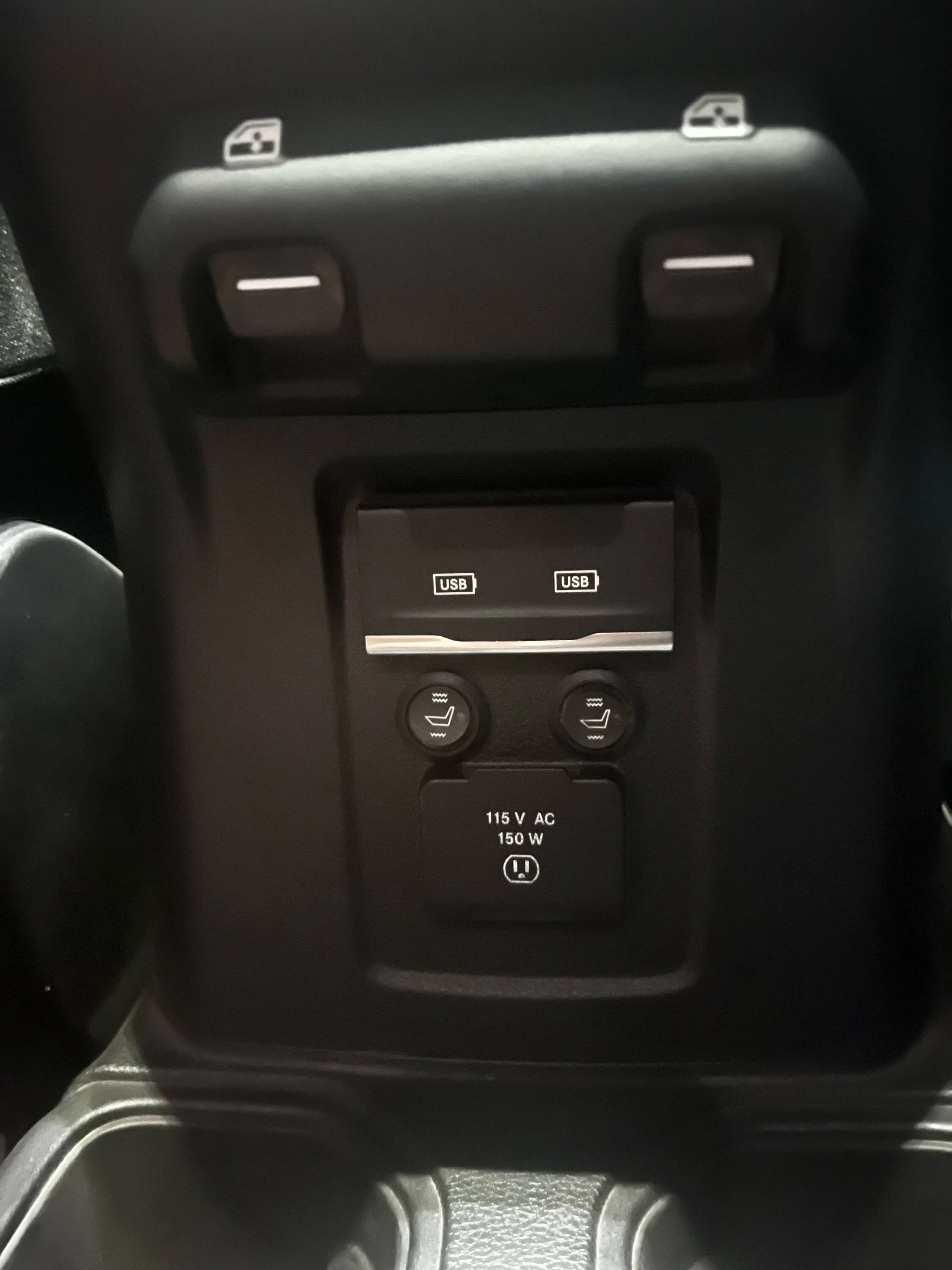

I have added seat heat to my back seats on my last 2 Jeeps. I had to remove the seat covers and install the heaters and then redo the hog rings as I put the covers back on. One time I did it with the seats in the jeep, the 2nd time I removed the seats completely. Wiring with the aux switches is super easy. On the one I did without the aux switches I ran wiring to the fuse box and tapped into the front seat heat fuse. It’s a lot of work, but not too hard, and totally worth it here in Michigan!
