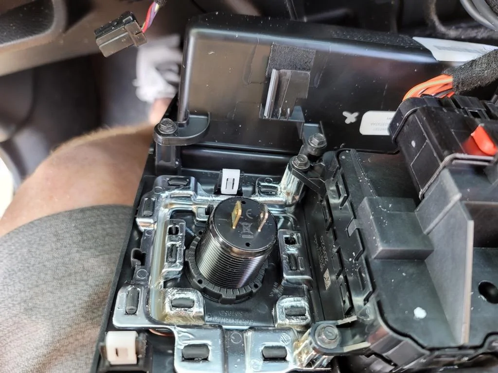

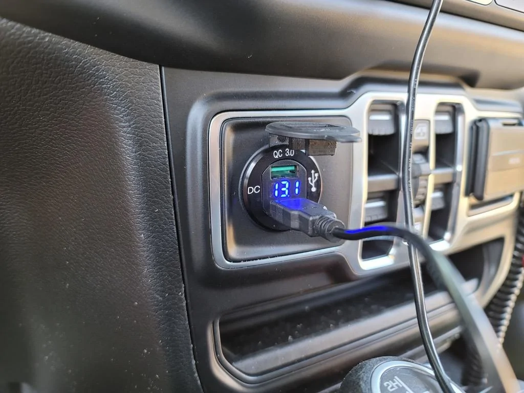

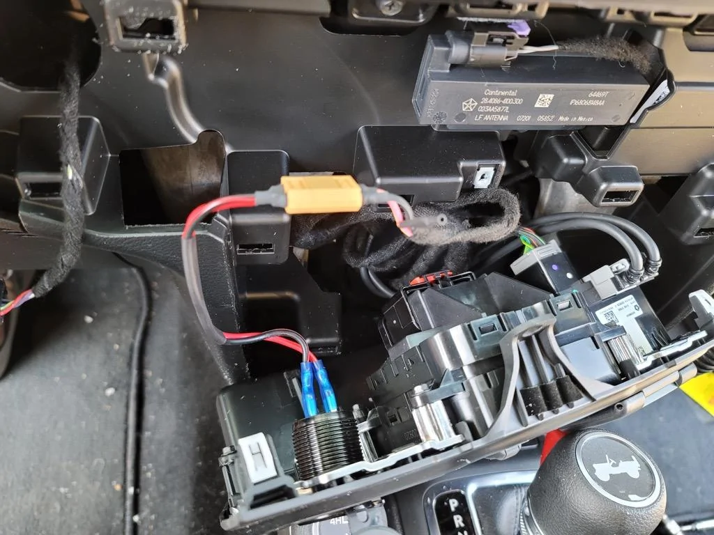

My new 2021 Wrangler came with a 12 volt cigarette adapter in the front dash board. I still cannot for the life of me figure out why auto manufacturers do this. I picked up a 12-24V QC3.0 Dual USB Car Charger Fast USB Socket Outlet + Blue LED Volt Meter on eBay. I put one of these in my Ford. Now my dash looks normal. I had to cut out the old one with my Dremel and make the hole a little bit larger with the Dremel.

Nice - I bought a similar unit to install in the top of the dash. Your setup did give me a simple solution of where to steal power from (ignition only for that cig lighter vs the rear), but that is ok for my purposes.

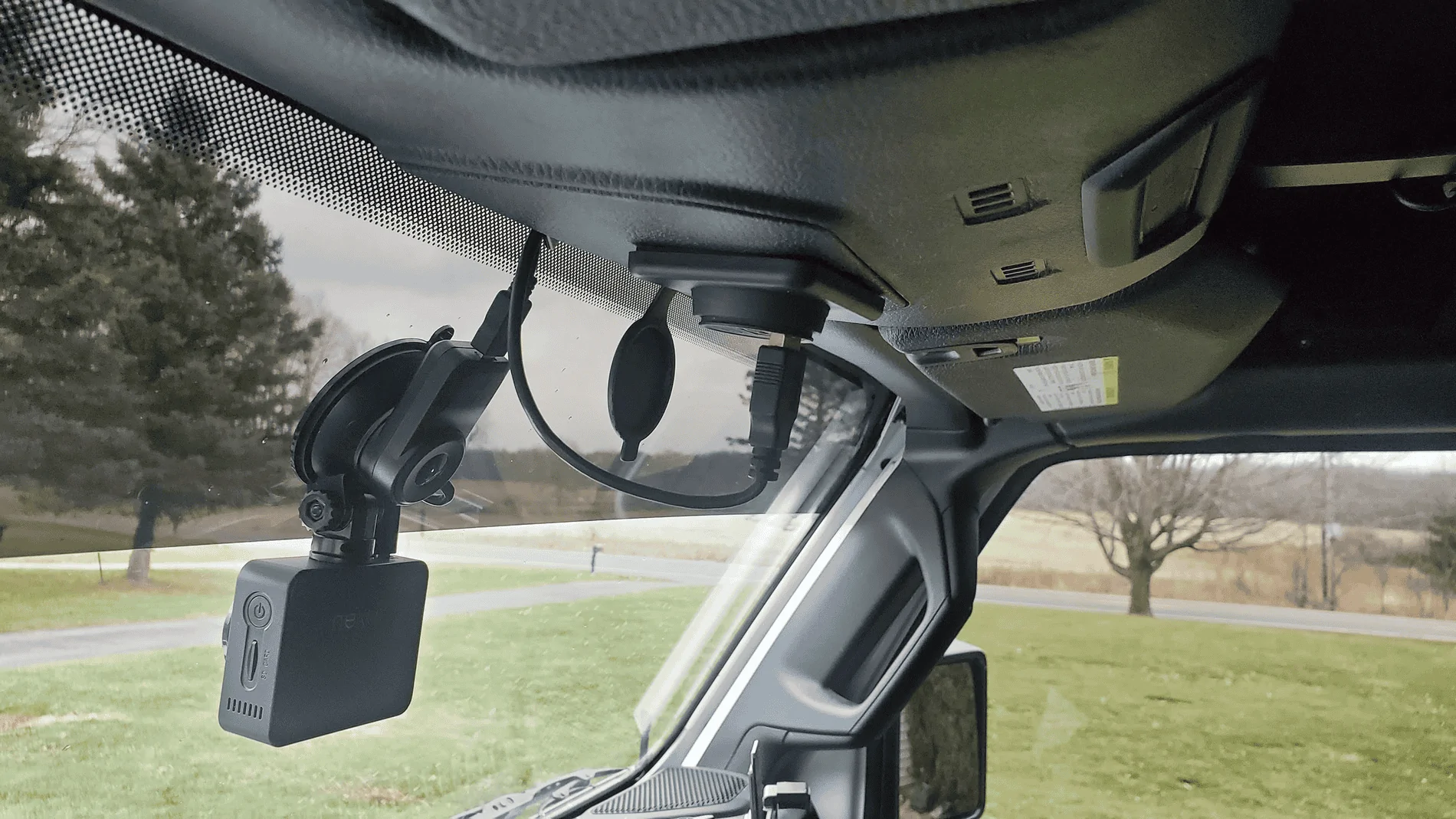

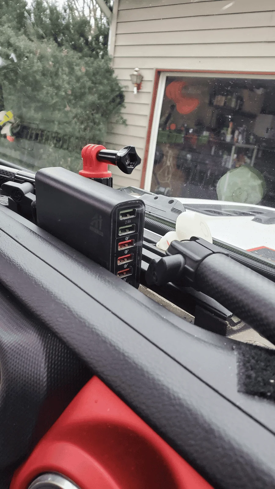

I ditched there rear view mirror and added two USB ports up top and put a power bank wired direct on the dash. I can't stand cables running all over the Jeep dash.
Jeep Wrangler JL Adding USB Ports 1624877280110
The power bank has an off/on button
