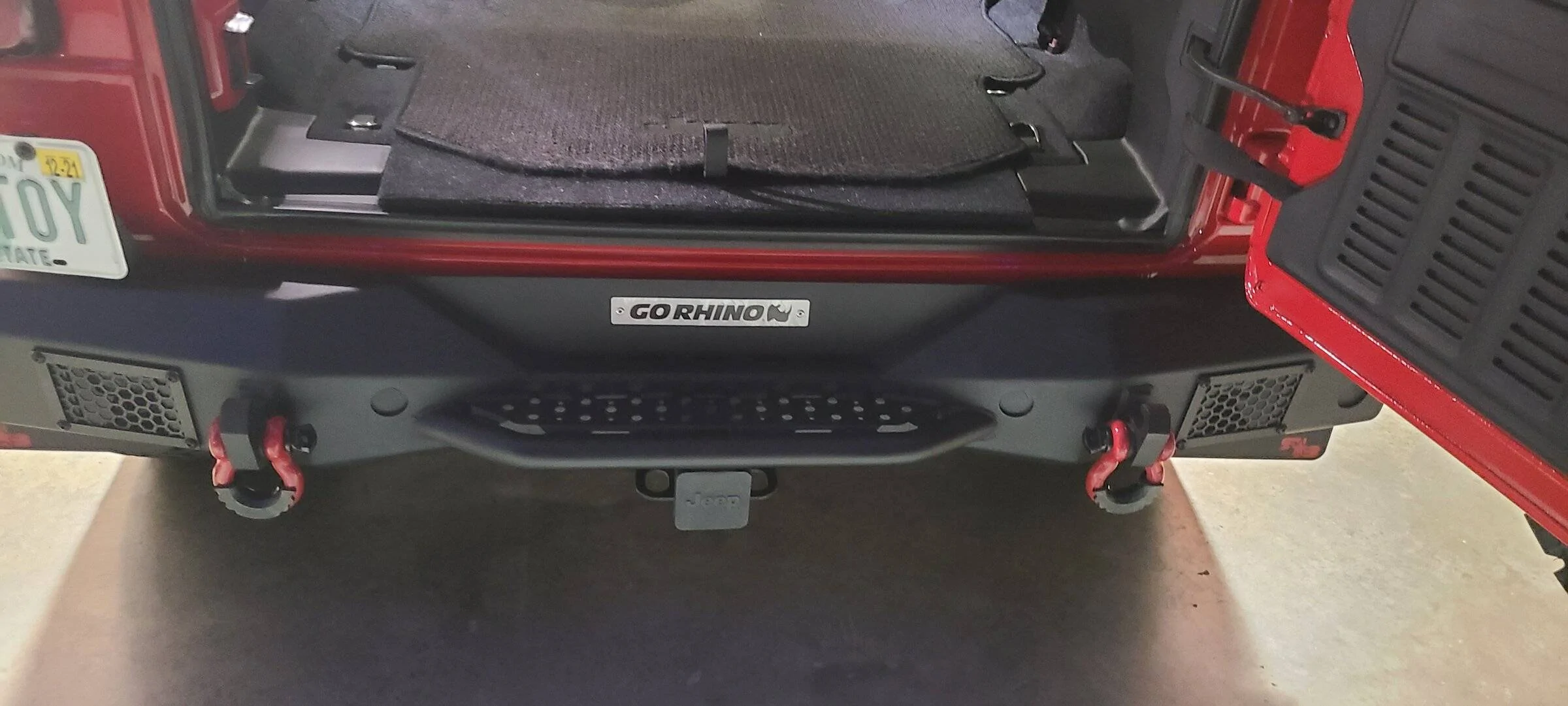

'21 Willys 2 dr. Just got a set of 3" cubes to install in the rear bumper, got them hooked up to the backup light feed on the drivers side tail light and they cycle on and off. I'm guessing the canbus system doesn't like the extra load. Has anyone had luck getting this to work?

I thought about that too, and changed the setting with the Tazer back and forth with no difference. I had a relay sitting in the garage and hooked it up. Sure enough, with the relay it works great. I miss the days where you could add anything within reason without giving the computer a $hit hemorrhage. :angry:

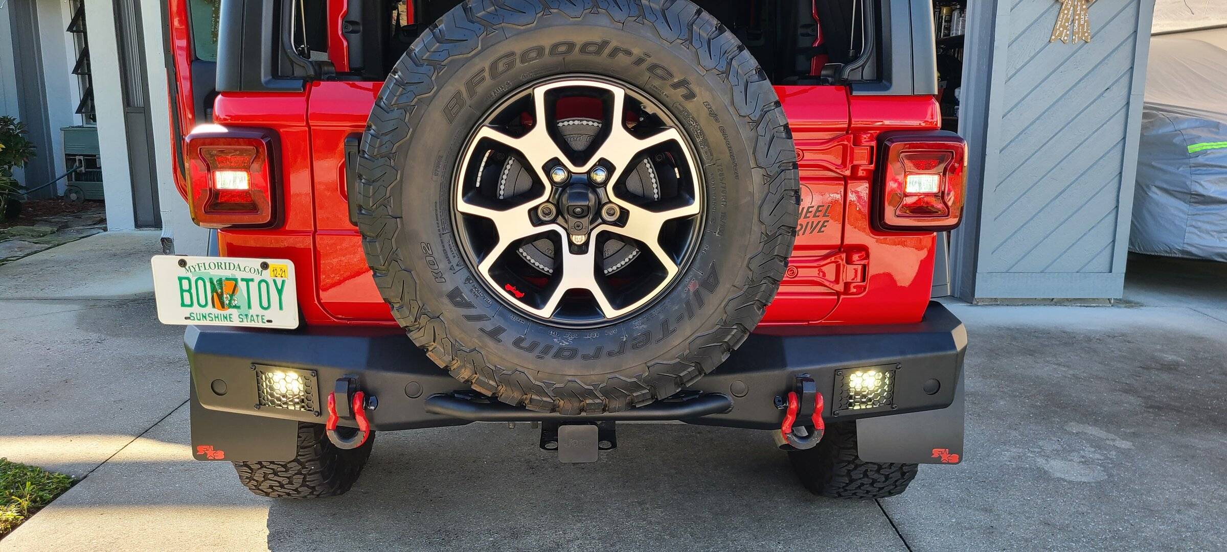

What bumper is that, looks great w/ those lights too! Now that you're getting versed in JL wiring my license relocation would look great back there IMO.

Thanks, that's a Go Rhino rear. I got it cause it came with the tag mount but I really like the way you did yours. I'll probably add your mod to it if you don't mind... Also, that's the wife's plate. Changing it out next week.
Yeah, that relocation takes a bit more wire routing, but other than that it's $15 well spent IMO, and FWIW I've never used that tailgate keyhole.
I like that bumper, that small tube under the tire is a good look and nice extra protection there, looks like a well designed product. Do you happen to know the weight on that one?

Somewhere around 71 lbs. I like that it wraps around the corners. My last bumper on the JLURD was like that and it saved the body a couple times.
