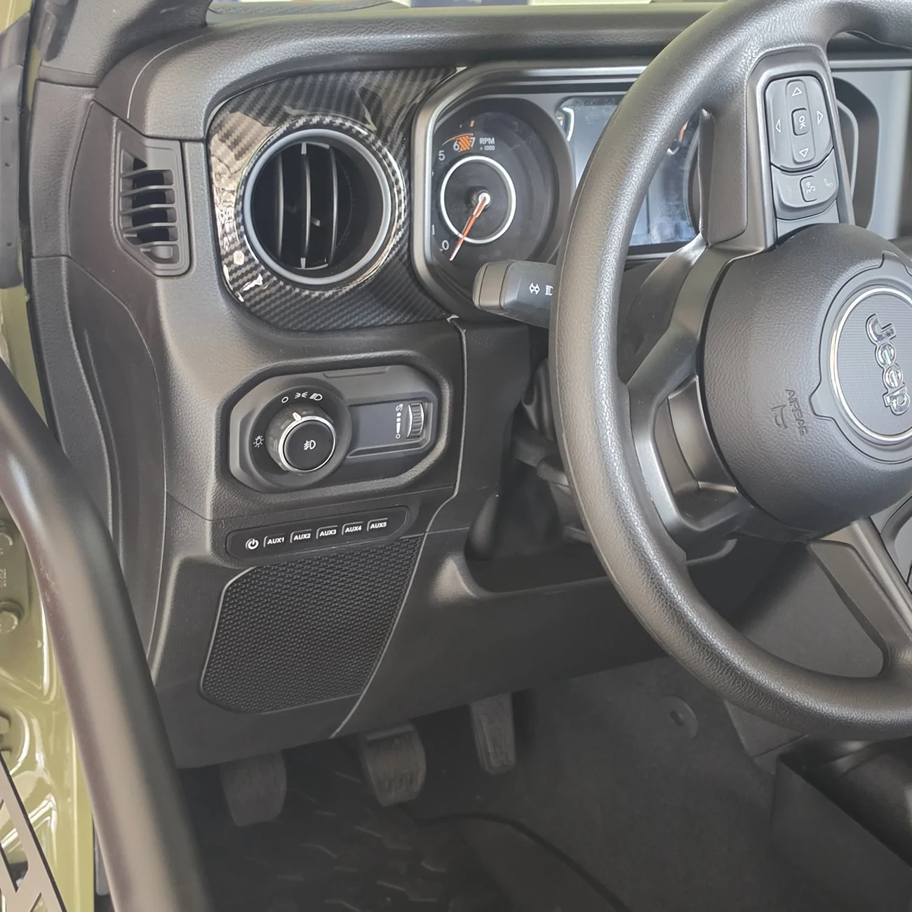

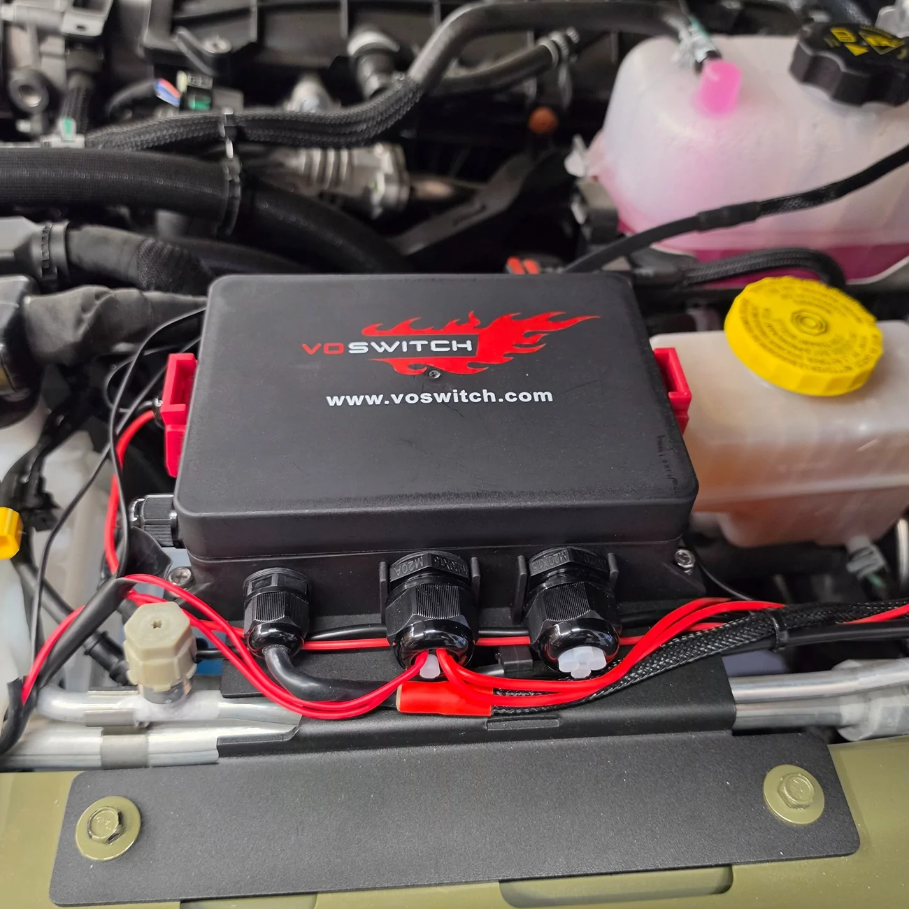

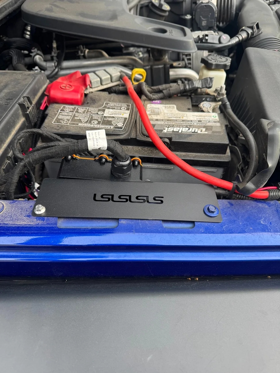

Under the hood shot. I also like keeping the shelf for my phone...
Jeep Wrangler JL Adding Aux switch group 20260525_174654
Jeep Wrangler JL Adding Aux switch group 20260525_193452

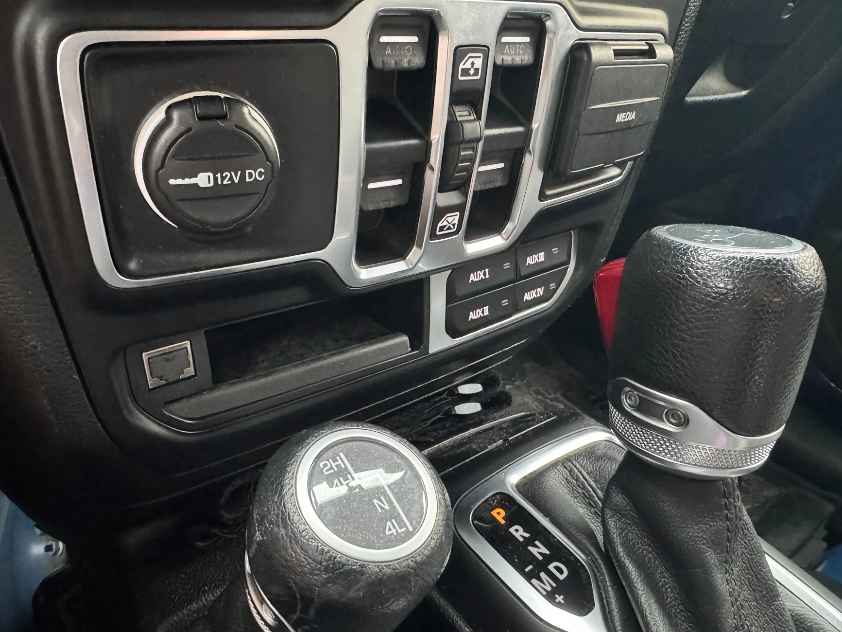

I did the OEM one and it wasnt hard. The instruction is clear. Getting the wire through the firewall was the hardest part but I think that applies to any auxiliary switches. Depends on how many accessories you plan to run, OEM accessory switch could be a good option.

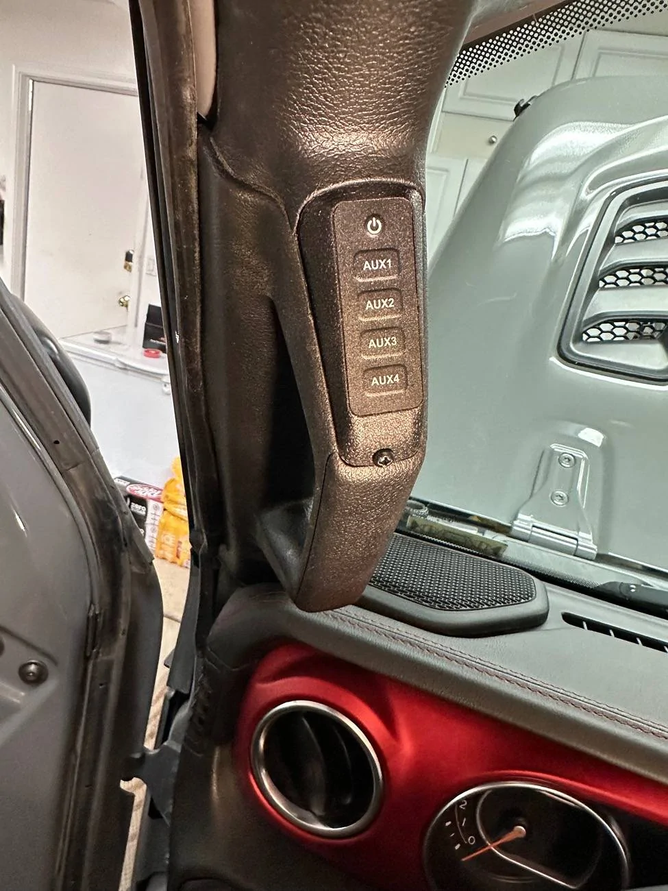

Lasfit setup is as close as youll get to stock. No latching switch though.
Jeep Wrangler JL Adding Aux switch group IMG_4314
Jeep Wrangler JL Adding Aux switch group IMG_4316

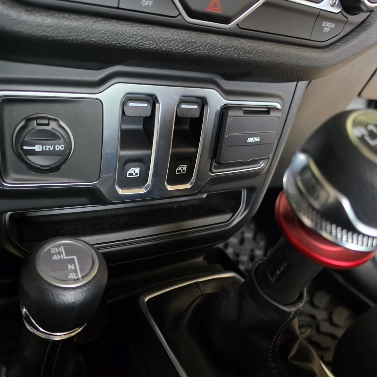

I have the OEM aux switches. I also have the Voswitch JL400 which is more convenient for frequently used accessories in my opinion. That little black screw there? Just ignore that…”somebody” was careless despite the warnings.
Jeep Wrangler JL Adding Aux switch group IMG_1119
