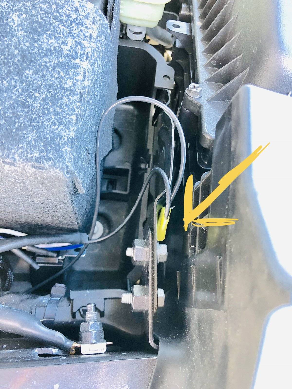

I tried to add a double LED light set (taken off my 2016 jeep) to my Aux switch #1. This rigid light kit ends with a Negative and positive terminal. Another 3 wires go to a rocker switch if needed (black, red, and blue). Which I dont need since I have the Aux switches now in my new JL jeep. I first hooked up the red and black wires to (ground and aux switch wire #1). I left the three rocker switch wires alone. Of course the lights didnt work. Then I tried to hook the three wires that would normally go to a rocker switch to Red to Pos and black to ground, blue to nothing. Again lights didnt work...... I dont like to experiment with voltage as this is a new vehicle. But I cant account what to do the the 3 rocker switch wires. Does anyone know how to wire this correctly ? Iam not very good with this and dont want to damage something. Appreciate any help with someone smarter than me!
You cut away the rocker switch, so all you have left is the wire that goes to the Aux switch and the wire that goes to ground point.
For a decent ground that is readily available and you do not have to clean paint off of and will not snap off when you go to use, use the one in the pic below..

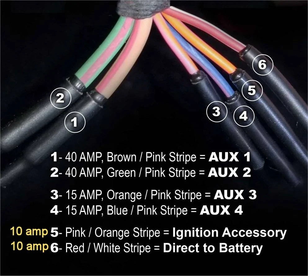

Just noticed you said you were going to use Aux 1 which is fused at 40 amp.. If you do use Aux 1 then do keep in play that inline fuse that is part of that harness, so you have appropriate fuse protection for your Rigid's.
You might consider using Aux 3 or 4 that are both fuse protected at 15 amp. Use Aux 3 or 4 and then don't bother keeping the fuse holder/fuse in the mix that came with the Rigid harness.
Consider keeping and using Aux 1 and 2 that are fused at 40 amp for higher draw goodies you may want to install in the future.
#5 and #6 in the pic are only found in the aux wire bundle you find in the passenger footwell..

Thanks for that reminder. I read that somehwhere but when I look at the wires #1 and #2 dont look any bigger than #3 and 4. May I cant tell the dif. I didnt finish connecting anything yet because I cant figure out why the lights dont work with the Aux switch. Thanks.
The wires that plugged into the rocker switch (three total) also come out of a relay. How does that affect the lights not being used now? I would think somehow that circuit needs to be complete in order for the lights to work.
What would be any examples of extras one would add that you would want to use the 40 AMp fuse in line 1 or 2. thanks.
