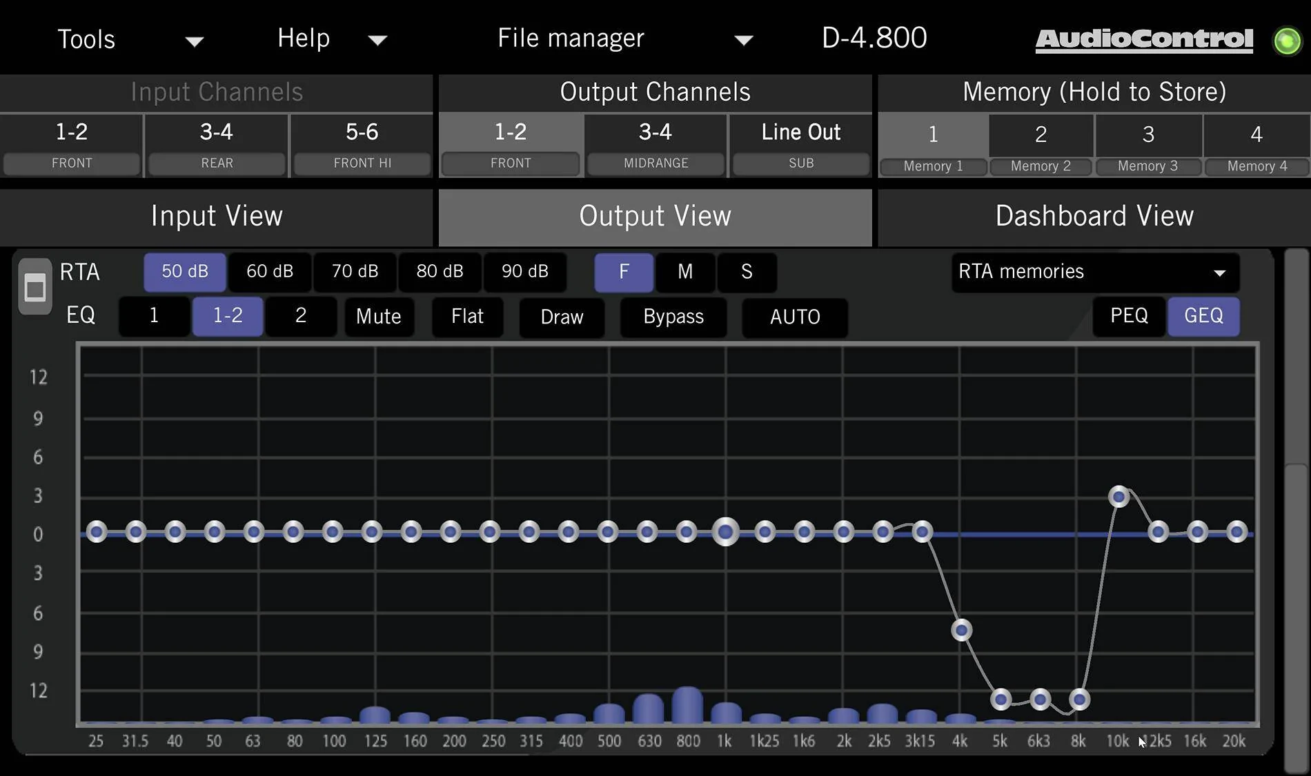

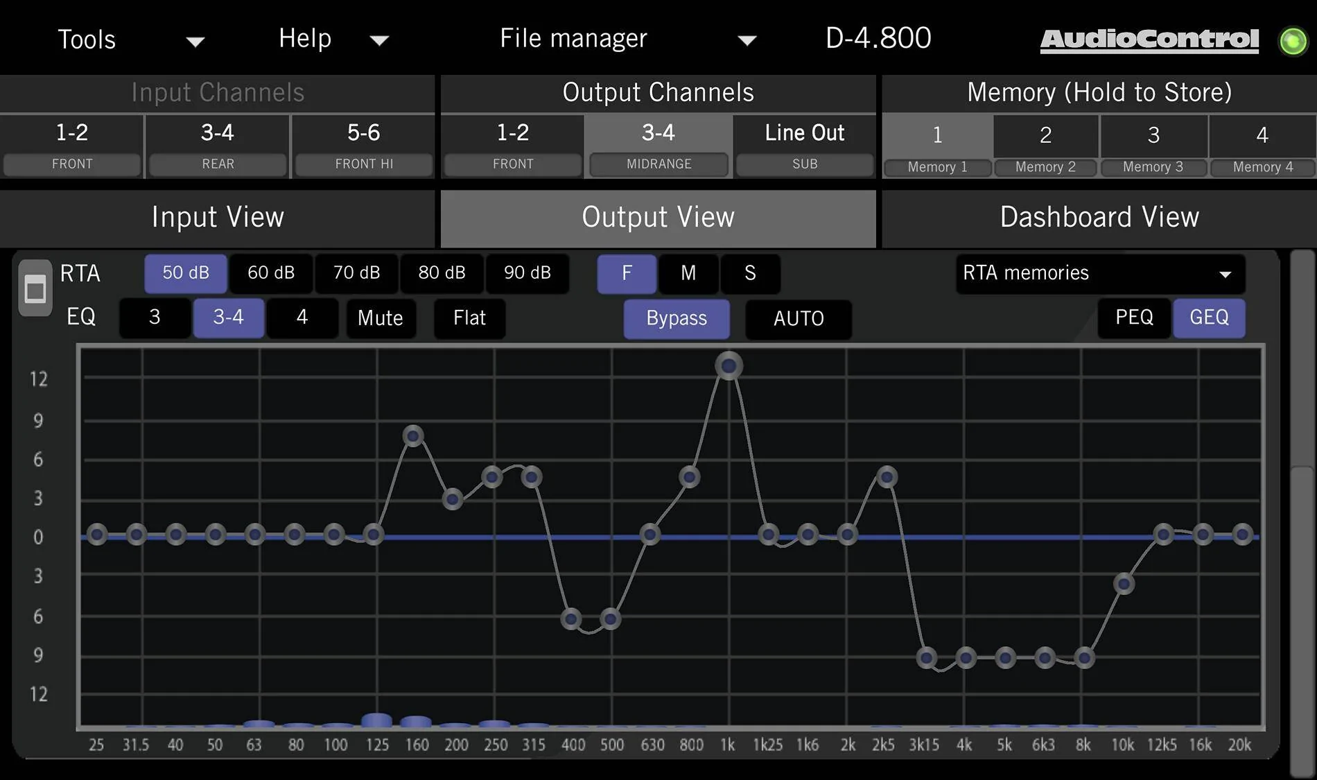

The Audio Control works MUCH better.
Attaching these correction graphs just for a laugh. The amount of engineering car makers go through just to use cheap ass speakers is crazy.
FRONT
Jeep Wrangler JL Adding an Aftermarket Amp(s) JEEP_FRONT
REAR
Jeep Wrangler JL Adding an Aftermarket Amp(s) JEEP_REAR

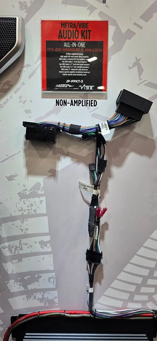

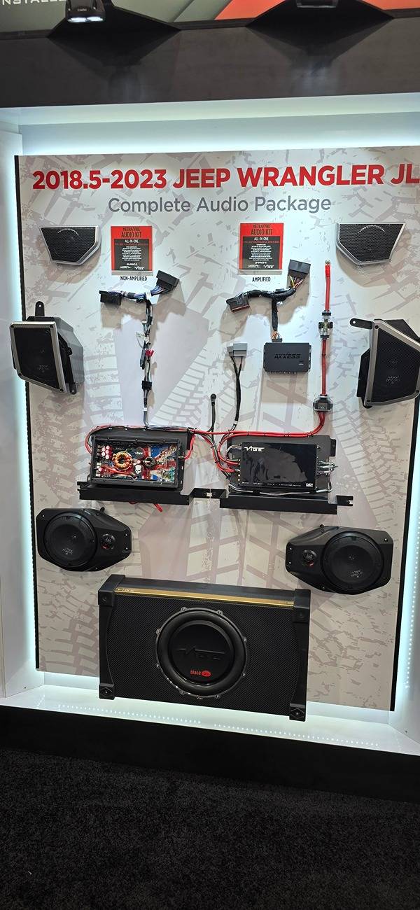

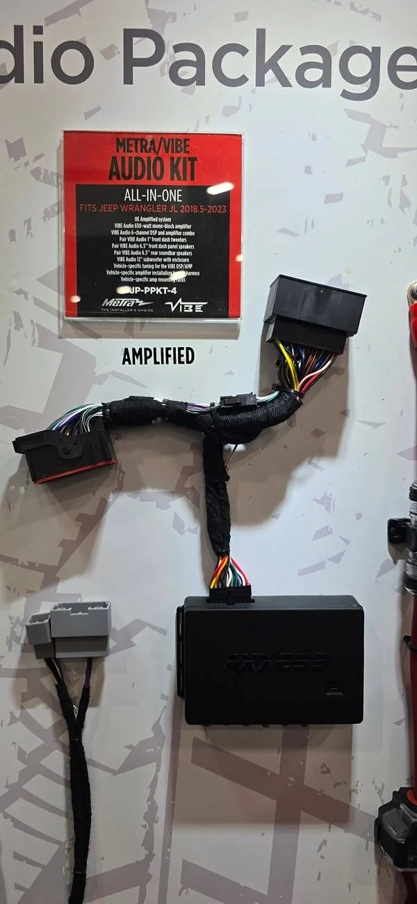

Metra had a couple of great displays at SEMA this year, including a dedicated board for the JL/JK.
Jeep Wrangler JL Adding an Aftermarket Amp(s) 20241107_105813
Jeep Wrangler JL Adding an Aftermarket Amp(s) 20241107_105818
Jeep Wrangler JL Adding an Aftermarket Amp(s) 20241107_105802
